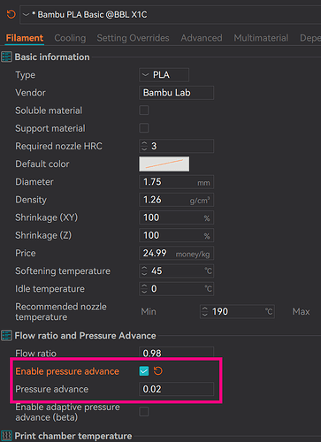

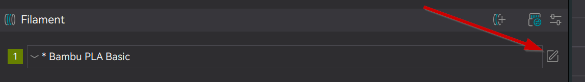

The setting your looking for is in the filament profile.
