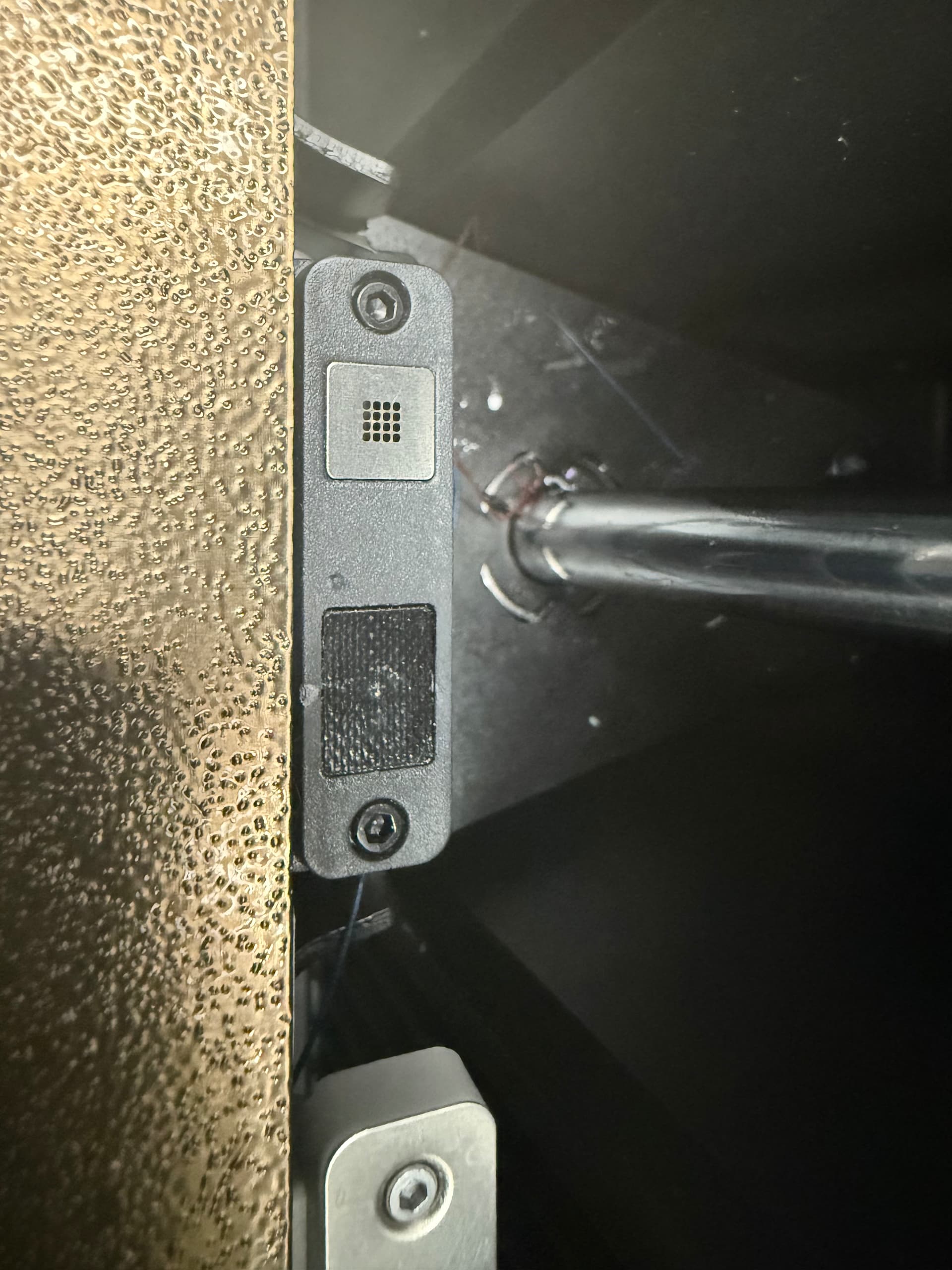

Podje your Nozzle Calibration Sensor area looks like mine, people say it is missing a rubber pad that goes on it. Looks more like a nozzle wipe area than sensors.
I am not at home right now to look, but I can see what you are referring too. I will order a replacement, but struggle to see this being the issue as if the nozzle offset was calibrated wrong I wouldn’t expect to get so far along in the prints. My failures always seem to happen around the same height, so it is as if the issue occurs after a set number of layers.
ok so mine looks correct when I take a proper picture up close
Thank you for the picture I finally get to see what a real one looks like. So I guess it’s just me. I’m waiting for support to respond but I might just pay the $20 to get a new one because it’s gonna take at least 3 days for support to respond. At least that is how long it took when I put in a take for the build plate that came on the H2D being scraped on both sides w/o any machine use. I also noticed that the left aide panel of the machine was outside the frame on the bottom and I popped it back in using a small crowbar.
