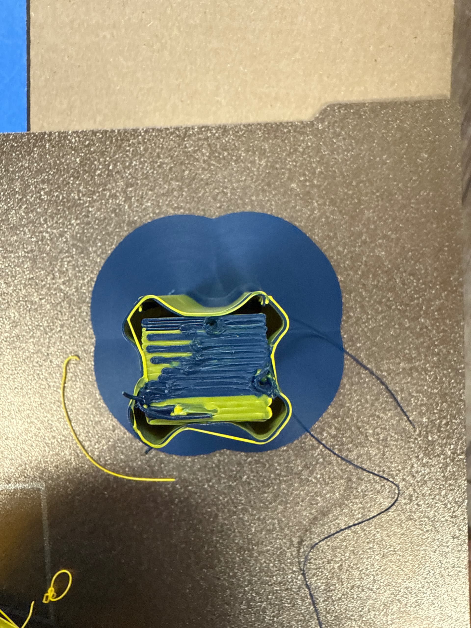

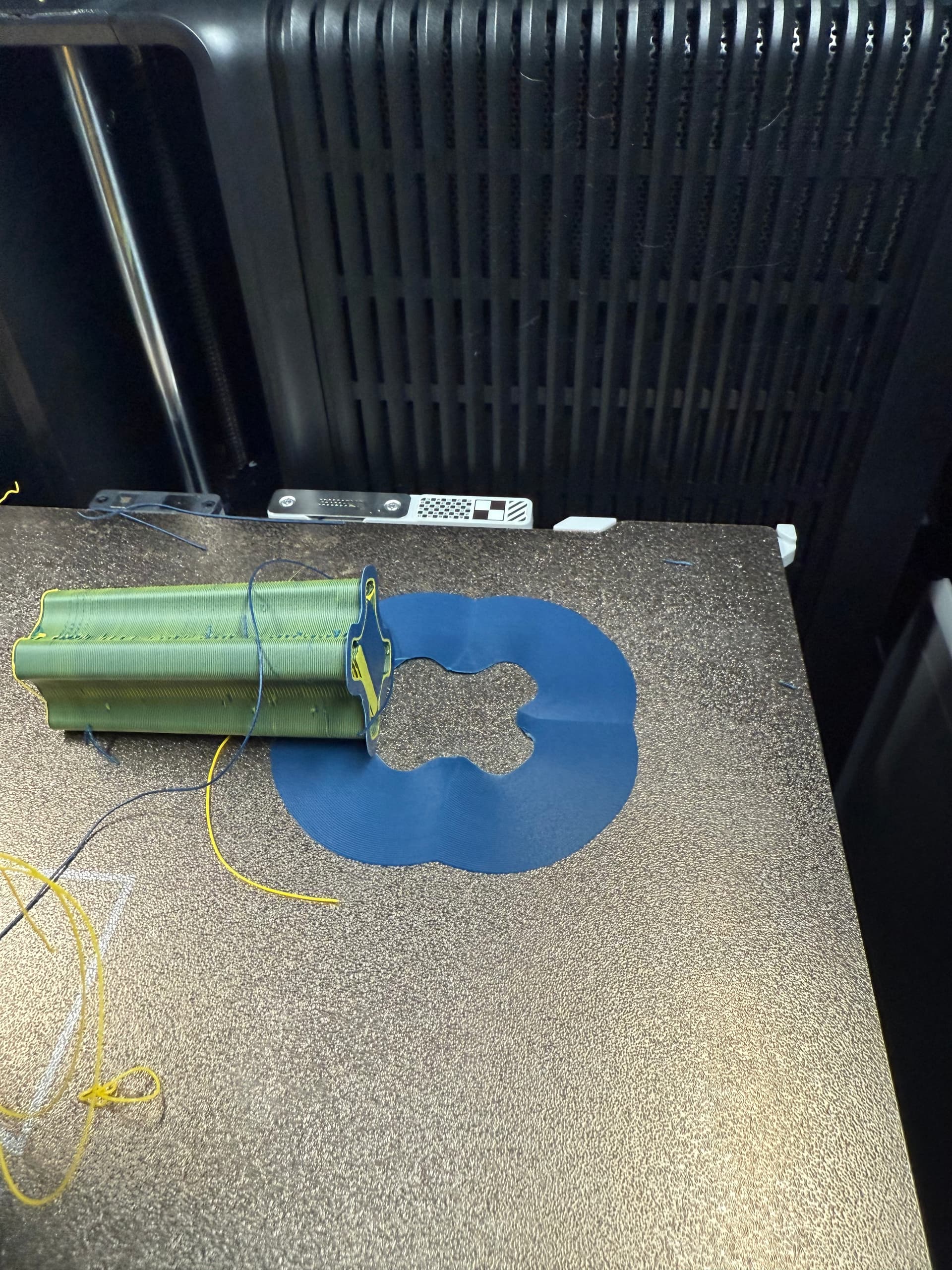

Ok I am starting to have serious issues with my H2D with 1k+ hours printing. My prime tower is being knocked completely over. I am tired of hearing wash your plate, don’t touch your plate - this is not adhesion issues. I even ordered a brand new plate from Bambu and it did it. Look at the pictures, I expanded the brim to 25mm and the tower was ripped right from it. I wish I could get live video to view what is happening, but clearly the print head is hitting the prime tower. I have tried with and without zhop, increased bed temp, added glue. What I really struggle with is I will get a print to work, print again without changing settings and this happens. Looking for any suggestions on what to change next.

Consider relocating the prime tower to the back left, this makes it much closer to the poop chute and the cleaning process.
It should make travel simpler, it would also remove any bed adhesion questions as it isn’t in the same place on the bed when the model (far more fragile sits perfectly.)
I move any prime towers when I need them to the wipe/poop chute location due to travel and previous experience that had towers knocked by the head.
It is important to note, I didn’t do any tests to determine that, just moved the tower and the problem stopped. That is not conclusive, just coincidental.

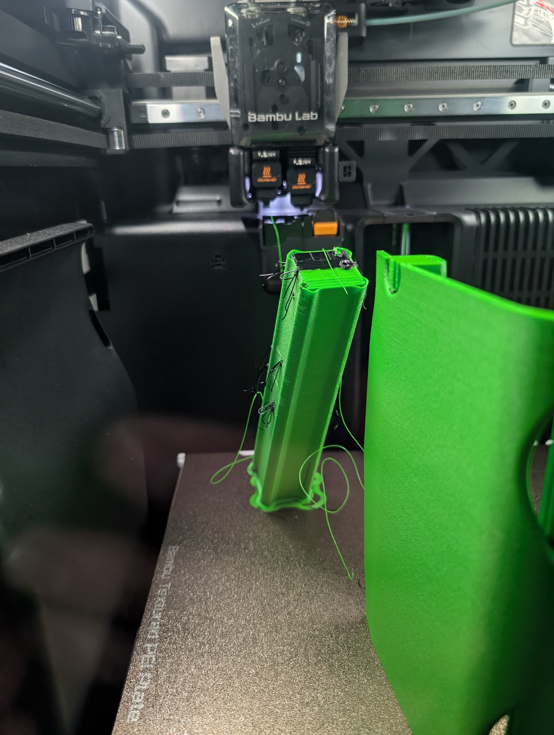

I got very lucky in the below print. Spaghetti detection saved it and paused the print while I was asleep. As I only needed 12 more layers of nozzle swapping, I cracked the door and reached my arm in(yes I realize what the print head would do to my arm if it caught it) and held the prime tower roughly where it needed to be so the print could finish.
[Edit]: It’s obvious from the blob on top of the prime tower the head wacked it and broke it loose, then tried to extrude and caused a blob, then moved and did… WHATEVER it wanted to do.

So here is a previous video I have posted on YouTube with the prime tower on the left, just like @BaIto I ended up holding the prime tower in place for almost 2 hours to finish the print: https://youtu.be/RYlVBr-oHEY

Here is the top of the prime tower if this helps… you can clearly see where the head was pushed down into the tower

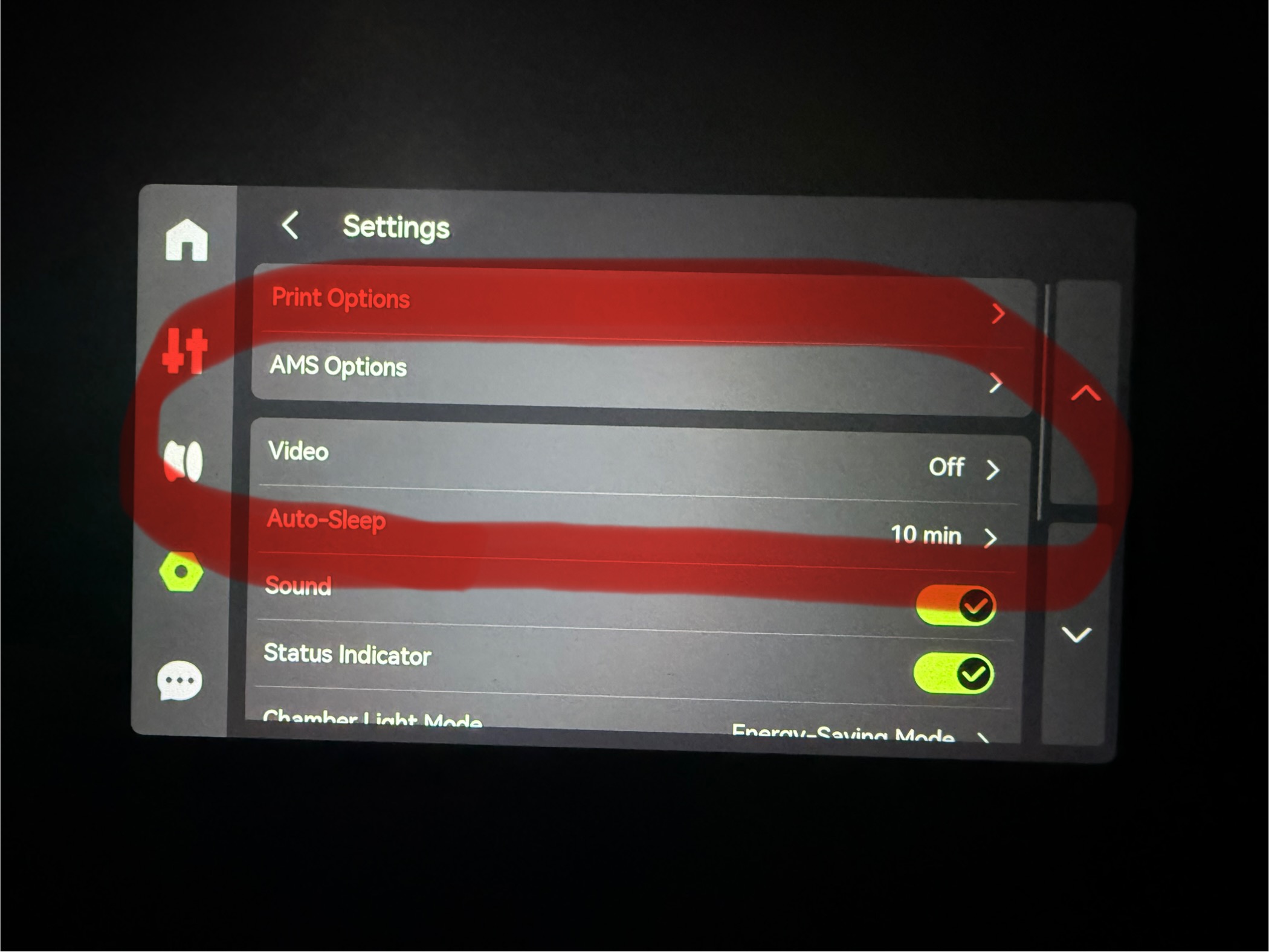

You can, if you have a USB stick in the H2D.
If so, remove it, and inspect the files on it - you will find a large amount of real-time, time-stamped (in the filename) video clips of the entire print duration.
Examine those video clips and you will be able to “catch it in the act”.
ETA: The H2D is always storing those files, they will fill up a large USB stick, so it’s a good idea to delete them periodically so as not to run out of storage on the USB stick.
I had the video function turned off, was only recording the Timelapse. I may have to turn it back on if I can’t find a solution

This has nothing to do with space, in fact I have a 1TB HD connected. Yes by default the H2D will record full video’s of the print, however I saw this as unnecessary so I turned the function off as seen in this picture. However I am now rethinking this as I need to try and figure out what is happening and the print head is colliding with the prime tower.
