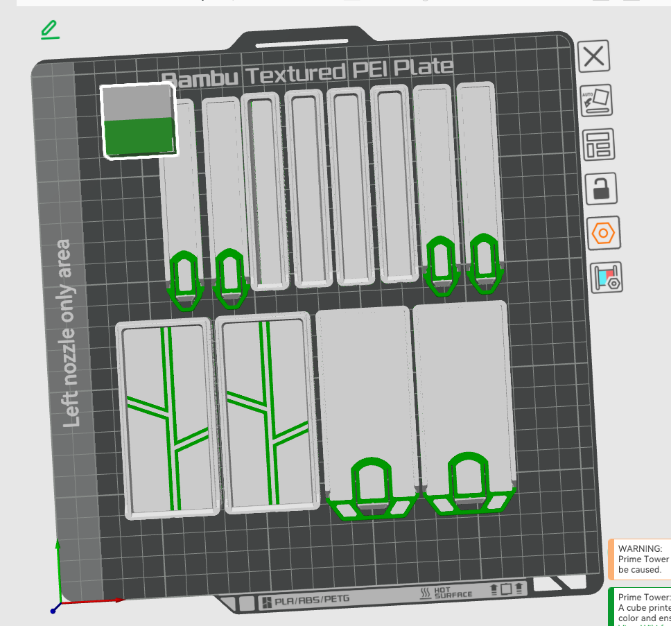

Does anyone know if there is a way to place the prime tower block on the edge of the build plate? Bambu Studio seems to have a 15 mm keep out zone around the entire edge of the plate. Maybe I’m missing a setting? I’m trying to make a square sign and maximize the use of the build plate.

Using Bambu Studio 2.03 I did following:
In the “prepare” tab position the prime tower anywhere; the prime tower shows the filament colors.
Click the “preview” tab for slicing the object, wait until ready.
Click “prepare” tab again and you will see the prime tower is grayed; now you can move the prime tower to the edge of the build plate and slice again.
(Do not move the object in the prepare tab again, the prime tower colors re-appear and moves away from the edge.)
Sounds like a silly workaround, but it worked for me.

The picture below shows the limit of where the prime tower can be moved. The print uses only the left nozzle which makes it even more silly.

adding this in case someone hasn’t realized it yet - you can gain that edge back after slicing and then going back to Prepare once BS knows it’s actual size, the buffer area is because it’s size hasn’t been calculated yet in the prepare tab, once its sliced it ‘unlocks’ the edges, here’s how:
  1. Click Slice Plate (or Preview tab) and wait for slice (you have to wait for slicing to complete for the actual models on the plate)
  2. Click Prepare -
  3. The prime tower is now a more accurate size and movable to the extreme edges of the build plate, DO NOT move other models, moving other models may require starting over.
  4. Click Slice Plate (or Preview tab) again.
  5. Rejoice
