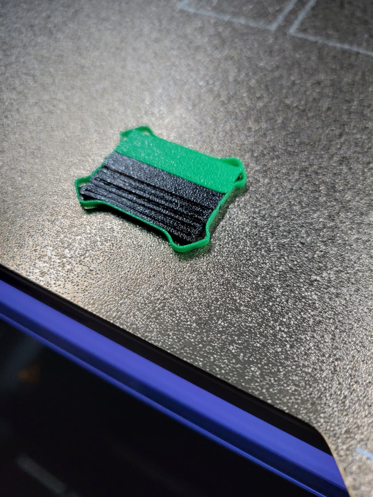

Just did an ABS-GF print with HIPS (support for ABS). Here is what the prime tower looked like, very thick border on the bottom layer and both materials separate from each other all the way up, looks good to me.
Looks good,
I guess prints will generally have a primary material which is in pretty much every layer so can form the outside scaffold structure.
With the second material then incased inside.
