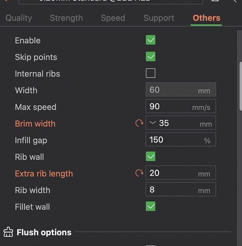

Ok, about ~250 hours into my H2D at this point, and I have a decently big problem.
After around 900-1000 layers of printing, my prime tower will get knocked over
For a while, this was a problem on my models as well (things like supports being knocked over), but disabling “reduce infill retraction” solved my problem.
Now I am still getting my prime tower problem, which tends to cascade into bad printing quality since im dragging material over to my model and its randomly sticking to it.
Any idea how to solve this? My current “solution” is to buy a glacier plate and hope that with more brim the prime tower will stay even if there is nozzle collision, but I would ideally like to not have the collision at all in the first place.
I’ve attached the disaster that is my current print.

You can also change the size of the prime tower and the size of its brim. It will get more stable if you make it bigger (and uses more filament) and/or increase the brim (very minor increase in filament use).

Another thing you can try if you haven’t already is to set a manual value for the prime tower brim width. Instead of leaving it on ‘Auto’. Try setting it to 10 mm or more, depending on your filament type and the size of the prime tower.
Some filaments I slow the prime tower speed down.

Don’t have a H2D, but you can influence your prime towers location and footprint width. (Process → Multimaterial) A big tall boi like that might benefit from a wider stance.
My mind immediately goes to prusa towers, which are more pyramid in nature. Maybe something like that is needed now that bambus are able to print taller.
