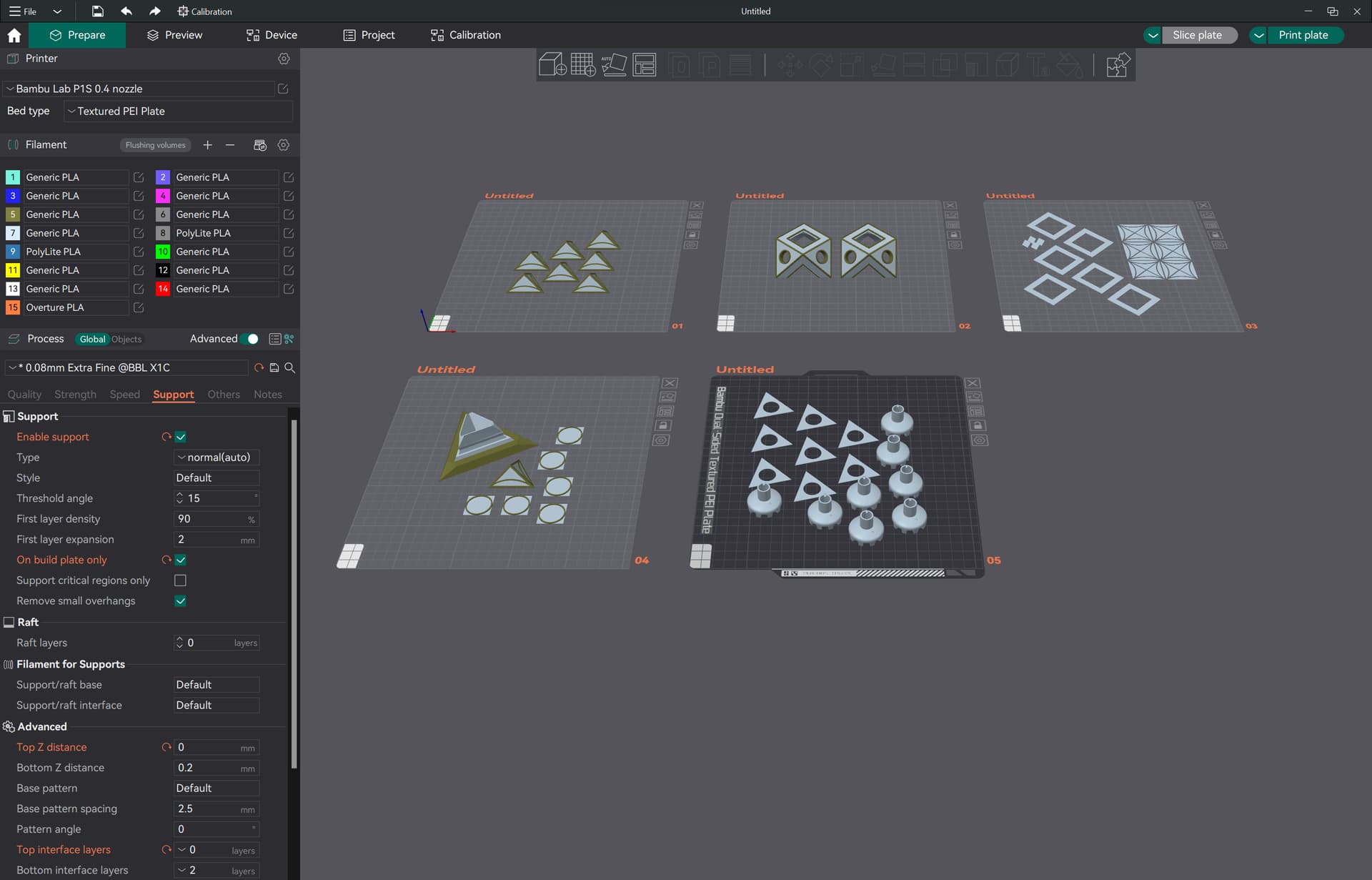

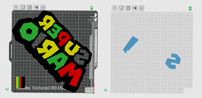

I would print each colour seperately and then glue the parts together. This is faster and reduces the waste. For assembly I would print a single letter and see if it fits. If necessary scale the letter to 99%.
Manually changing a filament spool during print at each of the first four layers is too complicated for me.
Slice the files after you separate the colors to their respective plates (just add more plates) if you have an AMS do not do manual changes, its not worth the headache unless the filament can’t be used in it like if you are using Carbon Fiber embedded or TPU etc. Also you can change and tune the purge volumes to massively minimize waste, I’m down to less than a 1/8th of a cup for a 32 hr print, the fallacy that you will be wasteful isn’t true anymore

You can rescale the letters so they fit tightly.
Just curious if you figured out a solution? My son is learning and he wants to print this. Same issues. We tried printing everything individually but with poor results. The letters have very slight gaps to glue in. Extremely small resizing is guesswork and a huge headache. We do have an AMS and I’m wondering if I can figure out how manually change the 4th and 5th colors in a single AMS slot between 2 colors when it needs them.
Plus the letters are 4 layers thick. I think I’m going to reduce them to maybe 2 layers for better light. Thanks much!

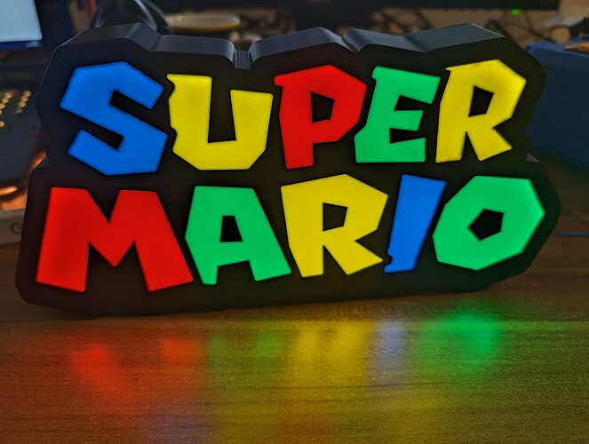

Hello RRack,
Unfortunately not quite what I wanted. I printed the blue elements slightly larger and then used a soldering iron to fuse them to the rest of the model piece by piece. In future I will probably get a second AMS system as I have not found any other way of doing it.
Here is a picture of what it looked like afterwards. It is slightly visible, but the recipient was very pleased and didn’t find it disturbing.
If you come across another possibility, I would be very happy to hear about it!
