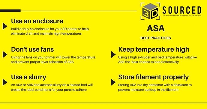

Did you follow these tips? I’ll post them for you:
Some people also recommend “slurry/juice”, but I’ve never tried it myself. Better try that on an old printer plate first. Even though it says “ABS” in this articles, it’s also available/doable for ASA:
https://all3dp.com/2/abs-glue-slurry-juice-tutorial/

Thanks for the replies all. I was following the low end of the specs from the manufacturer. What I’m printing is the base to a birdhouse at the moment, so its a big square. The edges lifted and it got a weird line in a few spots. Nothing that ruins the print, its just for my house. But its enough that it’s noticeable. I’ve tried all the suggestions listed in that 3D Sourced chart except the slurry. Not sure I want to try it on that plate. And yes I am using the textured PEI plate. I have that plate and the engineering plate. Would I be better off going to a cool plate? I’m printing another part now on a higher print bed temp, 95, and we will see if it peels. I’ve added a brim to it as well to see if that helps any.

Do not attempt to use a ASA slurry unless you are willing to sacrifice the plate. Acetone will damage the surface.
