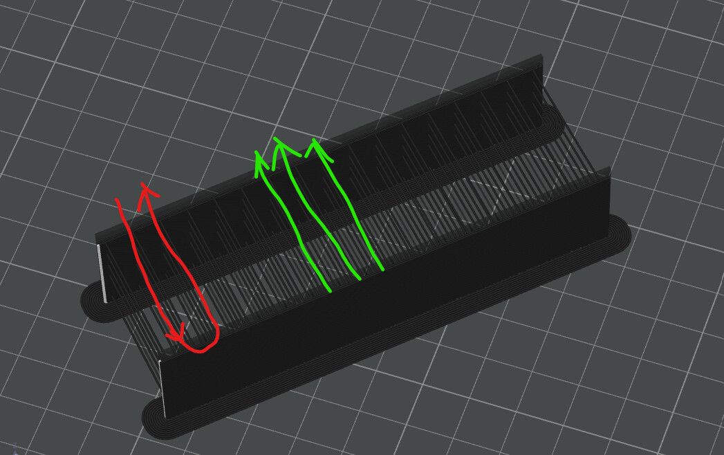

I have been working for a while to get 3D printed hair with the density and thickness I need for a project but I’m having a problem making the direction of bridging consistent.
When the printer bridges single filaments, the side it starts on is thicker than the one it finished on, but currently in Bambu Studio all my bridges alternate directions.
I want the green action above but right now all that happens is the red. This causes half of the hairs to be thick on one side and half of them to be really thin which results in really bad looking and functioning hair.
Is there a setting I can change to make the green behavior happen? I’ve tried fiddling with bridge direction, thin walls, and the orientation of the model but nothing I do seems to change the slicing behavior.
If I can’t do it in Bambu Studio is there anything else I can use to do this? I have an X1C with AMS 2.

This is only a thought. Might want to try extending the hairs beyond the wall. Maybe even leave a layer gap above the walls so the hairs act like bridges. I’m probably misunderstanding the need and have no idea if it will work, but it seems simple enough to give it a shot.
I don’t know how to attach an image, but it would look something like this:
____________ <----hairs (with overhang)
<----layer gap
| | <— walls
