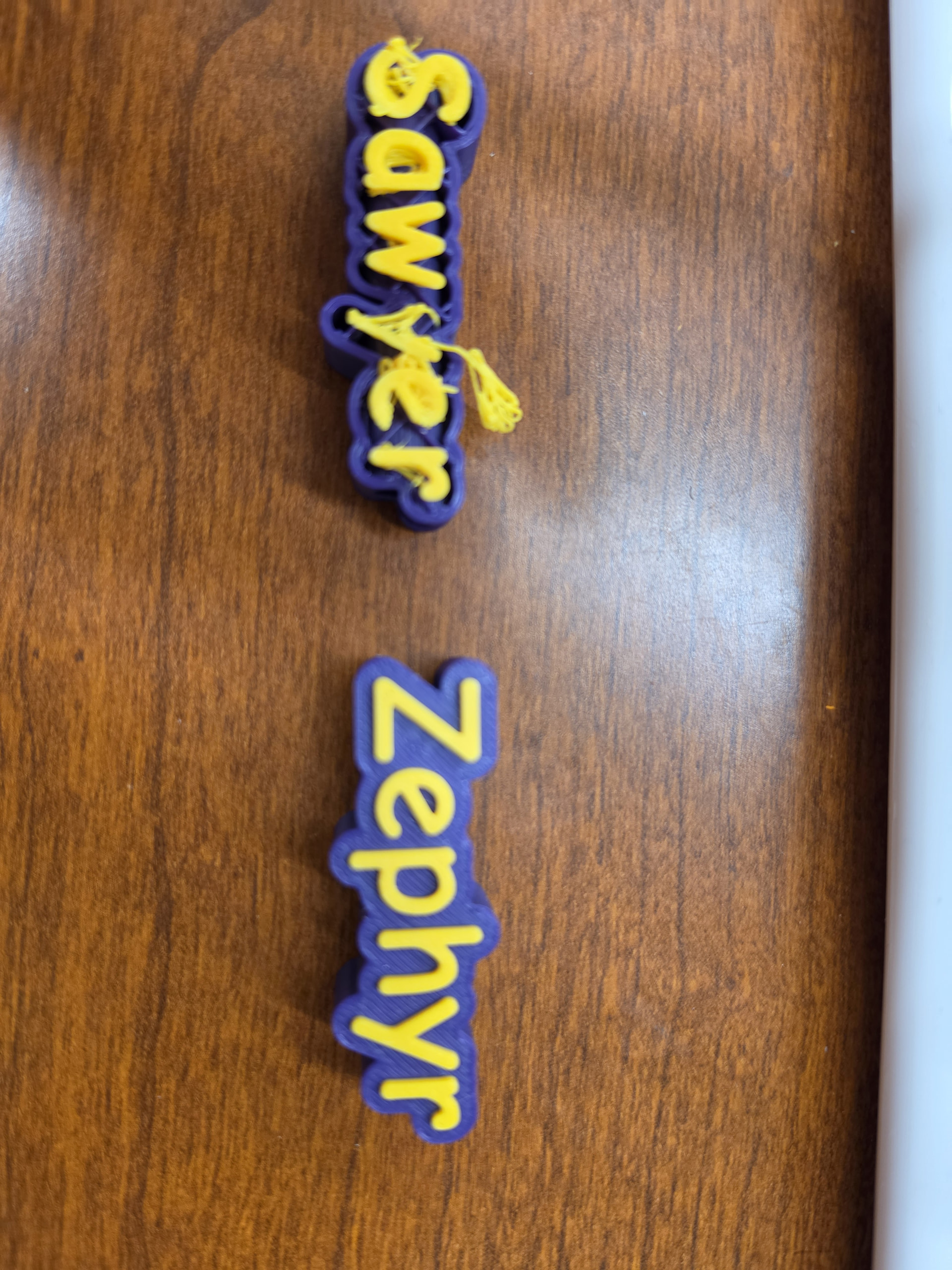

After returning to school from summer break and installing the latest update, 2.8.2.61, I am experiencing a very strange problem. I have downloaded a file from MakerWorld, the first time I print the file, it is perfect. Any attempts after that it fails. I have good bed adhesion, the problem is about half way through the print, the extruder will go ‘home’ extrude a layer or 2 of filiment, then return to the print. Or it just thinks it is finished printing and stops mid print. This has happened on 2 or 3 different files. Downloading the file again does not seem to fix the problem
I am using a P1S that we purchased in March 2026
Normally this kind of behaviour points to an SD card issue. It is either full or starting to fail. Use the printer display to format the card and see if that clears up the issue.
I formatted the SD card and tried the print again. It stopped working even sooner.

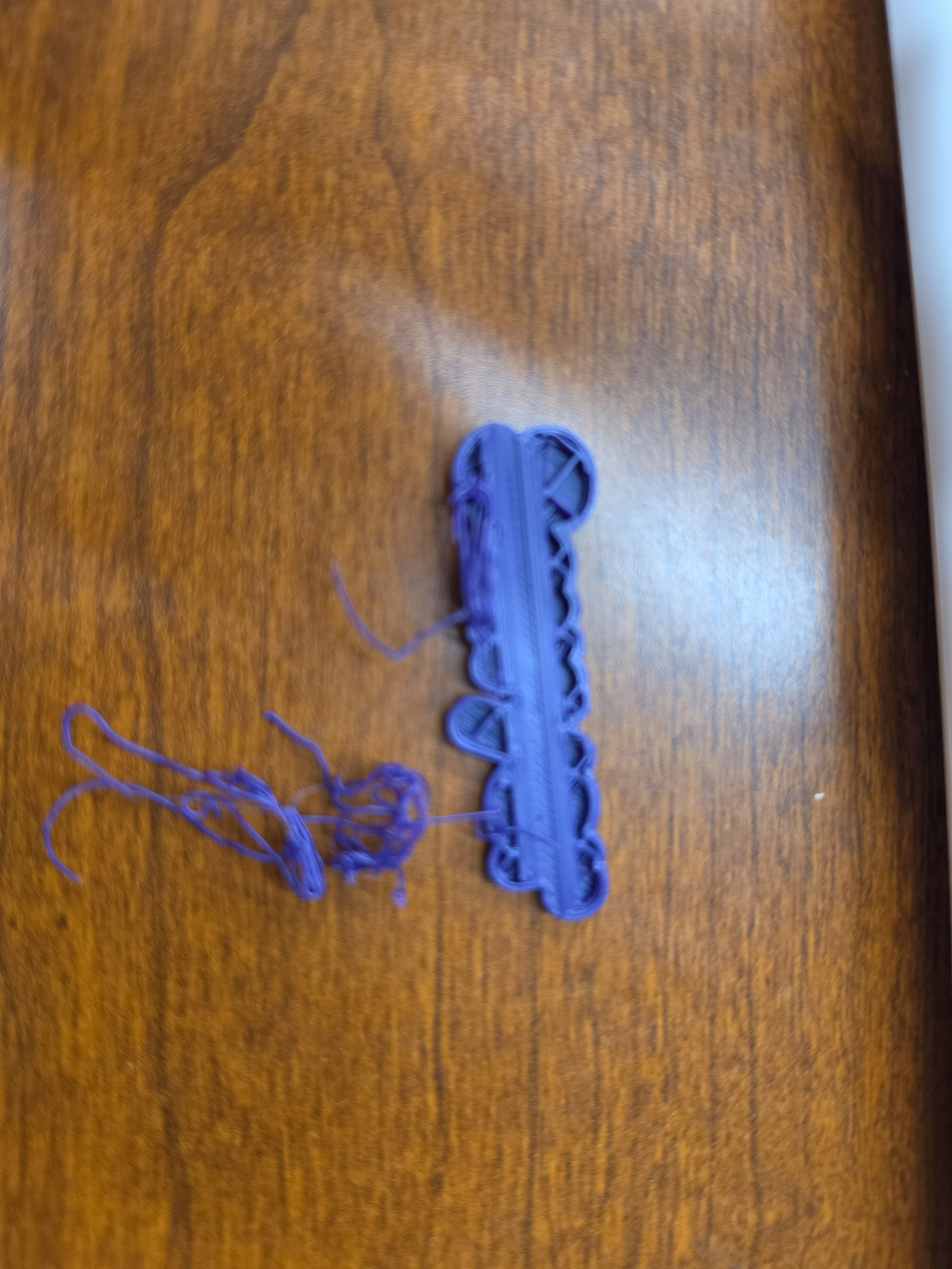

In the pictures, Zephyr was thei first print, perfect, Sawyer was the second batch, not so good. The purple thing is after formating the SD card. It messed up after about 10 layers.

From the explanation and image it appears the nozzle may be hitting a ridge in the print , meaning it will home first then continue (flush), the ridge itself prevents fluid motion for the toolhead / nozzle, instead of using force to barge through and cause damage, the printer will reset itself at the flush / purge position and continue
(nozzle meets iremovable object)
I tried a different SC card and created the file from scratch. It still won’t print correctly.
Thanks for the suggestion. I do not see anything in the print that it is hitting on.

I found it can be knocked off the print , if there is enough movement, when it doesnt get removed the printer stops the print after three / four attempts to continue, which will leave the toolhead parked in the stopped position .
