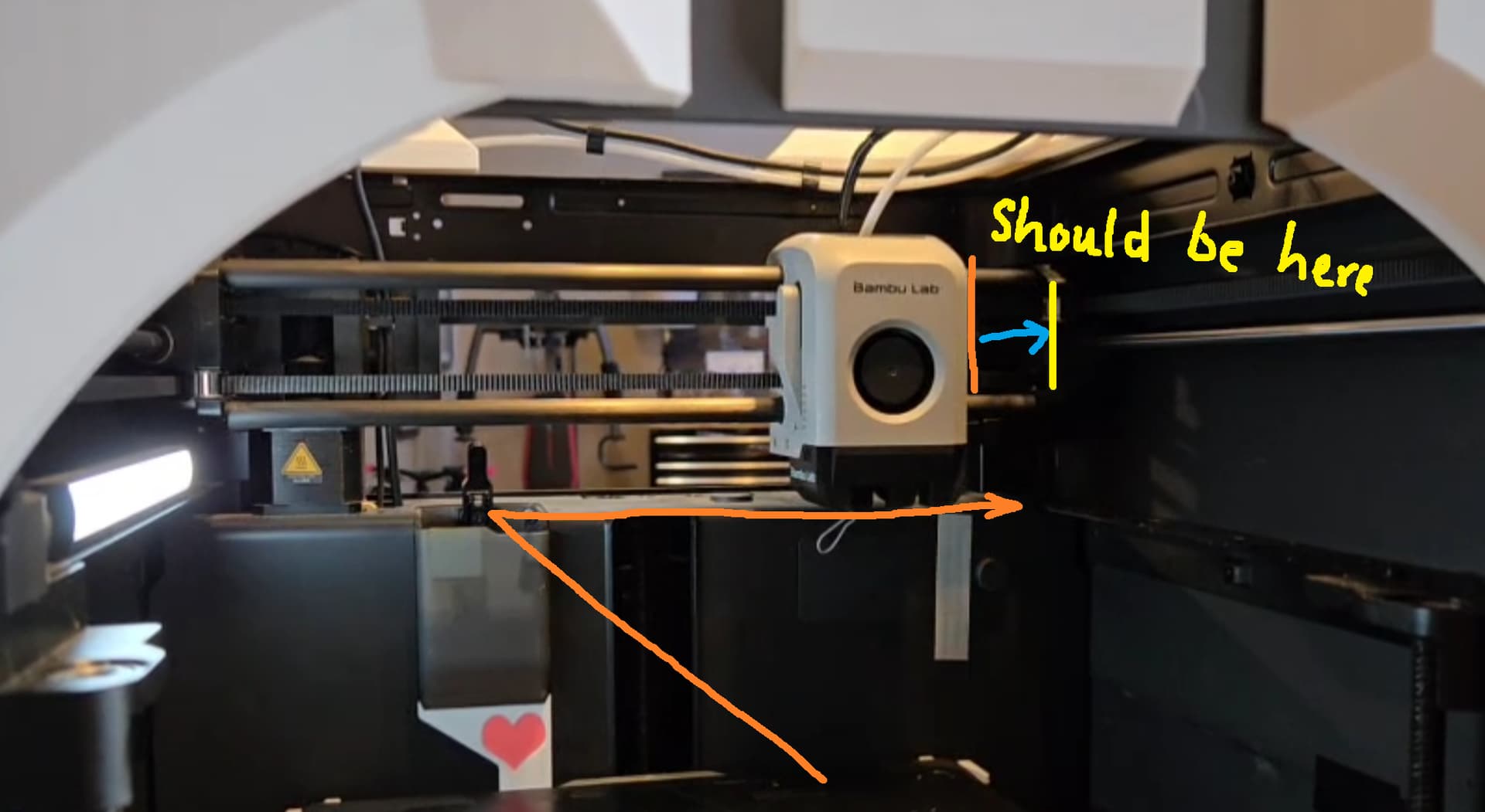

Print head off center. or something
I hope I can describe this right. If not, I uploaded a video and pic to oneDrive.
I couple of days ago my P1P started doing a weird series of movements when starting a print. Looking from front, it moves to back right corner, then front right, then diagonal back to the poop chute. When it reaches back there is a loud clunk like it’s hitting the stops hard. It’s not the flapper in the poop chute. It will then purge filament, then repeats the same movements. I also noticed that when it tries to clean nozzle tip it does it to the right of the worn spot on the build plate. The print never starts. The print head never ends up at front left anymore.

I see that it failed to find the limit of X axis when it homed the tool head.
Maybe there is something that restrics tool head’s movement, like seized pulley(s), loose GT2 gear (at the XY motor shaft).
My theory is, since the movement is too short before it hit the “virtual endstop switch”, it thinks there is something restrict the tool head movement so it considers homing fail, and thus re-issue homing command again and again, in an infinite loop.
