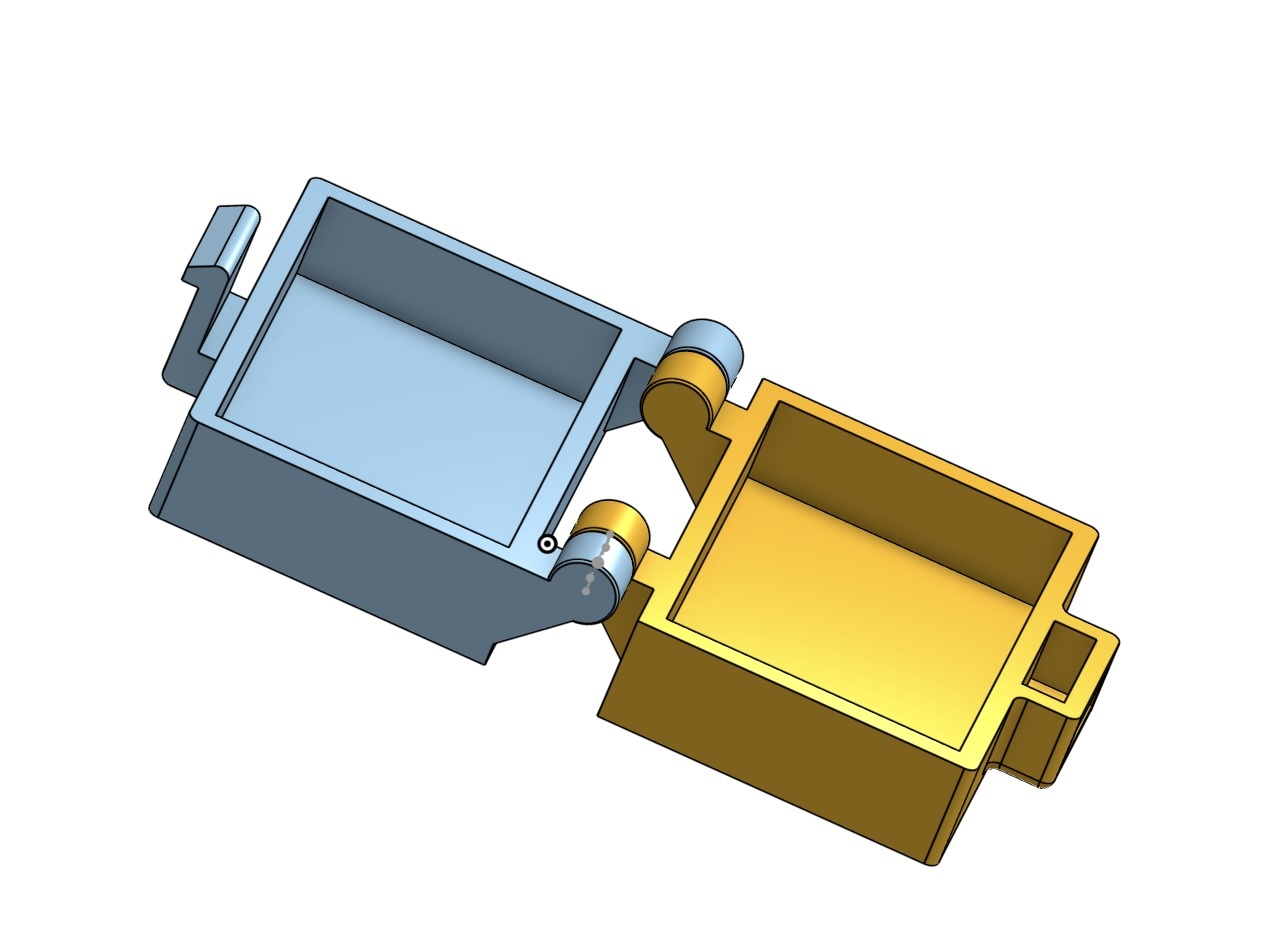

Hi,

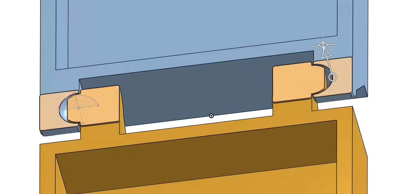

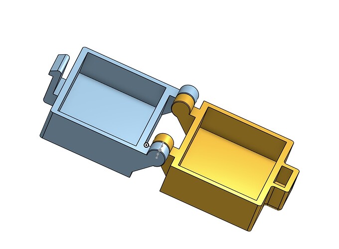

How can I print in place 2 parts in 2 colours on the X1C? As it is print in place with hinges that interlock, I cannot print both parts separately.
Kind regards
Proape

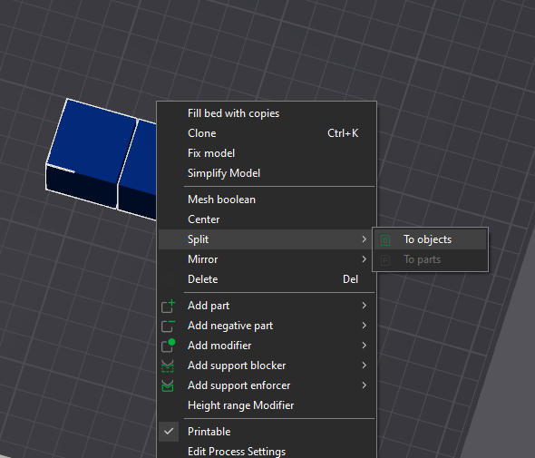

I don’t know how to set each side of the box to a different colour. Both are imported as one piece.

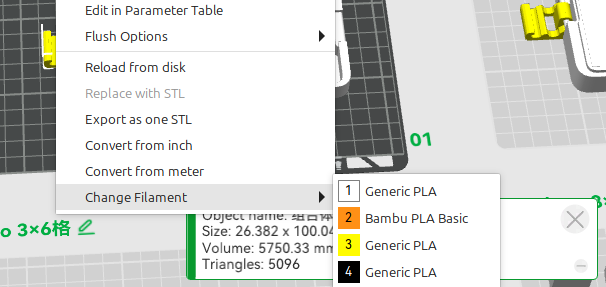

Right click the model, Split, To objects
That or use the paint tool.

It’s actually quite easy to separate the two parts. Thank you.
But I don’t understand what you mean by ā€˜That or’. That’ should mean what you see in the picture, but I can’t find a way to colour it, only to split it.
It’s very easy with the paint tool.

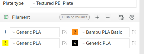

Once you have split them into two objects, you select/highlight the object you want to set the colour for and then either press (on your keyboard) the number that represents the AMS slot you want to be used… i.e I would press 2 for the orange …
or use the ā€œChange filament optionā€

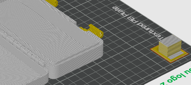

However, I have to think twice if I want to print something like this in 2 colours, no problem for the box halves themselves, but for the tiny hinges I have to change the filament for each layer, which means a lot of waste and time delay. Do I see that correctly?
Exactly. Since this is a print in place hinge, the only way to have two colours is to change the filament every other layer… practical if you have an AMS, not so much if doing it manually. And either way, you will have filament purges/prime tower to accommodate the changes on every layer.

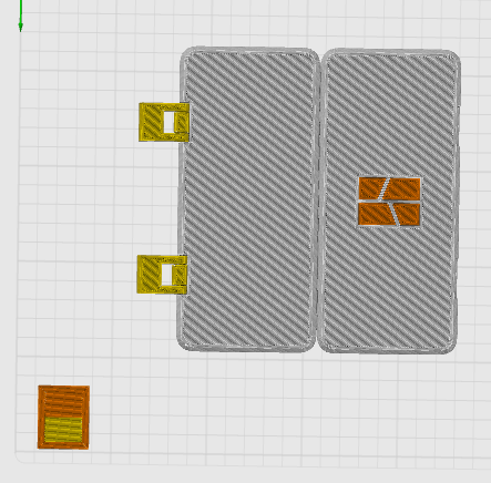

i.e. for this case I’ll be printing tomorrow with three colours, there will be some orange, white and yellow changes early on
but once the orange is finished with, the prime tower is just alternating white and yellow

It’s printing now, but Bambu Studio tells you everything :wink: There’s going to be about 41g of ā€œwasteā€ (near 1/3rd of the total filament used for this print) due to purging and prime tower and 80 filament changes (thank you, AMS lite!) and will be a roughly 6-hour print job. If I had only done two colours instead of 3, it would have been 5h50m, and 6 less colour changes (as the logo only goes for a couple of layers). So be it for this print.
Just to put that into perspective, it would have been 3h13m if it was a single colour print.
