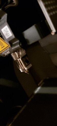

Unfortunately the automatic calibration doesn’t work somehow. Unfortunately, as of today, the printer also regularly clogs up. I have now unclogged it again (PLA-CF black). If I now control the extruder manually and let some filament escape, you can see that the filament doesn’t run straight down but instead “pulls up” directly on the sides of the tip. How can I prevent this or is this normal?
The printer is less than a week old. That can’t actually be normal. The first 40 layers worked without any problems and after that no more filament comes out. The automatic unloading of the filament also fails.
When the printer wants to add new filament you will see the big yellow gear stall. Is the filament perhaps too moist and should be dried?
That both looks and sounds like first a partial and then a full nozzle clog. You’ll probably want to try the manual cold pull (point 3 in the wiki on nozzle clog). The automatic version never worked for me.

I cleaned the nozzle with the point 3 and the filament runs out as expected.
Because the prints does not show good i started the calibration of the flow rate. But every print from Step 1 looks totally like trash. I searched on Google for this error and they say the nozzle is clog.
Did you have any other ideas why the calibration print looks like trash?
Quick thing to check is to take the sock off and see if the thermal grease is still greasy. If it’s chalky, then that’s been dried and baked and will need replacing. It’s rare, but worth a quick peek.

You mean the white paste right? When the print head is cold, it is solid as a rock. Is that right or wrong?
Should not be solid. Should be annoyingly lotion-clingly and get all over your fingers and in strange orifices in your body. Bambu’s video shows what it should look like when you pulled that sock off.

Ok, but it’s a bit strange that the area around the nozzle is completely dry, isn’t it? I haven’t had any error messages about this yet.
