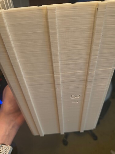

I also wonder after looking at my pictures if I do have something off with my z-rod because at least in the first picture it seems like there is a pattern of wobbling (but the second picture doesn’t show this same pattern, yet the same model printed, just that both sides were at different 45 degree orientations).
Well z issues will cause the banding. I’m more concerned with the stop. I’m thinking either the SD or timelapse.
As for the Z, take a good look at it, check for lose screws etc. Adjust the tension etc

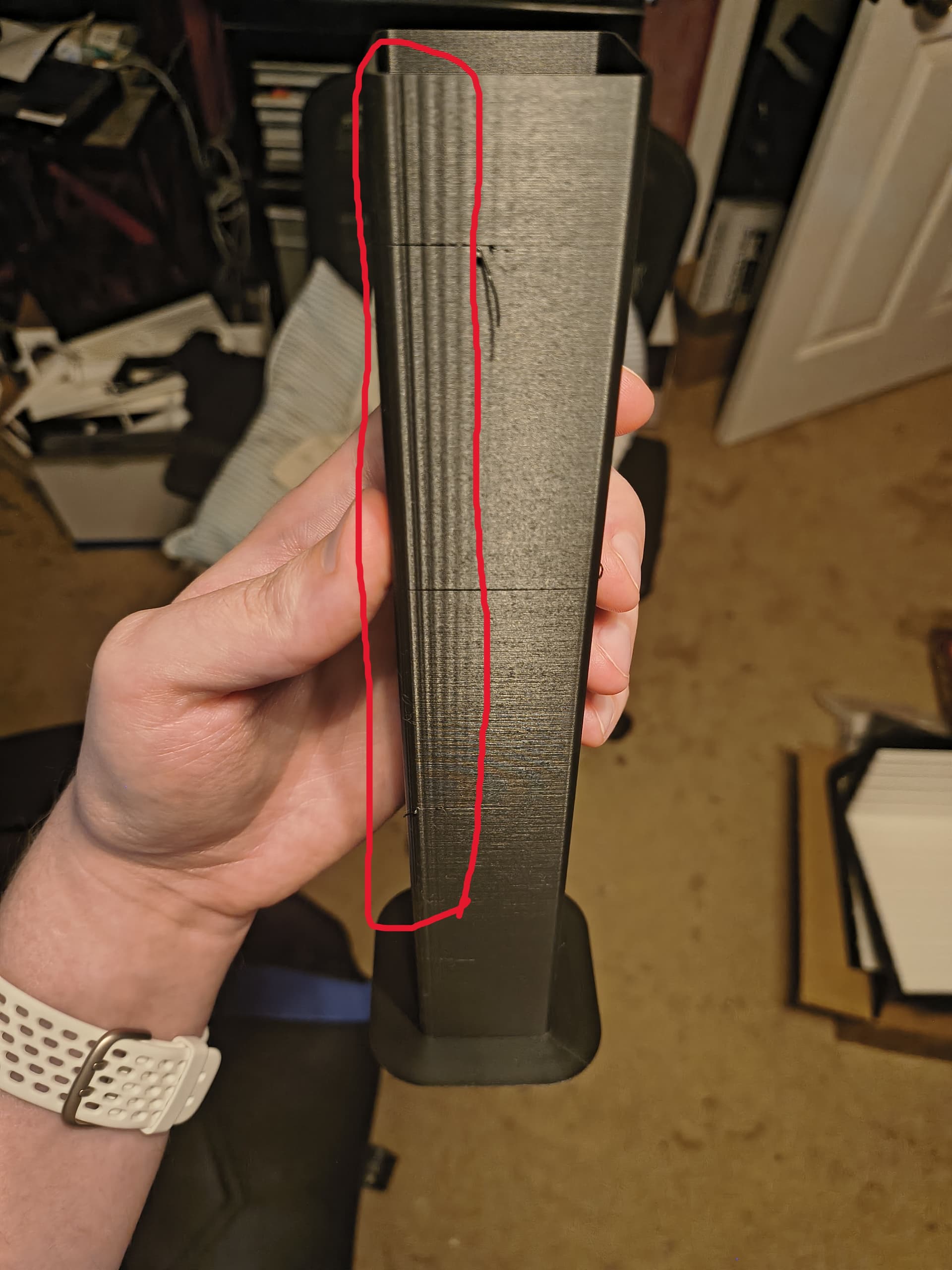

Okay so far so good with my test print after i slowed down the acceleration to a cap of 2.5k for every layer (see pictures, the little extra lines coming off giving it defects in the places nozzle clumping detection occured can be fixed by adding a tower [finish reading post to see why]). I did not switch OFF for the “Reduce Infill Retraction” setting on this print, so this is something to consider next time.

PS, it is strange how 1 of the 4 sides of the test square is giving me like a ghosting effect with a vertical line, I do believe this is due to the seam because there is 1 vertical seam in this test print going up and down 1 corner (the side I am referring about is in the first picture uploaded). I am uploading the 3mp file of the test print I am posting pictures of as well. (i did post 2 pictures of the same side (the first two pictures), hence being 5 pictures for a 4 sided square, because the lighting gave off a pattern effect that really isnt there)
EDIT: strange the first two pictures dont have the same effect that it shows on my phone, oh well, theres an extra picture of that side with the vertical ghosting effect happening. I am hopeful the problem is solved, but will confirm when i print my actual STL’s I am wanting to print besides the testing high square which is uploaded in this post.

Overall looks pretty good.
The effect of the light from pic#1+2 could be a pressure advance slightly out of true but if you dont see it IRL it might not be worth worrying about.

I do see the vertical line ghosting from picture 1+2, but not sure if that is what you was referring about (see circled part in picture). but everything else looks great (minus the layers that the nozzle clumping detection occured, but we found the fix according to the wiki already so im not concerned with that, rather I am turning “OFF” reduced infill retraction, because my prints already take alot of filament per piece, and the tower is adding about 50grams extra per piece (and i have MANY pieces i am building, for a storage case for minatures of a tabletop game called warhammer 40k)

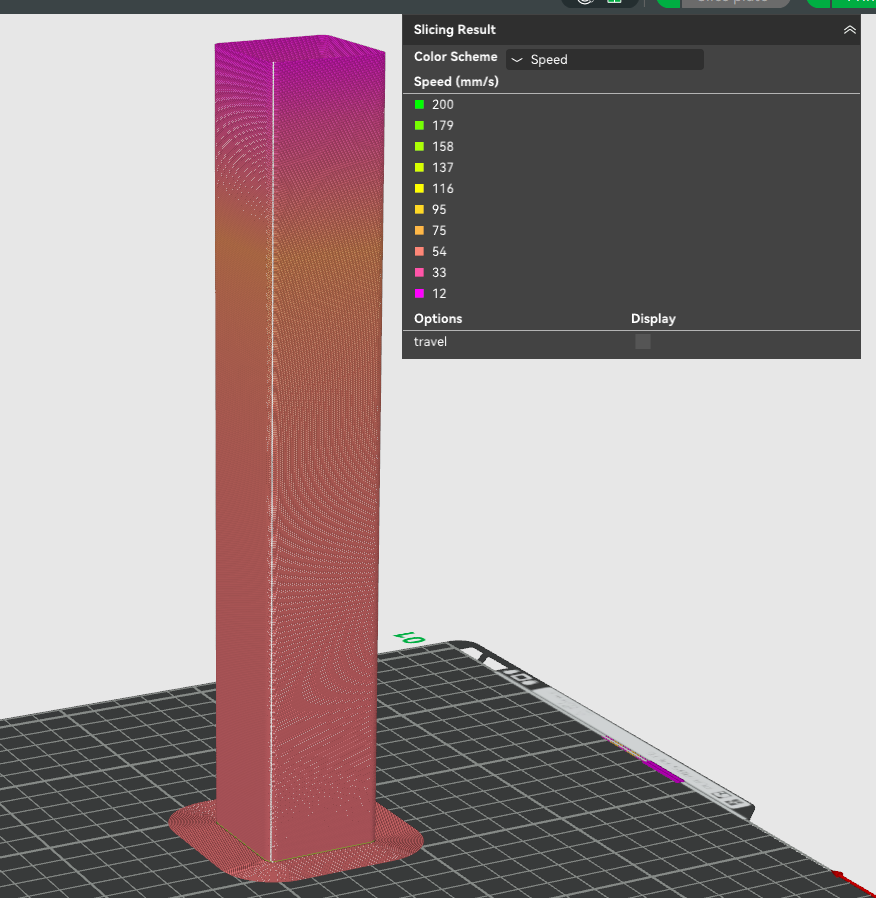

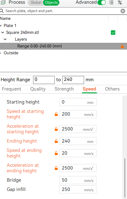

I just noticed the speed of the test print, was slow from bottom to top (besides layer 1-3), yet the speed i set was wrong (i accidently set the parameters to ending height 25mm, instead of speed at ending height 25mm/s).
but even after taking off the speed parameters, the print speed is very slow on this test model. I dont understand why?
Square 240mm(2).3mf (745.8 KB)
again, yes i messed up on the speed parameters i set, but even after fixing them, the higher speed of 200ms doesn’t want to be 200ms. Just wondering why this is happening? (edit: look at edit number 3)

EDITx3: look at this fixed version of the square test STL, it starts most of the speed in about 54mm/s (after slicing look at the speed drop down in slicing results), yet i have it set to start the print at 200mm/s. then it increases to a orange/yellow 95mm/s around layer 940, then it goes back down to the 54mm/s speed around layer 1000, then it finishes up to the speed parameter i set which was to make the finishing speed at 240mm to be 20mm/s (dark pink).
Square 240mm - fixed speed parameters but speed summary looks strange.3mf (745.8 KB)
