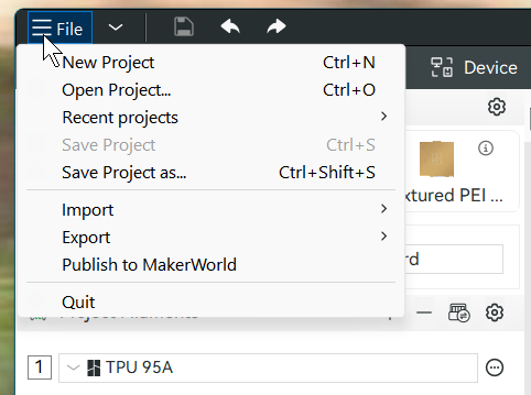

@Hasmar04 where is the “file” button (sry im new to this all)
Windows:
Mac and Linux should be similar.
