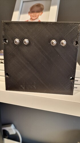

I’ve had my p1s a couple months and been using sunlu pla very successfully. I calibrated the flow dynamics and the flow ratio using the bambu studio built in tools and also by printing a calibration cube and measuring wall thickness and measuring and adjusting accordingly.
I’ve tweaked my xy hole compensation and couple other things and got it printing very dimensionally accutaly. I can print a 9.95mm hole and a 10mm drill bit (actually 9.95mm) fits perfectly. I can print parts in place with a tolerance of 0.1mm and they remain seperate. So as I said pretty chuffed so far.

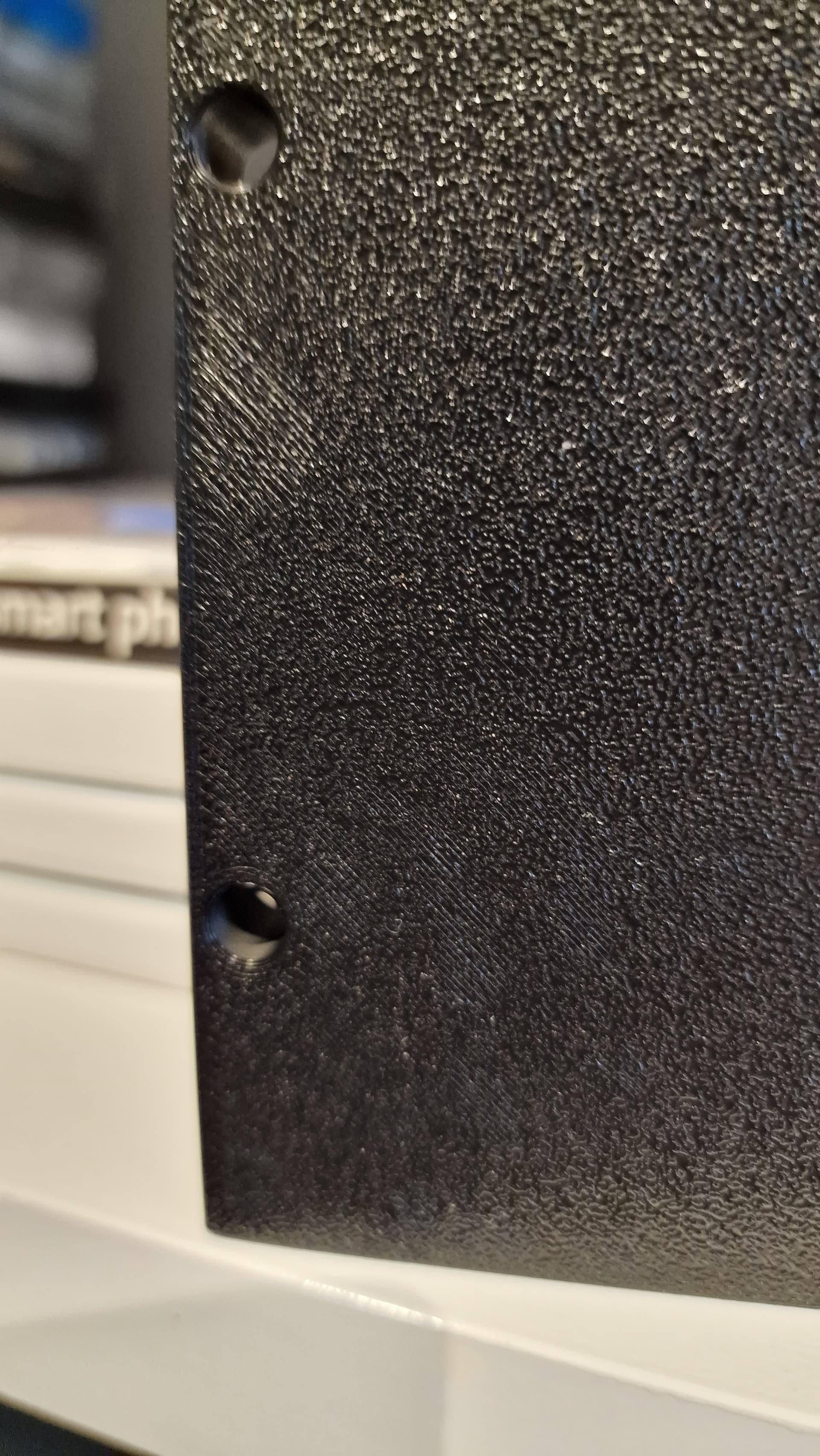

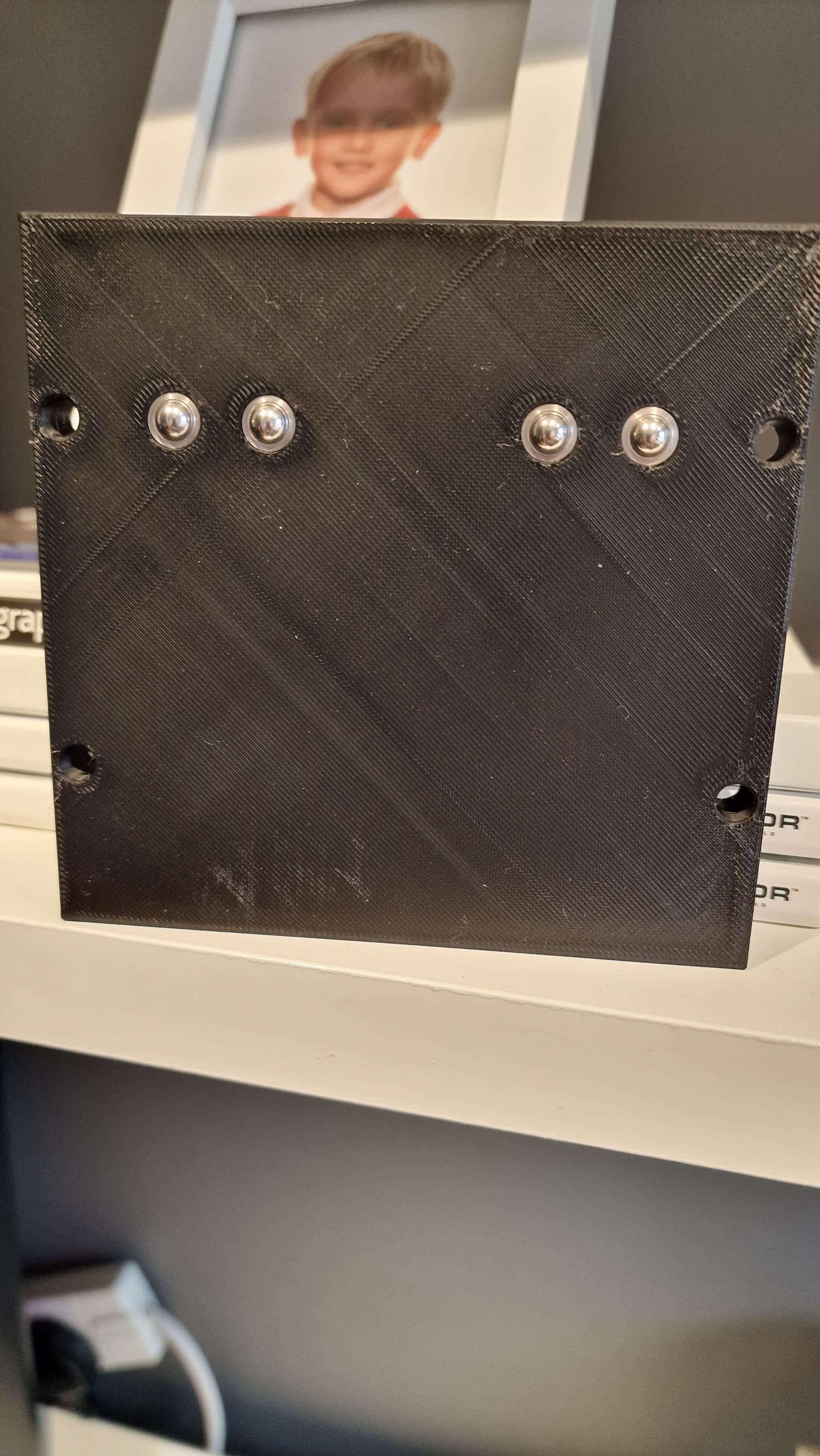

Picture shows surface quality I was getting.

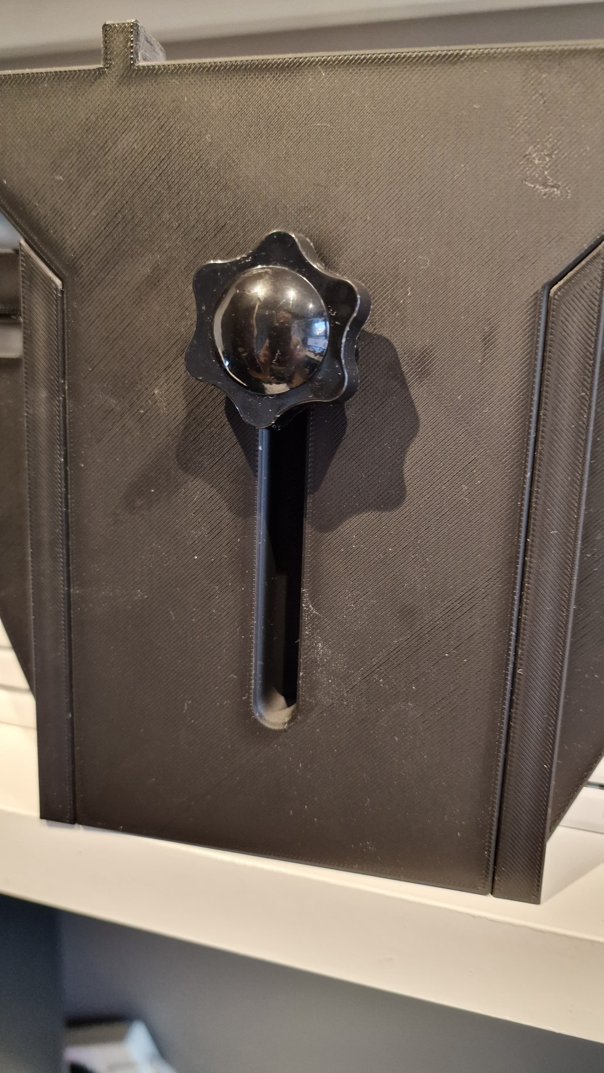

Im on my second roll of sunlu pla and notice the top surface quality on a print looked a bit under extruded

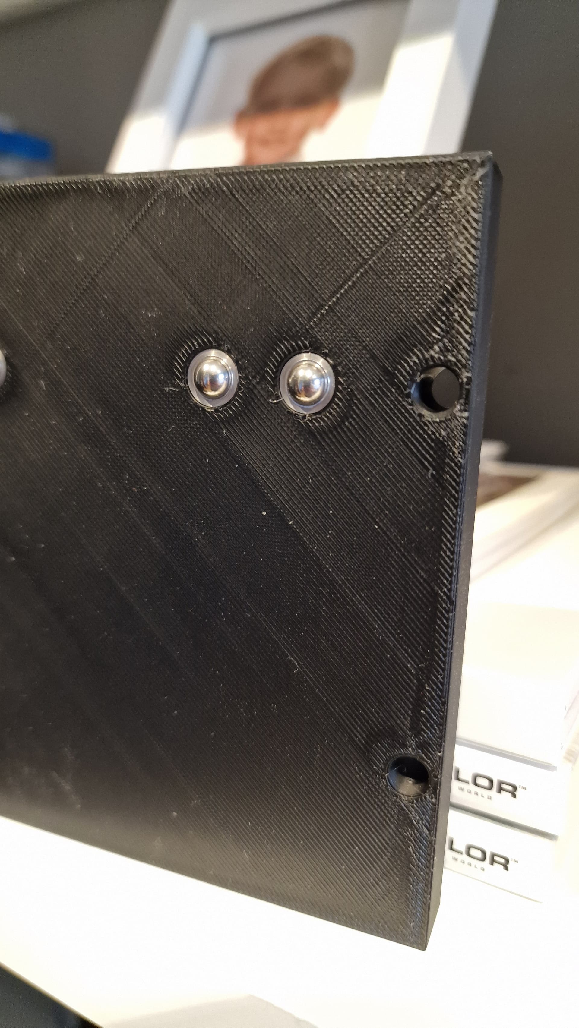

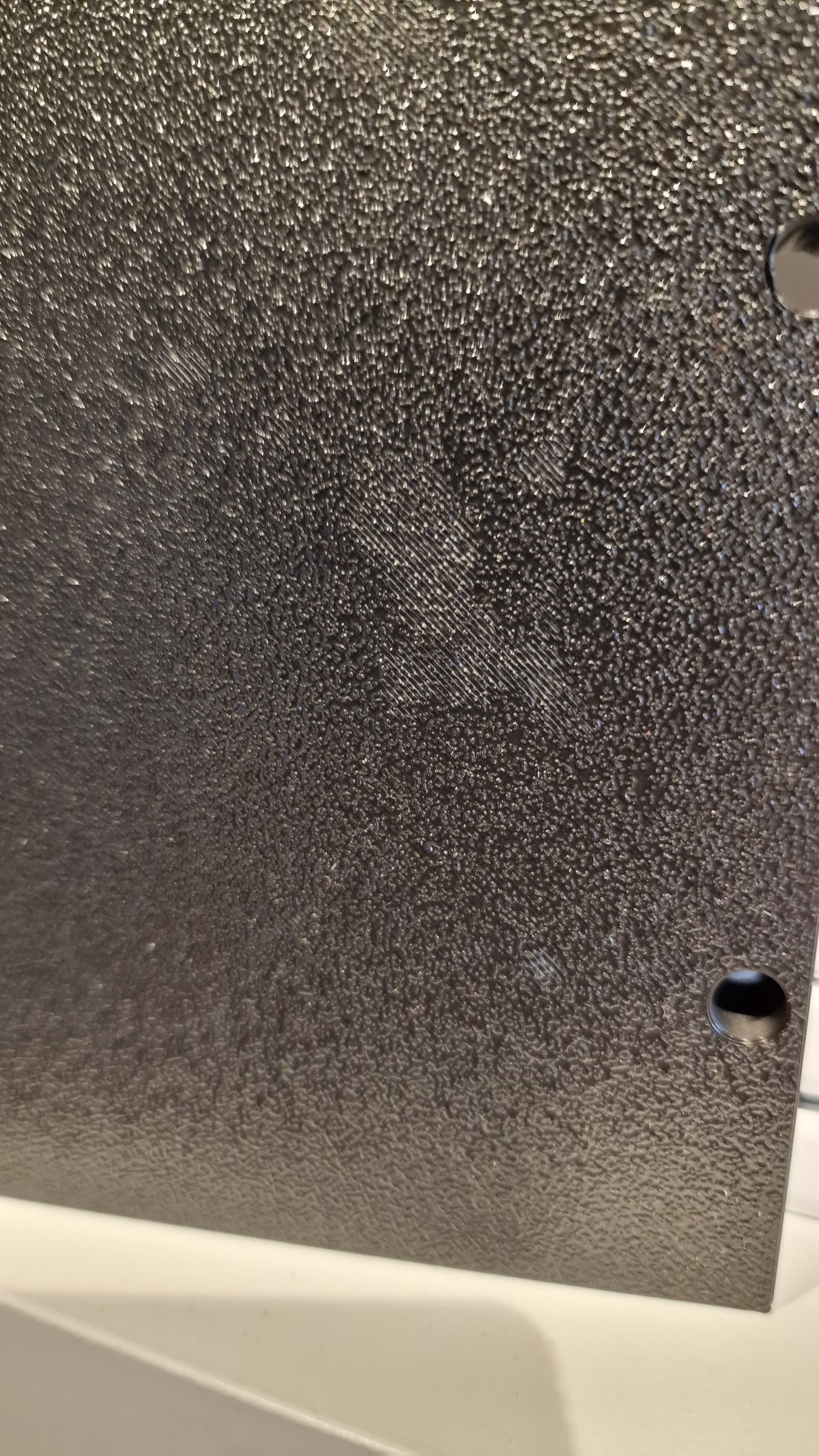

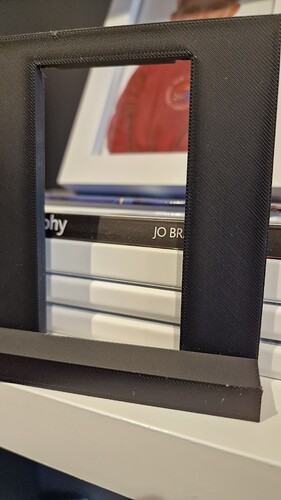

So thought I calibrate for the filament again but now there’s quite a few rough areas to the print and it has a kind of diagonal cris cross pattern as if the infill is showing through.

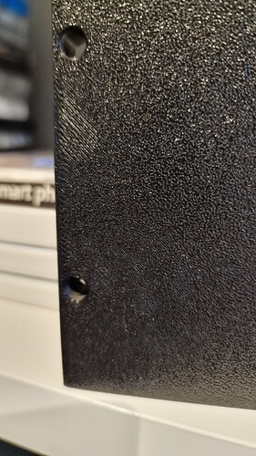

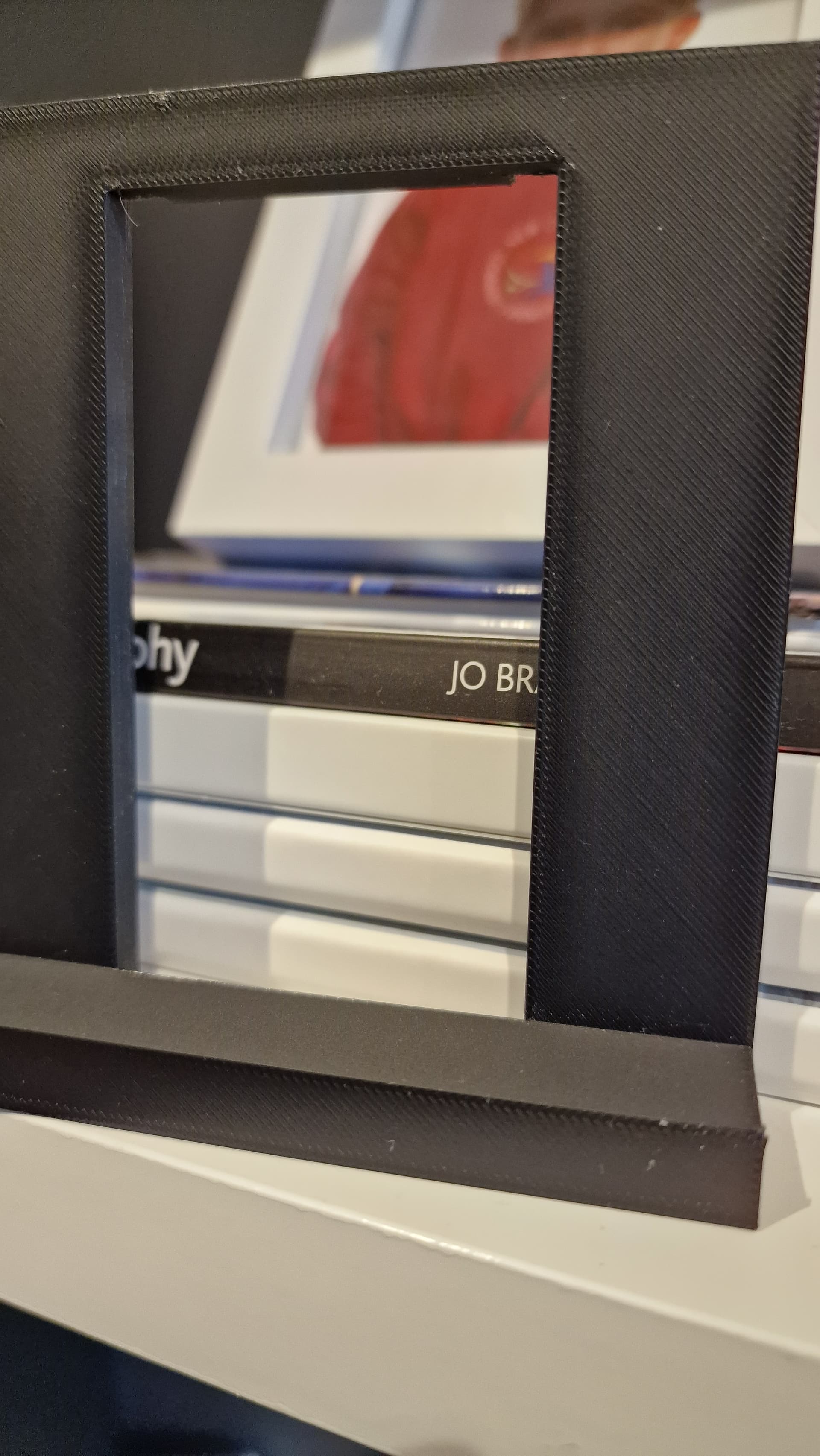

You can see on these last 2 photos that you can see the diagonal lines in a couple of places as if the 1st layer was too thin.
Any advice on how I can improve this? Is it just a case of tweaking the K value and flow ratio or is there something else I can adjust to make this smoother?
I’ve also done a max volumetric flow test for this filament which is set at 17m3 and I have limited speeds to 200mm/s.
Thanks in advance
As with any troubleshooting technique, always go back to square one and change only and one and only variable at a time. I’ve come to use that now in opening posts because so many folks overlook it and change more than one thing at a time and then wonder why they can’t nail down the root cause.

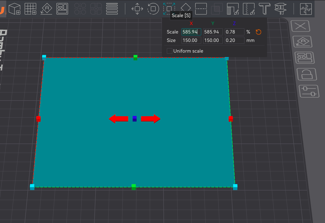

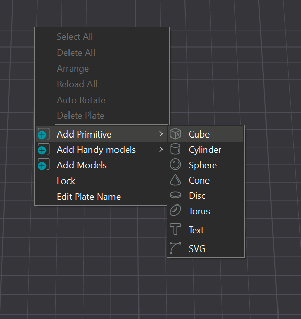

You seem to take a methodical approach so use that in going back to basics. What you’ll want to do is to do a first layer test. That test is very unforgiving and will readily show flaws in the print environment. No need to bother with downloading a model, it’s very easy to create. Create a cube primitive and scale it to your desired area of the build plate you want to test. 150x150x0.20mm is plenty of real estate to verify if you have calibration, flow or filament issues.
If you want to test the entire range of your head movement and build plate, you can scale it to 240x240 but 150 or even 100mm should be enough for a quick test.

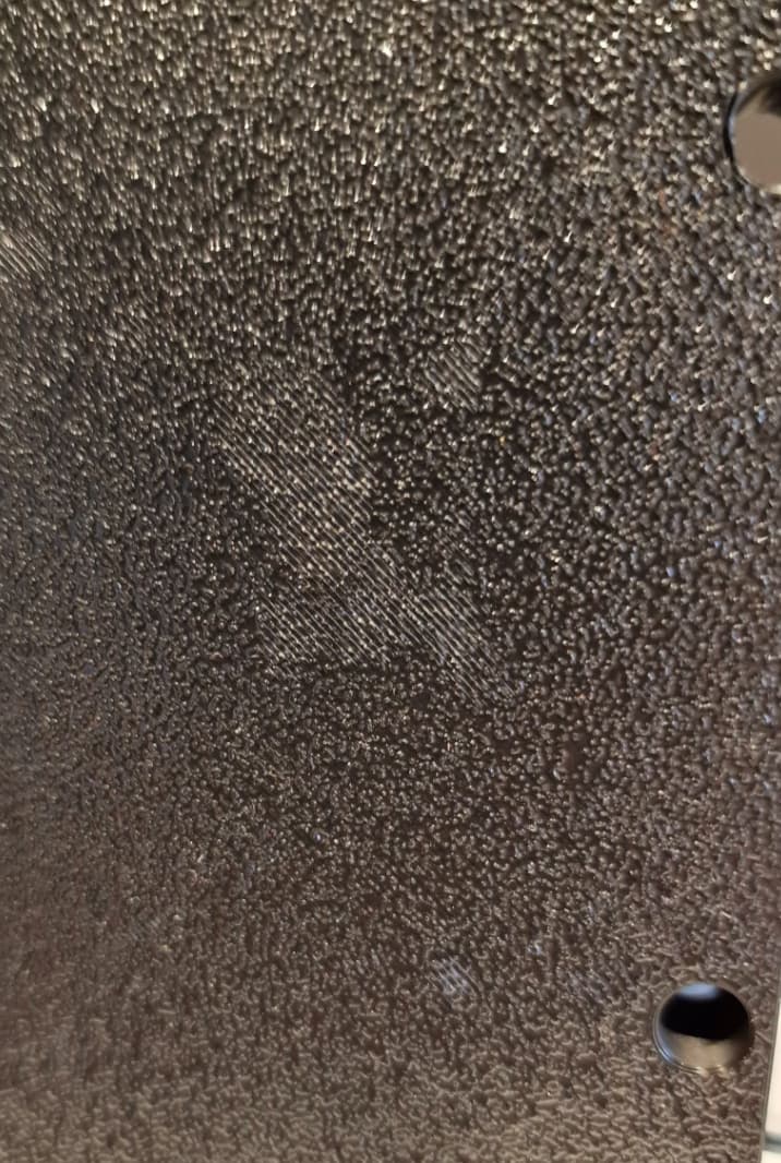

I can already tell from this photo that your plate has fingerprints on it so cleaning the plate is paramount.
Your single layer test should look perfect or at least near perfect as possible. This example is from a dirty plate.
The next thing you will want to do is ditch Bambu Studio for calibration. It is a pity that Bambu promotes their slicer as having calibration capabilities because there’s far more to calibration than line tests and K values. In fact, they are useless for all intents and purposes in diagnosing filament issues and lead the user to “believe” they are using a calibrated filament profile. You also can’t trust the Bambu default filament profiles either.
Instead, load Orca Slicer and use the baked-in calibration utilities there. No downside to having both slicers on your machine as they are ported from the same based code so if you are comfortable with Bambu Studio, you will be right at home with Orca. View this tutorial for how to calibrate the filament.
Don’t be afraid to experiment either. Here is an example of two side by side first layer tests I did with varying pressure advance.

For the top surfaces, try ironing (in BS, that is an “advanced” setting). Longer print, but usually smoother surfaces and no / less holes.
