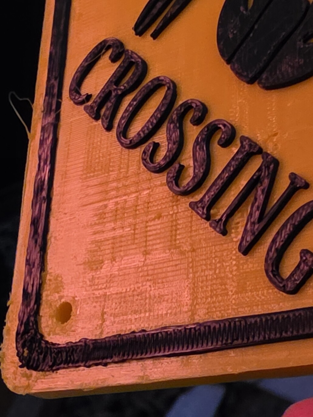

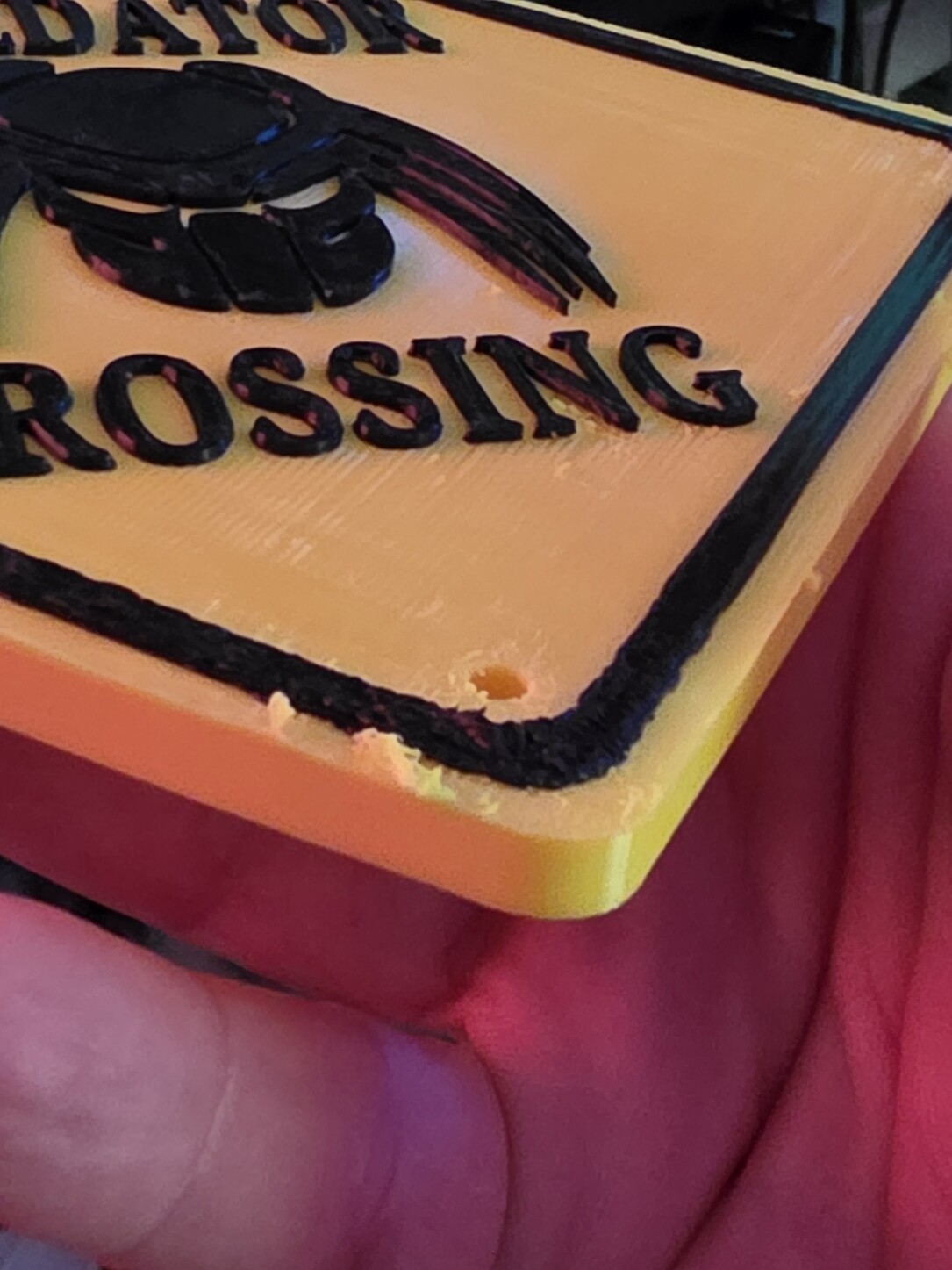

I have a model that I have printed many times in the past and it was always fine. I have a new A1 as a replacement as mine died. Have tried 2 different hot ends, leveled it, calibrated it, Flow dynamics, all the things I can find. Still prints horrible. Benchy comes out great.
  • Printer model used A1
  • Type of filament used PLA
Model:
Actually, the flaw should have been clearly noticeable during calibration - wasn’t it? Did you happen to take a photo of the calibration process? That would certainly be quite revealing right now.
On the other hand, if you say that Benchy looked great… what if you print a simple cube?
Your filament isn’t moist or spoiled, is it? :thinking:
calibration came up fine, no issues. I’ll try a cube, thanks. Brand new filament… driving me bonkers.
Just because it’s new doesn’t necessarily mean it’s dry - it’s possible it was delivered to you moist. It doesn’t happen very often, but it does happen. New doesn’t automatically mean dry. As I said, just keep it in mind. :grin: :+1:
For sure, thanks for the input. I’ll try try again.
Dry your filament even if this brand new
Yeah, I noticed huge improvements even when I bought Bambu filament, dried it for about 4 hours, and it looks better than ever
By any chance are you using a high flow nozzle. I recently had an issue where my calibration came out great and then when I did a print it was terrible. I noticed that the calibration didn’t apply any of the settings to the high flow nozzle. It actually multiplied the Extrusion way too much for the high flow nozzle but the actual calibration settings all went to the standard nozzle only and it applied different settings to the HF nozzle in the profile.
