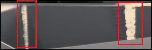

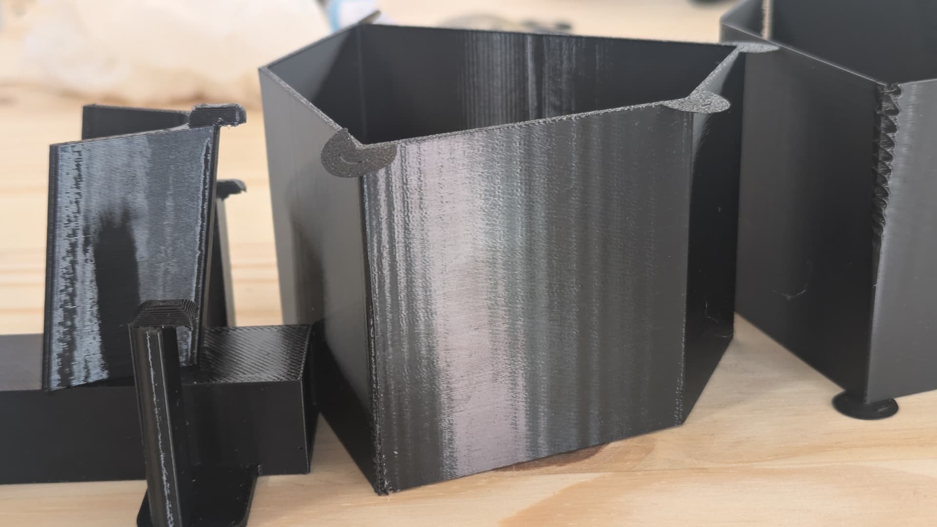

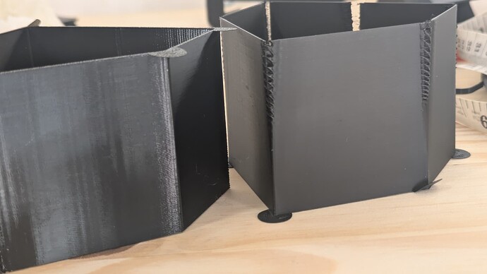

I printed (default settings, so a bit faster, .2mm layer standard) a few things in PETG (shiny),
and I see some ripples.
also you can see PLA (matte).
I’m just curious, is it as good as it get get? or is there a space for improvement ?
Those ‘ripples’ are not perceptible, and are visible only cuz PETG is shiny, as you can see, matte tower looks super smooth.
A glossy finish is going to show imperfections much more than a matte finish. You could try slowing down to see if that helps. PETG usually likes slower speeds.

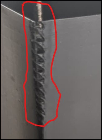

What is going on here?
it was just PA tower test, so don’t focus on corners or upper parts :slight_smile:
(in fact PETG shiny tower is upside down :slight_smile: )
so as I said, surface is smooth under fingers - perfect.
My question is, is this a limit of 3d printing? (or P1S), Can I expect even better surface? (I guess with very slow speed). Or is it as good as it gets - which still blows my mind :wink:
Run the VFA test to determine which speed is best for reducing VFA. Within the filaments limits of course.
