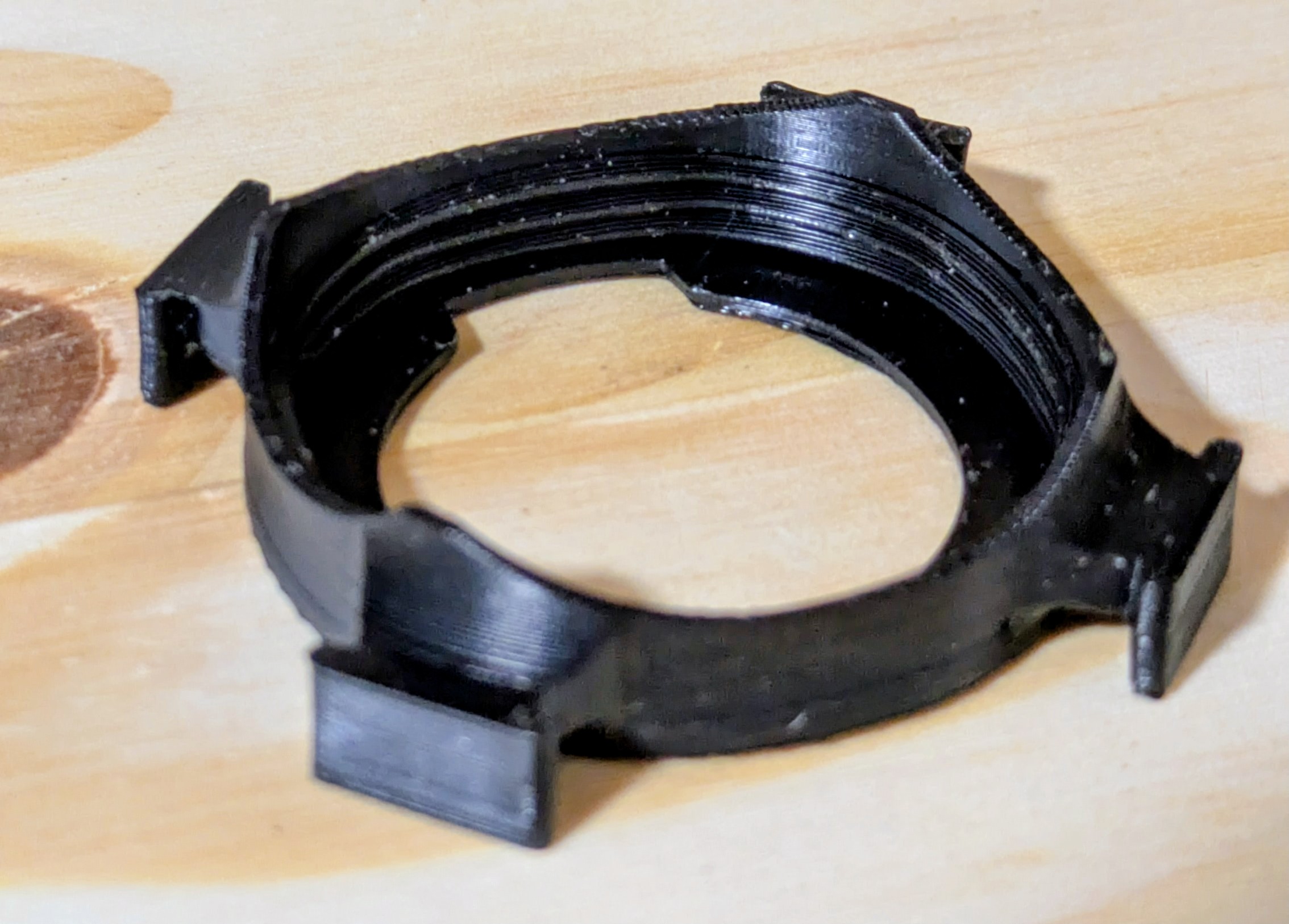

I’ve use profile from Overture website, not sure wy retraction length was 0, but on their website they say about 2-3mm? so I set to 1mm.
first print, looks impeccable
