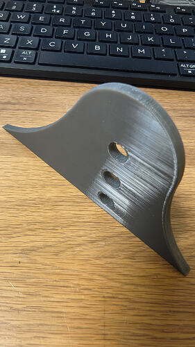

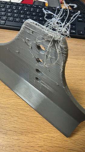

Print starts to fail after about 70mm height
This is a strange one and its got me stumped. Looking the the collectives experience :confused:
The hotend fan failed after about 1000 hours. Replaced it, ran calibrations, started a print.
Print failed.
I’ve not printed this model before so can’t say I know it prints. BUT, I have printed the section thats failing and it will print perfectly using the same settings in the same project so WTF?
Its PETG. 0.2mm, nothing exciting, 2 walls (with alternating extra) 12% infill (tried gyroid and grid). Doors are closed, base is SOLID, no warping.
What happens:
at about 70mm the texture starts to change
at 80mm defects start appearing starting with zits, then strings though the skin, poor corners, what looks like both under and over extrusion, then layer separation, eventually complete failure.
From about 70mm the layer adhesion starts to reduce.
What Ive tried:
Calibrated printer
Heat tower test (still good 250-260), tried all these temps.
Retraction test (went from system default to 0.4mm - no change)
Flow dynamics, minor adjustment of -0.004
Printed with 4 on the same plate and with 1, no change.

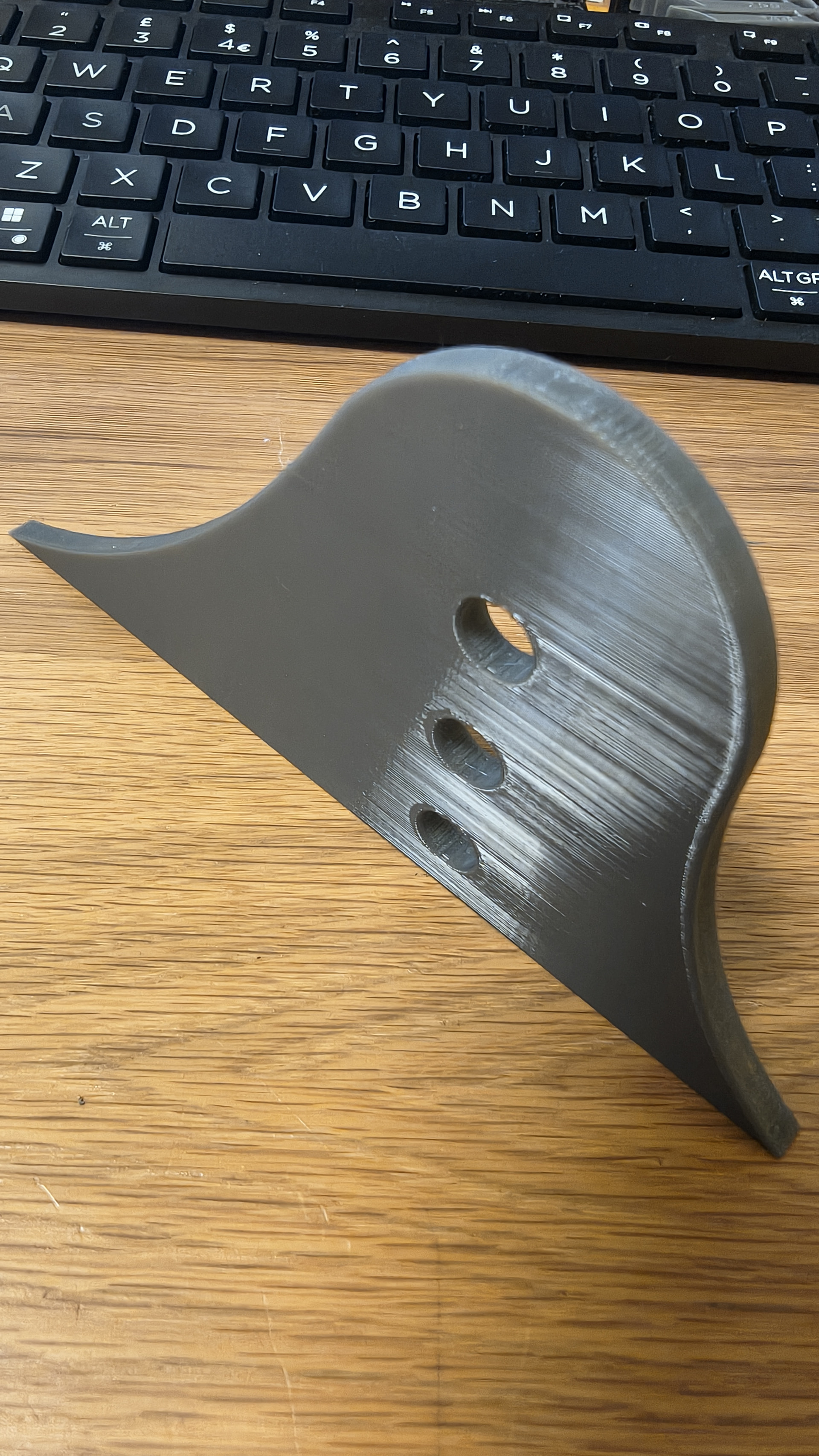

I have also just that top section, it prints perfectly (its really shiny material and probably looks bad in the pic but its good):
Ive also printed a 250mm cylindrical tower 25mm x 35mm and tried different speeds and temps during the print. That was also perfectly fine so it doesnt appear to be a Z issue.
Thoughts?
Only difference I can point at is that successful part only takes 1:20hr, the larger part nearly 4 hours. It takes about 2:40hr to get to the point it starts to fail. But when i had 4 on the plate it failed at roughly the same spot.

Looking at the parts more closely it looks like the filament went cold. But I also know the extruder throws an error when load goes to high which I’d expect it to if the nozzle stopped heating, but it hasn’t.

Update.
Dried the filament.
Decided to start a new project, imported the model.
Selected the “0.20mm Standard” Process profile. Changed:
Alternate extra wall: true
Ensure vertical shell thickness: Partial (automatically offered to change)
Top shell layers: 6
Bottom shell layers: 5
Infill: 10%
Infill pattern: Rectilinear
Chamber temp was about 38C throughout. No warping.
The print was successful.
I have now updated the Process profile include:
Bridge flow: 2 (this was established during bridge performance filament testing)
Smooth coefficient: 2
Only one wall on top surfaces: Not applied
Wall generator: Arachne
These settings bring the Process profile closer to the settings I was using previously.
I have mirrored the part (which I need) and started a print.
The profile I was working with previously was inherited from “0.16mm Balanced Quality” with some speed settings taken from 0.12mm Fine. . The main differences between 0.20mm Standard and 0.16mm Balanced being much reduced motion aggression. This was an intentional decision, VFRs are visible on the “0.20mm Standard” Process print.
Sorted.
Went through all the different settings then returned to the initial project that caused the failure.
The failure didnt repeat so it looks like it was a filament issue.
Thanks for you input.
