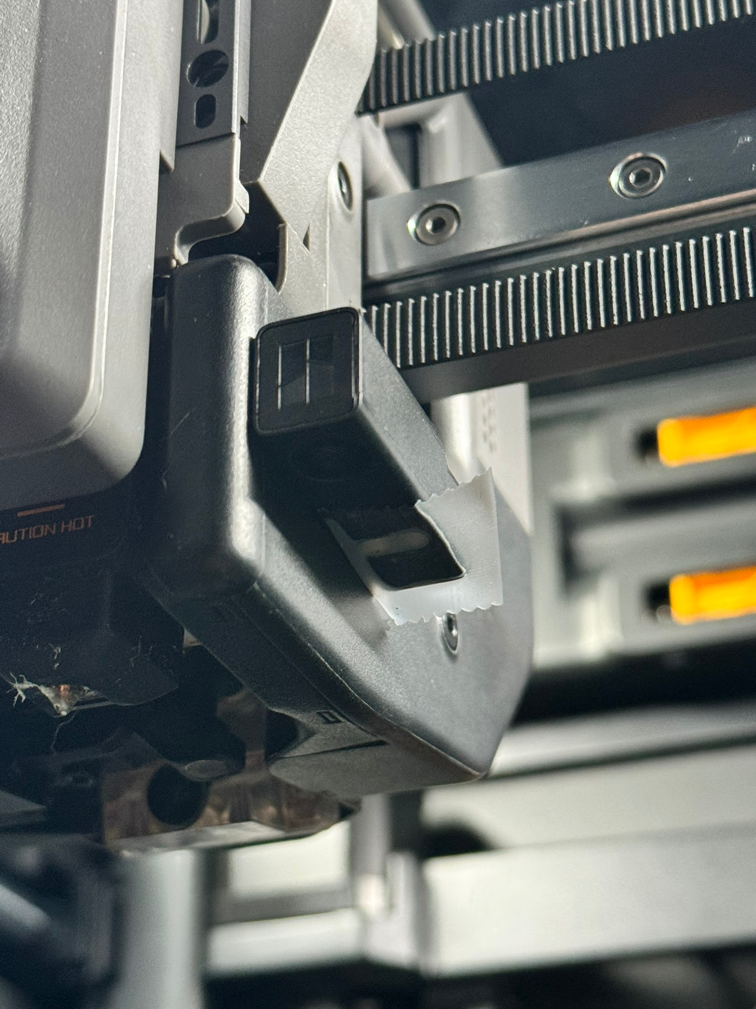

So I spent a ton of time and materials trying to figure out my own particular form of print then cut ■■■■ and I found a combo that worked!
I use the default bambu matte sticker paper but I add a satin/matte laminate over top for better texture and quality.
Here is the combo of things I used to get cutting and the print then cut calibration to work consistently.
  1. Ensure the thickness of the material is set correctly in the Thickness field, use a caliper to get the right value after applying your laminate. In a few tests, this was the difference between success and failure (coincidence maybe but unsure)
  2. Set the pressure higher than 300gF. For my combo of materials, I had to set the pressure to 450gF - as well as the cut through pressure to the same when Expert Mode is on.
  3. Apply a small piece of matte scotch tape over the light NOT the camera sensor. This one worked every time when using my 2nd laminate finish.
Maybe this helps others or you have a different setup/problem, but thought I would offer some thoughts on what worked for me!
