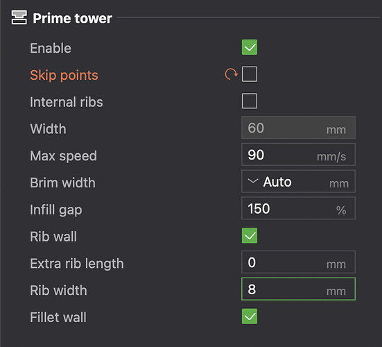

If you sure that your filament is dry,
apply the filament change gcode that bambu provided,
enable rib walls for prime tower,
DISABLE skip point.
Then your tower should look normal again.
