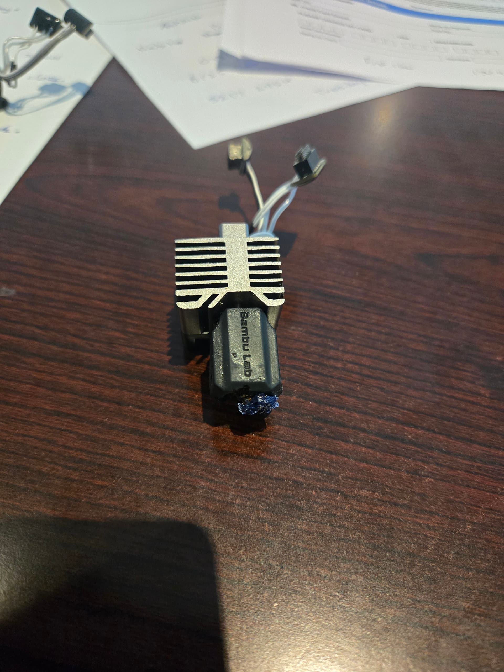

Printer clogs different nozzles P1S. Any reasons why?
I originally had my 0.4mm nozzle clog.
I tried a cold pull but seem to have the same issue. I thought the nozzle was just done so I thought to try my 0.2mm nozzle instead but then that got clogged as well.
Any ideas as to how the printer would clog 2 nozzles? I have not changed any settings whatsoever and even tried a print from before no issue but that clogged the 0.2mm nozzle.
If the extruder is clogged, would that then mean that no filament would come through? I can confirm the filament does some through.

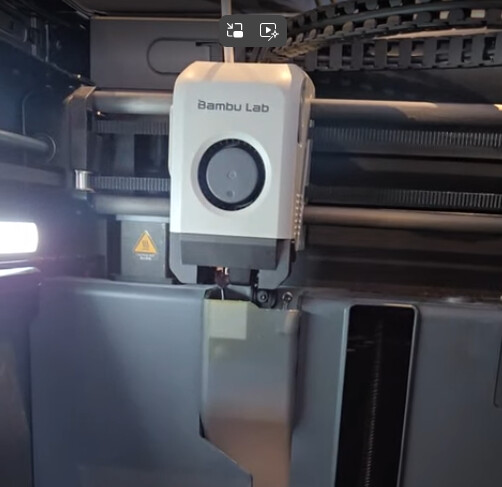

Hi all. Update.

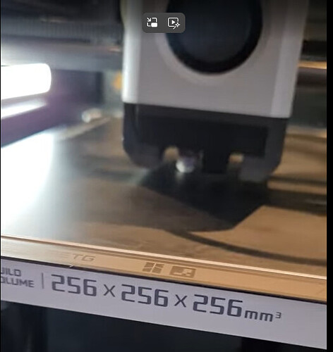

I’m using Bambu Lab PLA. After a cold pull and recalibrating a simple fidgit print failed.
I captured a video of the fail (but cant seem to upload). Before it prints you can see from the flush that it seems to flow out ok
and at the beginning it actually prints the line down the bottom

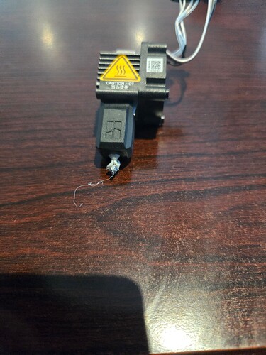

but from there nothing sticks to the plate and it clogs up again.
Any thoughts?
It is said on the forums quite a bit but even Bambu’s products can have moisture in them which will effect whether your print works or not. Even if it’s a brand new roll, dry it out.
Also, make sure your plate is clean. Your issue isn’t that the nozzle is having problems. Your print isn’t adhering to the plate and the printer continues to push more filament as if it did adhere. That filament has to go somewhere and it is sticking to the nozzle instead of the plate. Clean the plate, maybe increase your bed temperature or try another plate.
I dont think you’re getting a clog here, your prints just aren’t sticking to the buildplate and then they ball up on the nozzle. Or the model youre printing isnt on the buildplate, or something of that nature. If it lays down layer 1, then Deep clean that plate, IMO. Make sure your bed heat is set to something and not 0.
unscented Dish soap (dawn), a scrubby you dont use for dishes, hot water. Handle on the edges
To clean the nozzle itself, just put it back in the machine without the silicone sock, command it to heat nozzle to 210, give it a minute, and itll melt again. Wipe it off carefully with something that isnt your finger cuz its very hot.
I agree with the past two comments, it sounds like a buildplate issue. If it’s the textured PEI plate, you could try washing it and flipping it over (mine that came with my printer is double sided). Sometimes, the texture get worn out over time.
