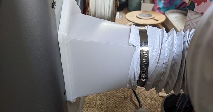

Main question I was after in my post though was the pros/cons of a P1S in a cabinet enclosure (and then vent the cabinet to outside) versus just sit the printer on a tabletop and print adapters to attach a vent to the back of the printer. The Prusa was pretty much do everything from the front (so open the cabinet, swap parts or filament then start the print)… the P1S will need fairly routine “get behind it” maintenance it seems (attach/swap PTFE tubes for AMS or external spool, etc.) which I think will be a pain in the cabinet enclosure. Will be a couple of hours of work to cut my tall cabinet down to a tabletop height cabinet… and it can’t be undone. So just kinda looking for input before attacking with a saw.
Printer is in my office… can’t really just leave a fan in a window, will suck AC/heat out with the fumes and definitely make it uncomfortable. So will have to be a duct from the printer to the outside or the enclosure to the outside. Main question then is which is the best option. Either is doable just wonder if the enclosure will make for allot of headaches accessing the printer for maintenance and such.
If you can manage it, I’d keep the P1S in your enclosed cabinet if you are able to. I realize the P1S is an enclosed printer, but it can still release fumes while printing. Using the cabinet leaves you with the possibility of venting the cabinet without really affecting the temperature in the enclosed printer since you won’t be directly pulling air from the printer. But to your point, you do increase the difficulty of reaching the back of the printer, which would also mean you’d have to figure out how you’d manage the filament poops coming out the back chute.

I was hoping to have better links but this is my approach when I finally get around to creating a vent solution. These are the pieces you will need to create a duct system that will interface with a casement windows. Note that I have not executed on this so there will be obvious fitment challenges that you will have to solve for your use-case. That being said, this is 95% of the solution, the rest quite honestly could probably be done with “real duct tape” not consumer “Duck Tape” as one will often see it misspelled.

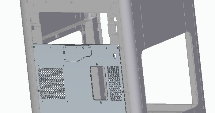

For P1P users
Printable Chamber fan Plate - Although you could print this, I believe the P1S panel is a better solution and I purchased one myself.
Better option for P1P, get the steel P1S read panel. If you buy no other upgrades for the P1P, this is definitely the one I feel has the best impact
https://store.bambulab.com/products/rear-metal-panel-p1

And finally, this is the search term for Amazon for window duct systems and adapters. I already have one of these for an unrelated free-standing air conditioner and it works quite well. The search term will show you all the myriad of option for 5" duct. There are enough adapters on the market to resized to almost any opening but where’s the fun in that? Print one!!!:blush:The two photos are examples of the kits that I know I can make work.
https://www.amazon.com/s?k=window+5inch+hose+duct
