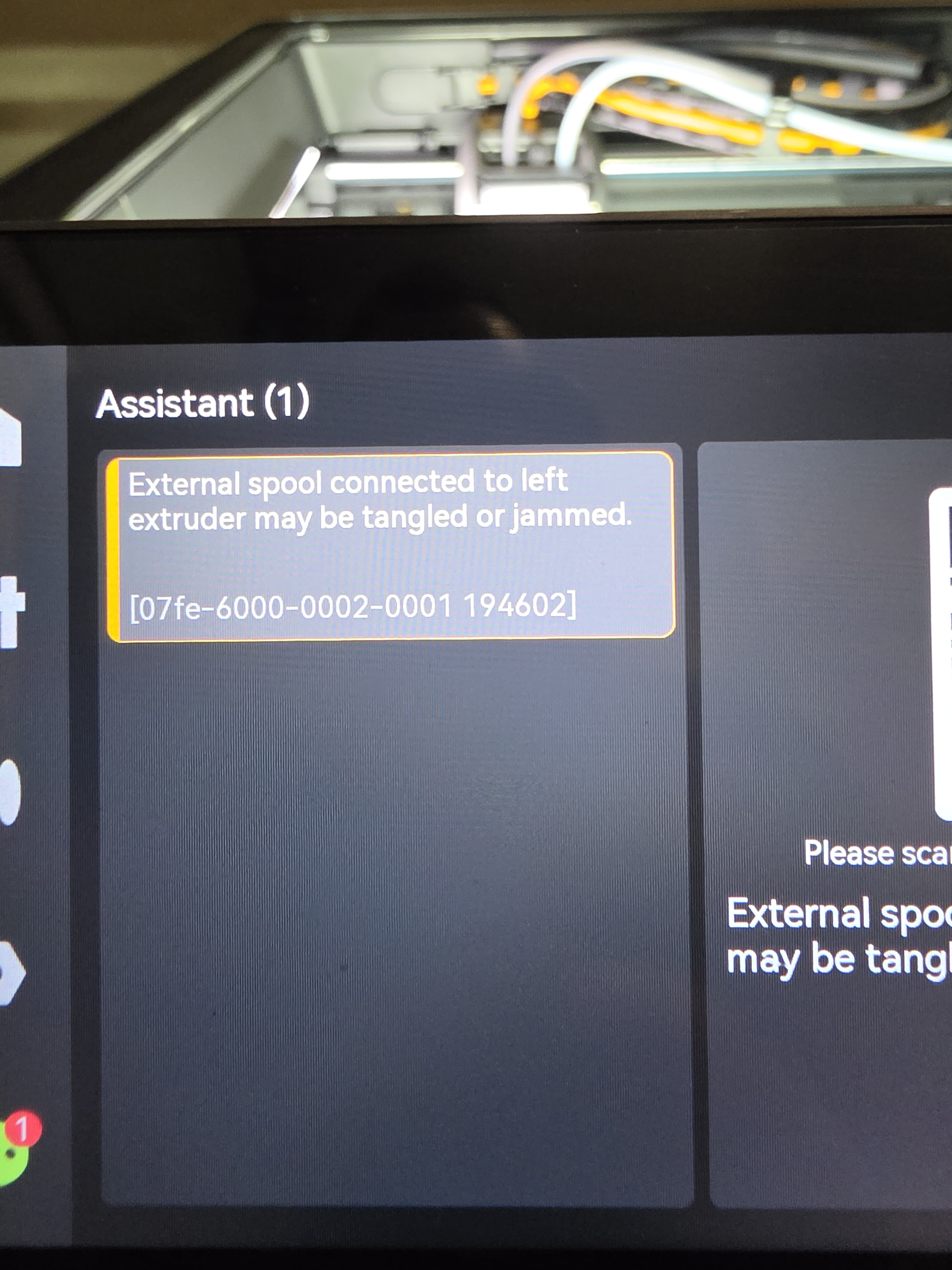

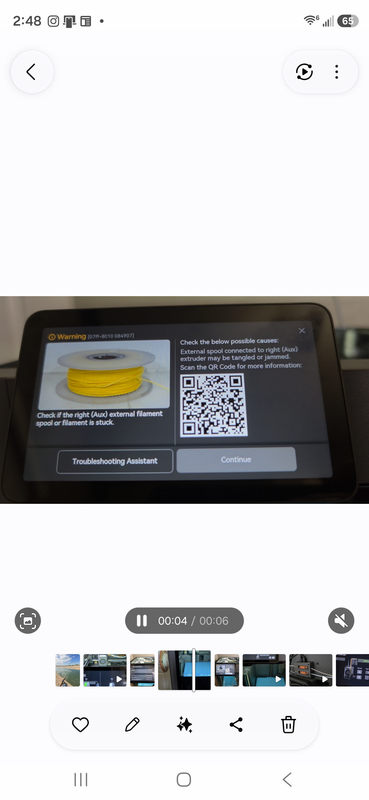

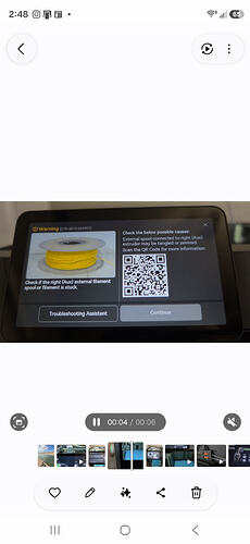

Hey guys! I have the x2d its been down now for 2 weeks. I have checked and removed both nozzles for stuck filament. All the ptfe tubes are clear. I have no tangled filament anywhere. I checked the sensors and we are looking good. But i can’t print anything using ams 2 pro or manually loading the filament. I keep getting external spool tangled or jammed. Anyone have this problem before? what are the odds that both my nozzles wont feed and dont print at the same time??? I have

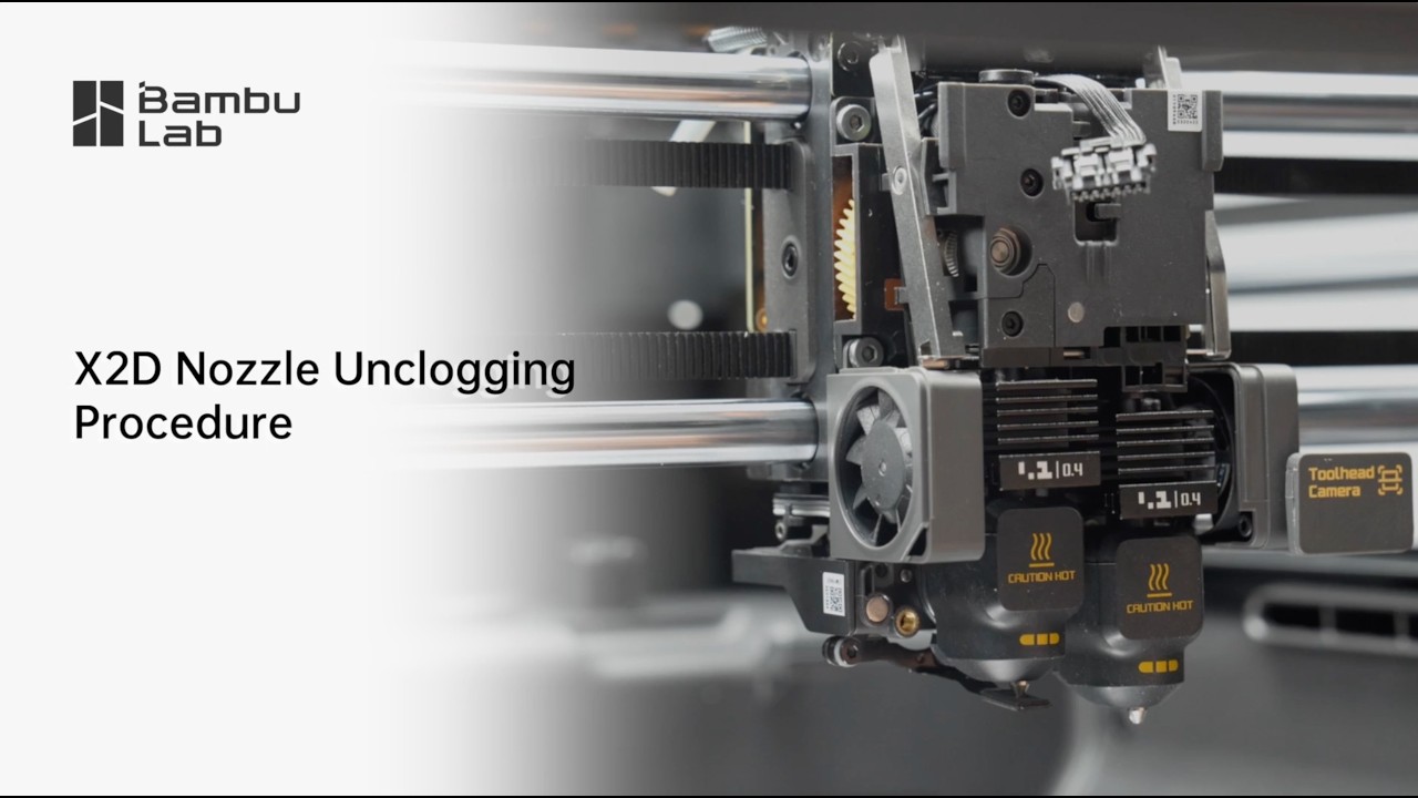

This video is a good example of going what is needed. Start with this or after the PTFE info above.
