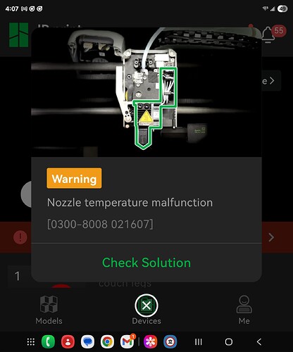

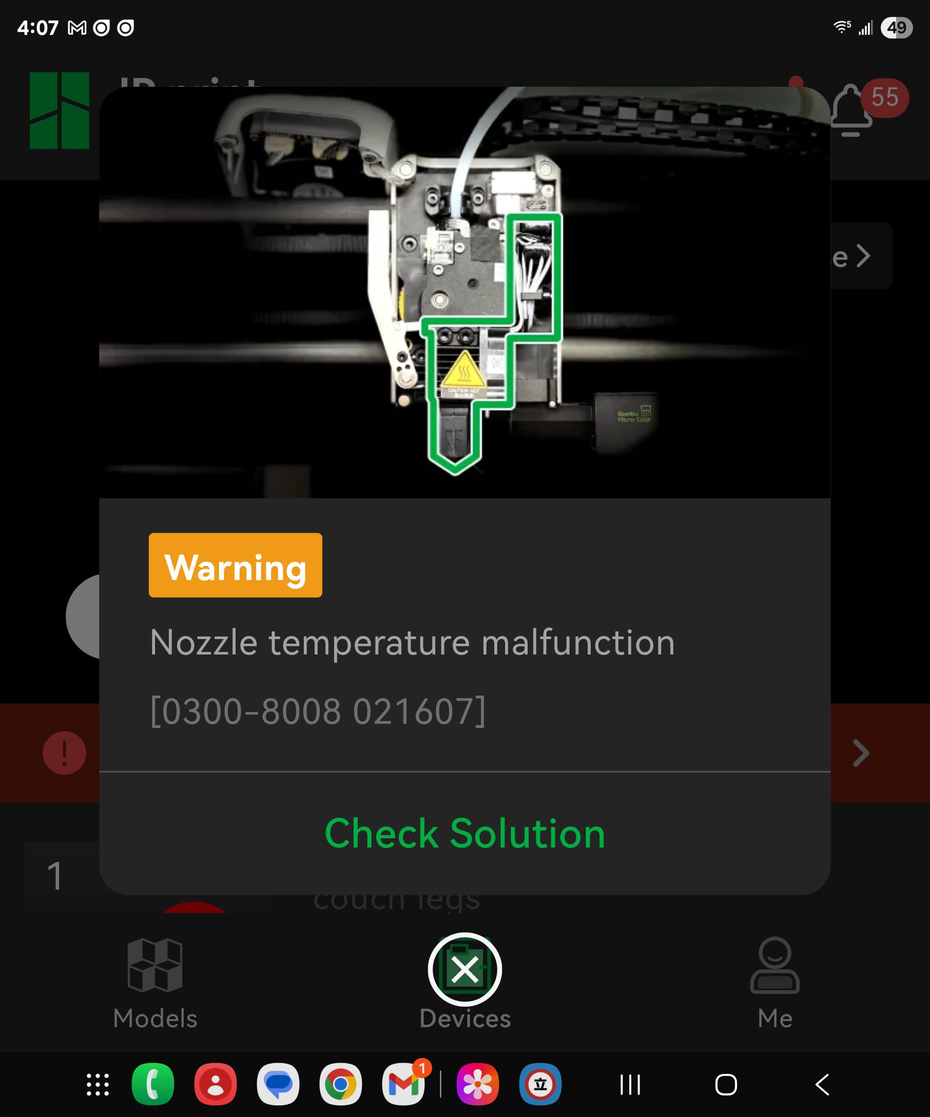

Hey there. I’m getting a strange failure on every print that I make lately. It seems to be related to the heating of the nozzle with this error message that is attached. But when I try to go to view Solutions there is nothing listed. Does anyone have any idea on what this is and how I can solve this?

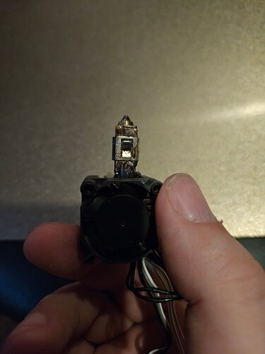

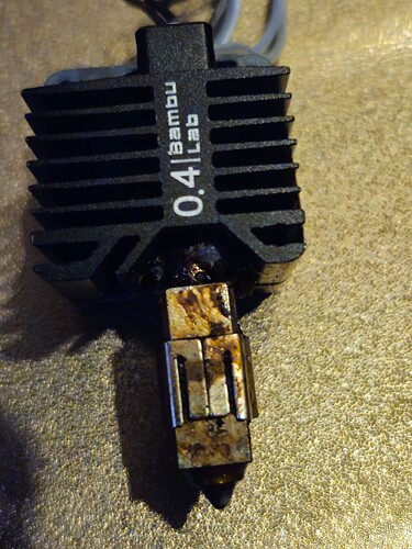

Im guessing this is the issue

With the nozzle seemingly bent, your best option is probably to salvage the fan and replace the hotend.
If it wasn’t bent, I would have advised to dissassemble, clean and install a new thermistor and heater.
