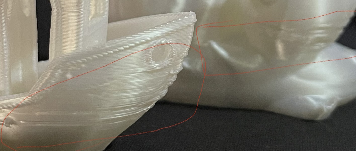

Im a new beginner in 3d printing and as soon as I printed the first object I faced the same issue which is shown in the image . I still didn’t figure it out yet

Dryed the filament before use? Never use filament right out of the bag. It can be wet resulting in interesting failures. Even in a vaccum bag.
Actually no I didn’t dryed it. I’ll try to dry now before I print anything. Do I need a device to do the dry it or there are different ways to do it.
Is that the support filament by chance?
My thoughts, too. Bambu sends a roll of white support filament w/AMS combos

The little bags of silica gel are really just to keep moisture out of the air. Filament has the ability to also pull water out of the air and retain it inside itself. Putting silica gel with it will prevent additional water from the air from being absorbed into the filament, but it doesn’t do anything to get the current water out of the filament. That’s why you heat it low and slow, just enough to let the water evaporate out.
Now, do you need to do this for every new roll? Some would say yes, the longer you’ve been in the 3D printing game, the more you’ve seen rolls come from factories, vacuum sealed with the little packets, and are still heavy with water. As an experiment, you can get a good scale and weigh your filament roll, then dry it for a few hours and weigh it again. That’s just the loss of water (unless you accidentally melted the whole thing…!)
Personally, these days I don’t dry most filaments, especially PLA varieties. I don’t run into any issues, but I will store them in dryboxes once open with the silica packets. For the rare times I print something else, I usually will dry it first. The point is, you don’t know the conditions in the factory, or how humid it was when they extruded and rolled up your particular reel of filament. If you want to remove potential issues, dry first. Otherwise, dry it once you hit an error or two with that roll.
