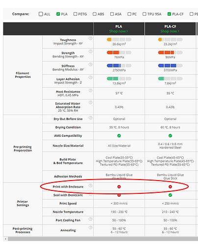

Yes, PLA needs the top open or off and the door open .
Pretty handy guide here: Choose the right filament - 3D Filaments Guide for Bambu Lab Printers
Thank you @lkraus for sharing this guide.
There is still a lot to learn for me :slight_smile:
