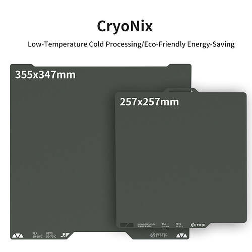

Just to make sure, the Fysetc I have should behave the same as the Glacier right? Just tried to print a PC Benchy but unfortunately it detached (the bottom is warped slightly). Should I use another plate for PC?

Hi Maxim,
What do you think on this plate, mentioned by the Simton:
Noam.
It does not matter where you buy the Glacier, the plate is the same from the same manufacturer. Aliexpress has the best prices usually, and BTT (the manufacturer) have their own store on aliexpress as well.
The Fysetc should be the same material (polyura) and style as Glacier, just different color. I have not tried one personally though.
