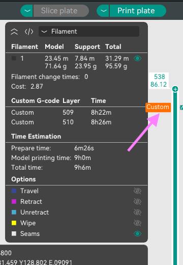

Just a guess here but I have added a pause by accident after slicing I would scroll down the layer preview and click by accident putting in a pause at what ever layer that I stopped scrolling at. or maybe bambu slicer noticed that what you were printing looked like a logo and asked if you wanted to add a filament change and you chose yes by mistake. Just my guess

If what you’re receiving is a “Printing paused by user” double and triple check your printer’s preview pane before you hit go. Especially if you’re using someone else’s file!
They show up similar to this in your timelines, and that layer will usually be “gray” in the colorful line-type render.
You can check the gcode as well, export to gcode instead of hitting print, and ctrl-F for M400 U1
