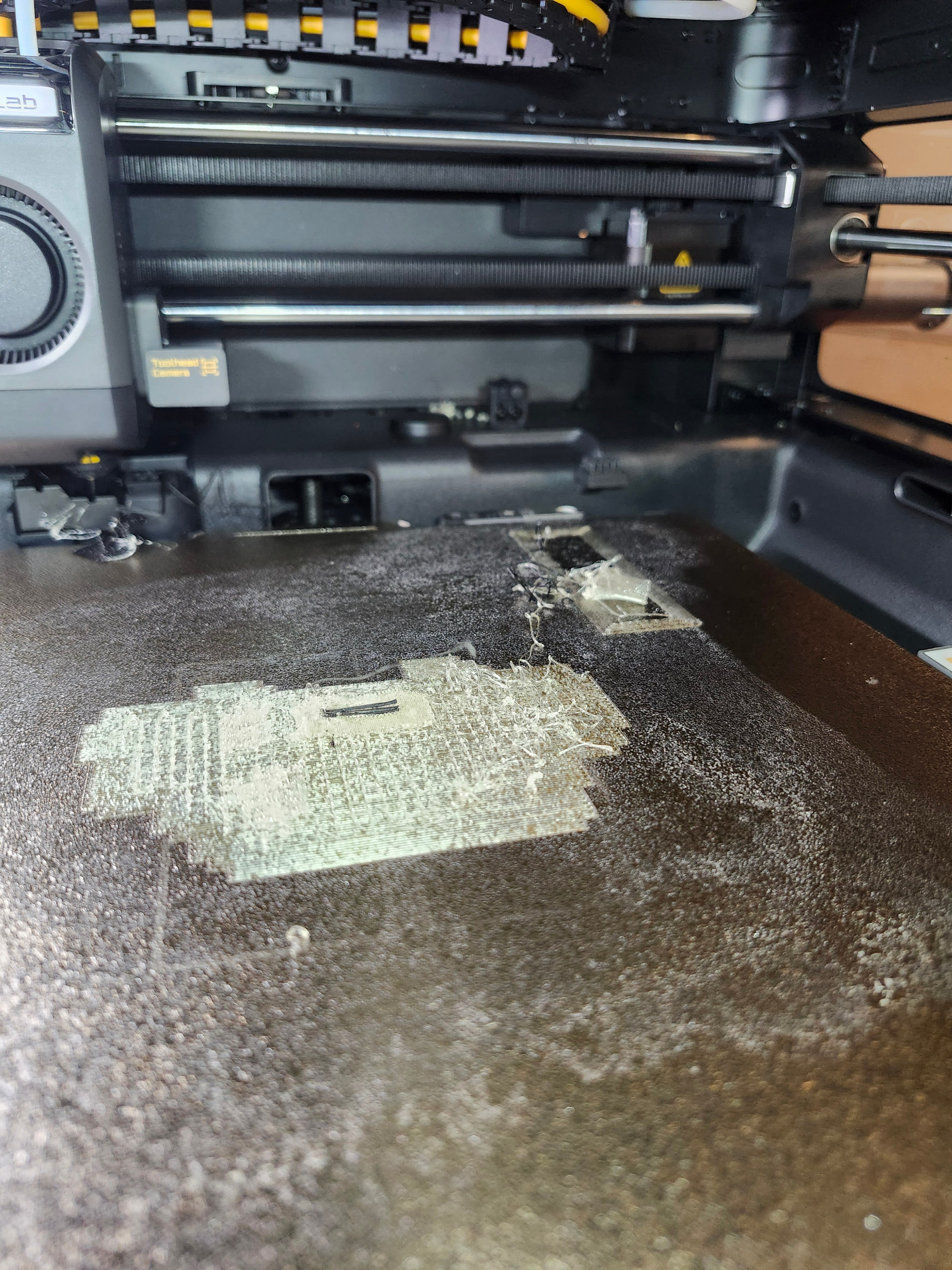

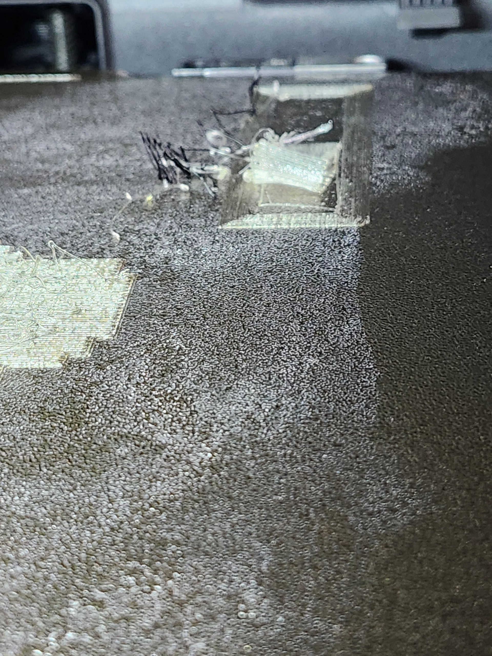

I know it has literally been a year since this was posted. I am new to the Bambu community and need some advice if you have any. I am using an X2D with AMS2 Pro. PLA is loaded in the AMS, PVA loaded in the Aux for the 2nd nozzle. I am having issues getting the 1st layer to adhere to the bed. It is the textured PEI plate that came with the printer. I have mirrored your settings and it is not helping.

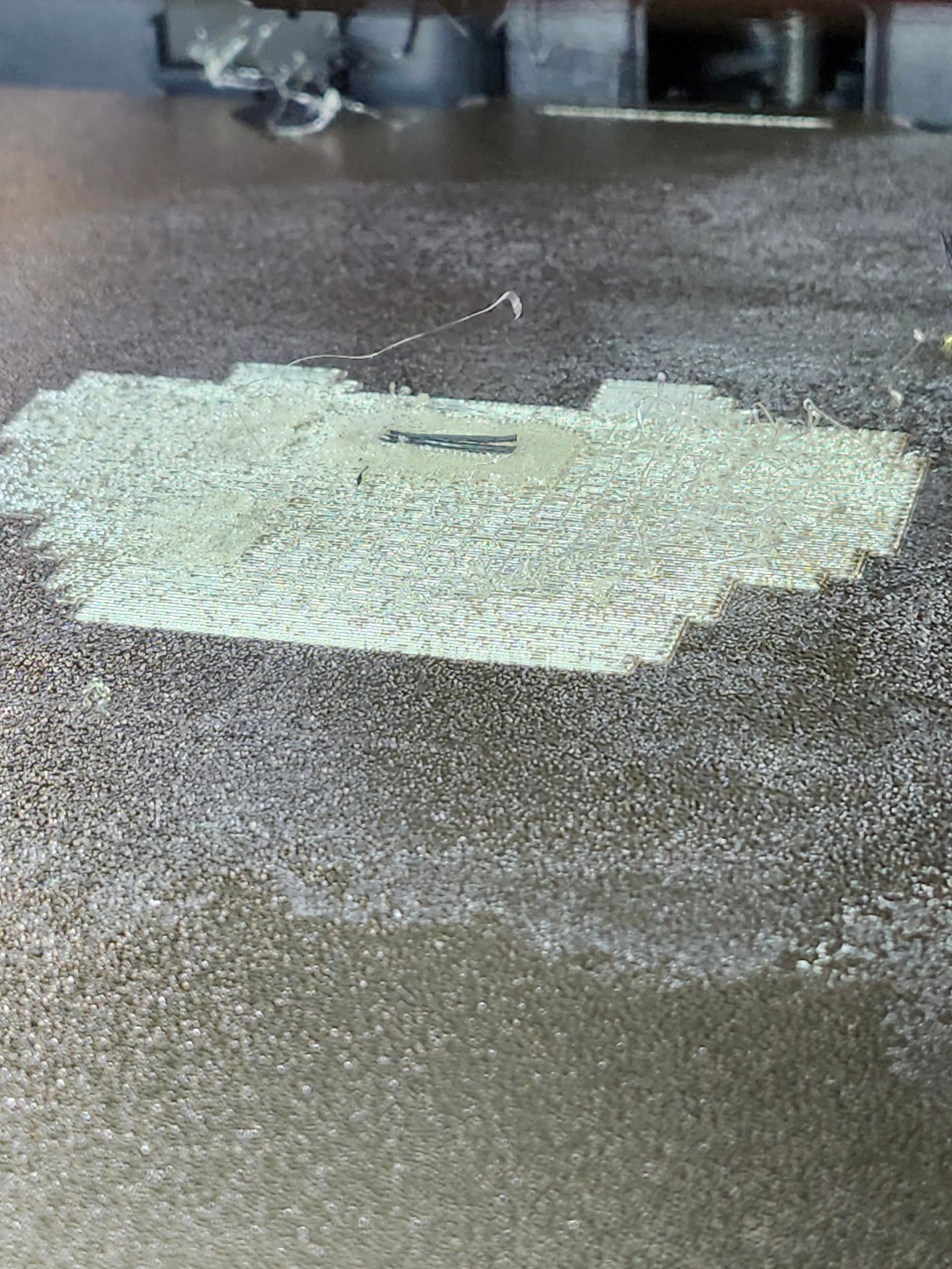

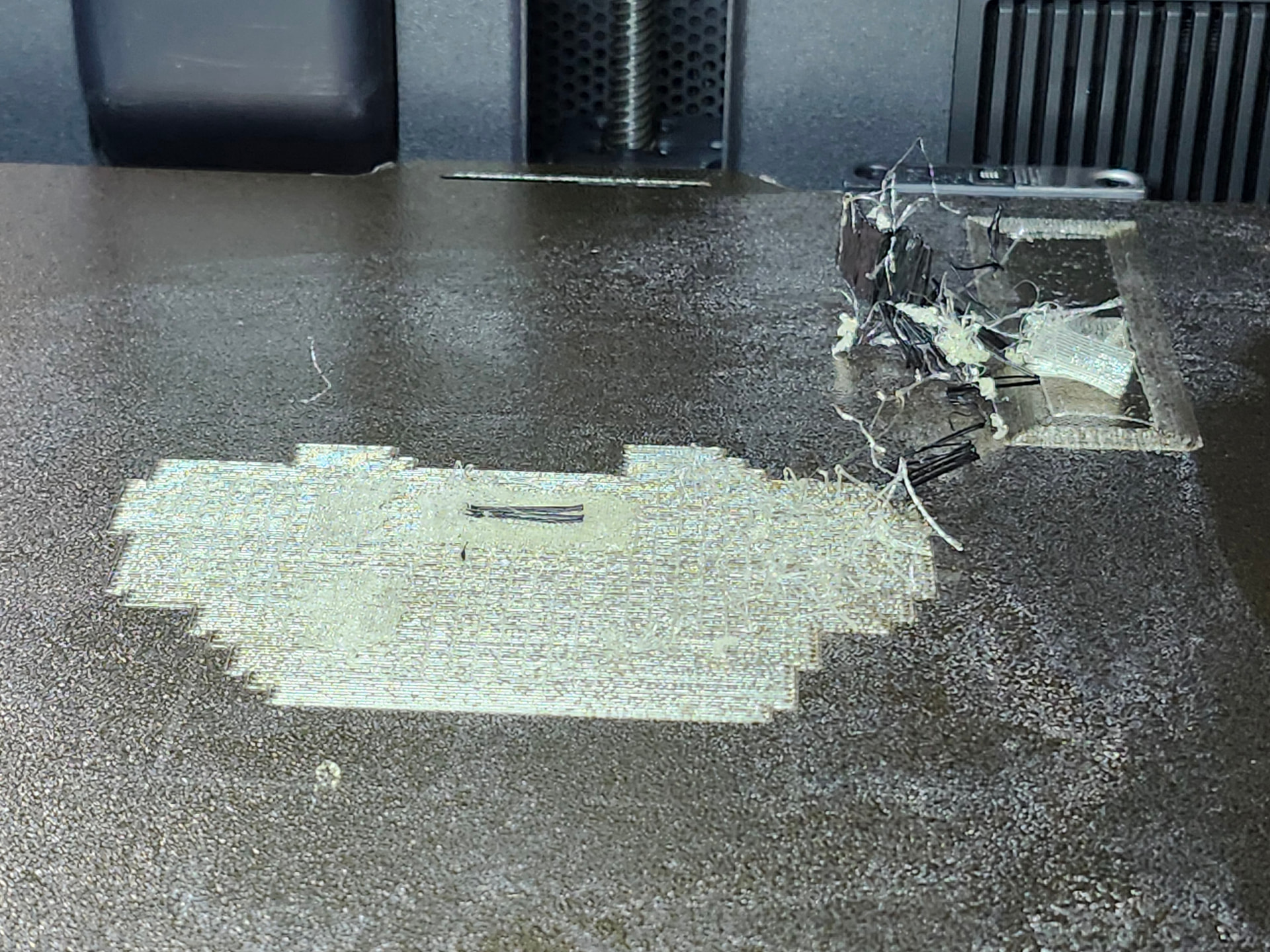

PVA is one of the most aggressively moisture sensitive filaments out there, so make sure your roll is dry and your Flow Dynamics from the Aux nozzle is tested + set. It’ll make it print cleaner and less likely to get snagged and pulled up.

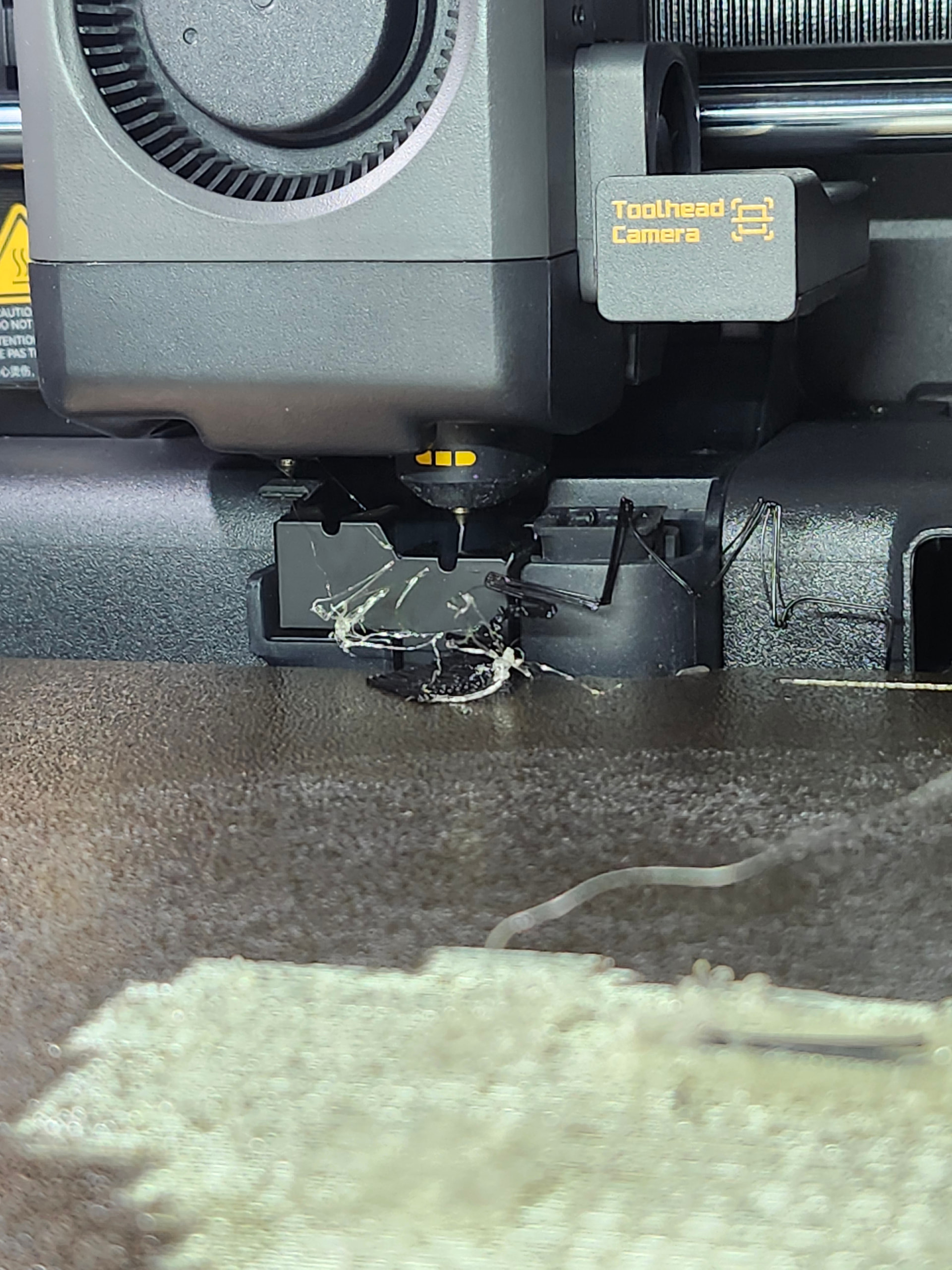

The 1st layer adhesion is not the issue anymore, as I got decent results slowing the support speed to 25mm/s and using Bed Weld adhesive. It is now subsequent layers that are not printing well and will cause the print to fail if I let them go…
