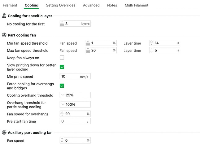

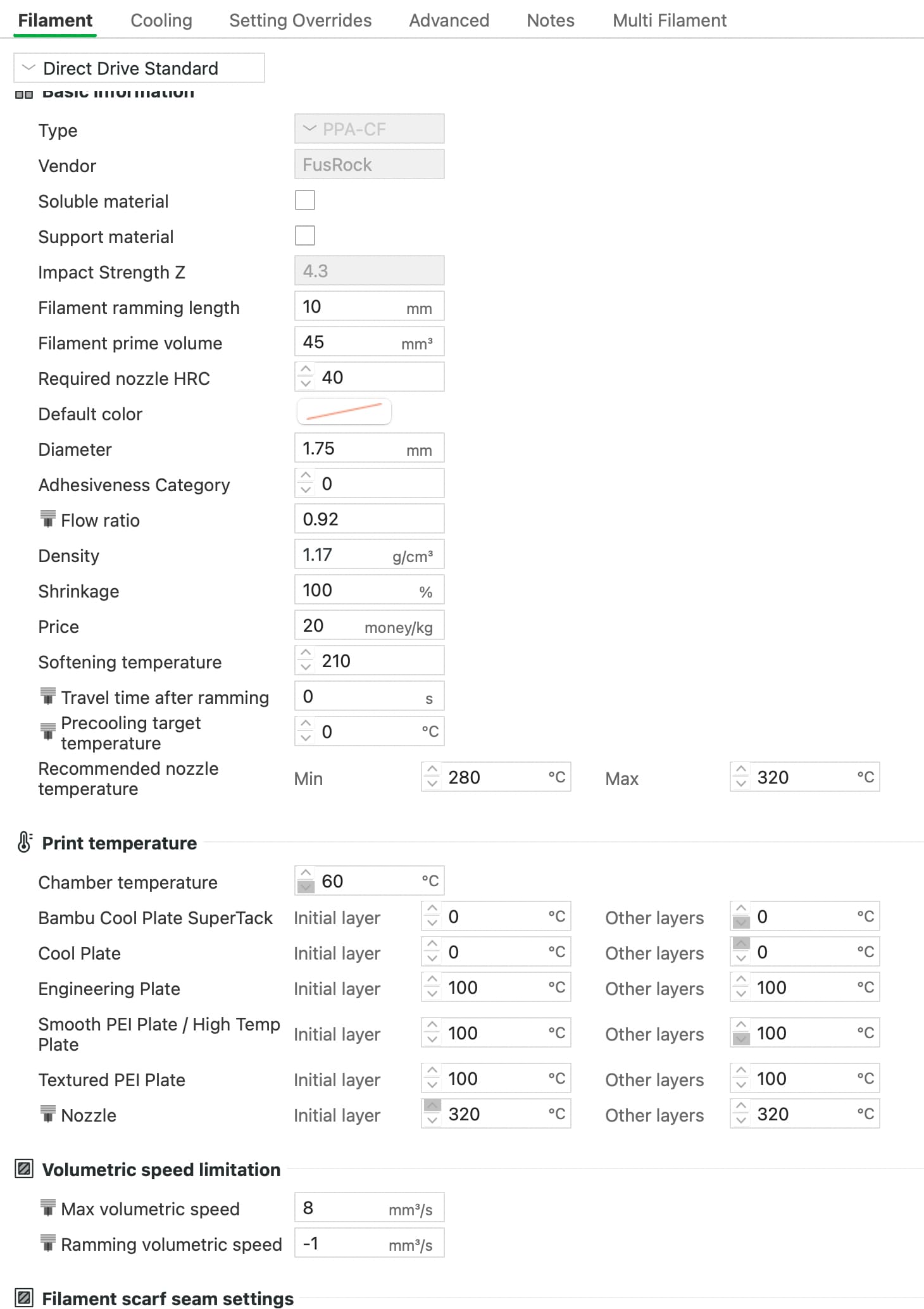

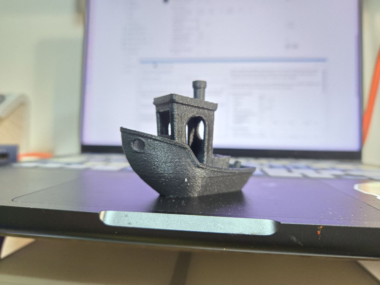

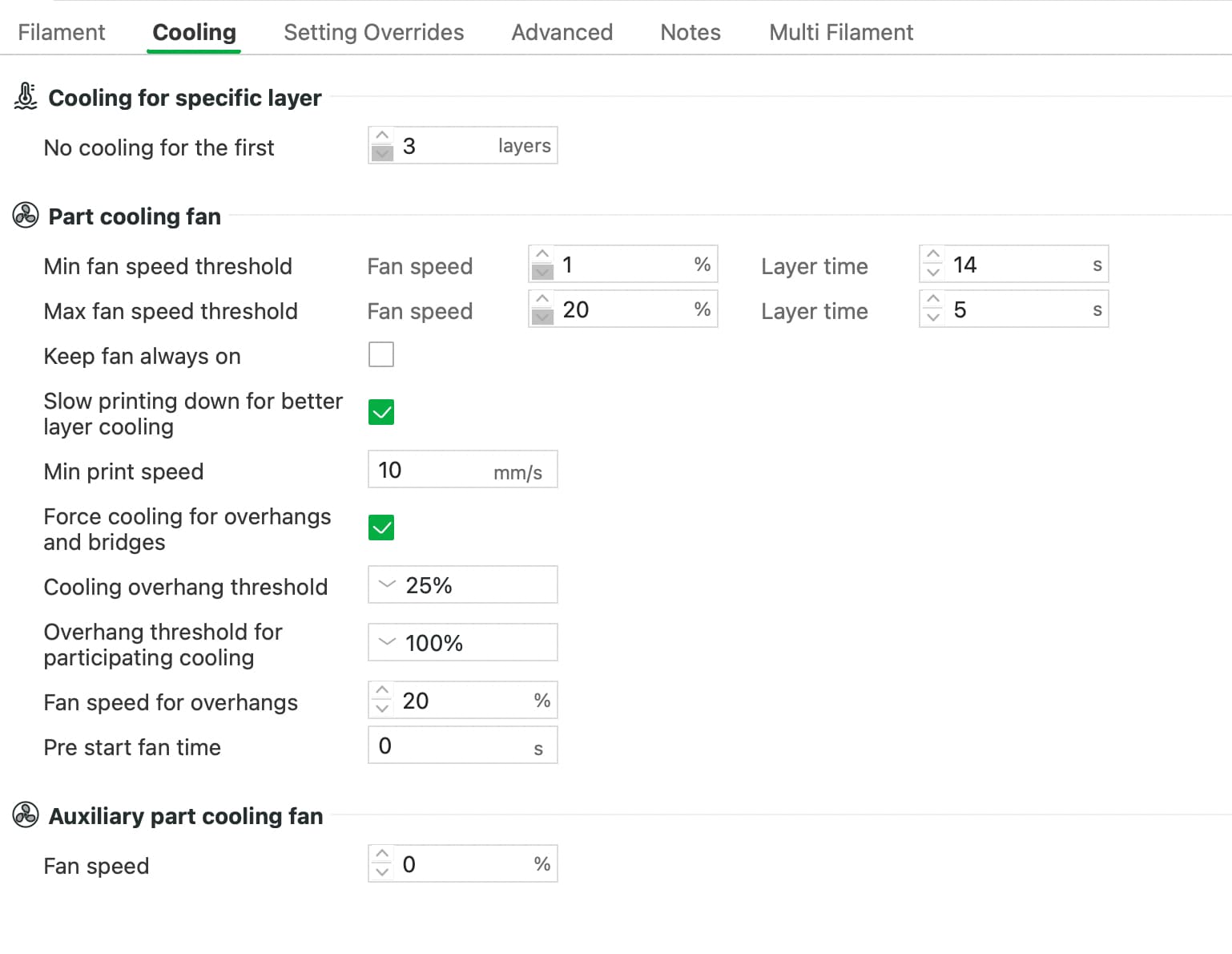

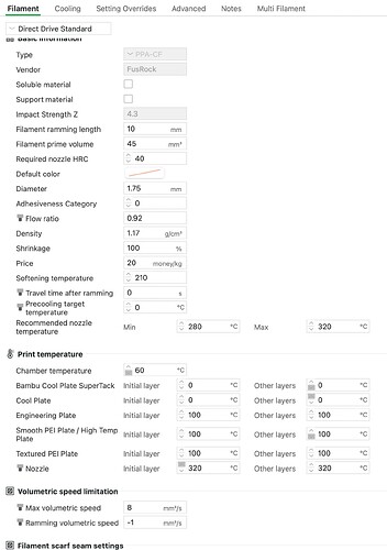

Due to limited availability of printing time, I don’t have enough time to fine tune Min Layer Time (can see deformed Benchy chimney) on this printer. But this version should work good enough, except for long bridging.
And one thing that I noticed is that compared with X1C, you have to significantly reduce the fan power to make sure it’s not over cooling.
Results:
Here’re my settings:
(note that I decreased the bridging cooling from 30% to 20% after I printed this benchy, the single layer benchy hull line and the falling bridges on roof means that the bridging cooling might have been too strong)
