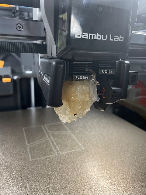

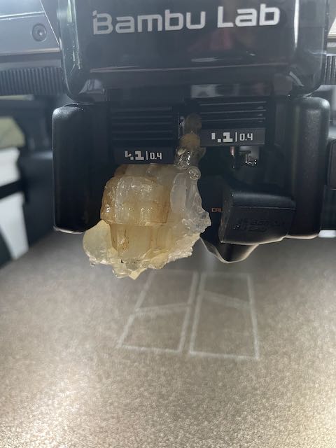

I launched on July 4th a printing for about 7 hours, using a specific kind of filament (FormFutura Styx-12).
When I came later to see how things were, I found a complete mess (3 first pictures joined).
  • the piece currently partly printed was stuck to the hot end,
  • the hot-end and the whole extruder block were entangled in a big mass of melted filament,
  • the printer stopped displaying an error message HMS_0300-1E00-0001-0007,
  • the printer never detected a problem during the printing,
  • the error detected (left heat sensor disconnected) is a consequence of the problem, not the cause.
I’m deeply surprised to see that the AI detection of printing problems failed during hours, leading to the enormous blob of filament I discovered. This AI detection is described as a major breakthrough that improves dramatically the process of printing, while it failed on a rather trivial configuration.
I used during 7 years a very reliable and robust Makergear M3-ID printer, less sophisticated, which owns two independant extruders. It was slower, but never leads to the same problem.
Moreover, I’m stucked with this problem since July 4th.
The support team suggests that I remove the blob of filament using their usual techniques:
  • by heating up the hot end (I can’t do it for the left one)
  • or using a hair dryer (the temperature I reached was around 80°C)

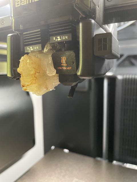

    I just succeeded in removing the part located at the right by heating the right extruder, but damaged the small filament cutting device (last picture joined)
I asked several times to change the whole extrusion block under warranty, but the support doesn’t agree
To conclude, I own an expensive, disfunctional 3D printer, with a support team that tries to avoid recognizing the problem.
Could you suggest a way to resolve my problem ?
Thanks
The support suggestion is spot on… you need to heat up that blob and carefully pull at it or use flush cutters to dig into it. The problem is its nylon and will require much higher temp than 80c that the hair dryer can do. You need to heat it up without melting the other parts of the tool head, which will be a tightrope walk. Maybe something like a soldering iron or a heat gun with smallest nozzle might work.
Also as a side note that filament is Nylon (PA12) without fiber additives. Nylons without a fiber filler (GF/CF) are notoriously hard to print, and likely that was part of the reason the blob happened in the first place. If you will try to print that filament again I strongly suggest using nano polymer adhesive on the plate to prevent it coming off. The issue was caused due to the print warping and letting go of the plate and getting stuck to the nozzle. I personally stay away from fiber-less nylons.

IIRC that small thing you damaged isn’t the cutter, but the nozzle cap, and other people have mentioned that their H2D box shipped with extras.

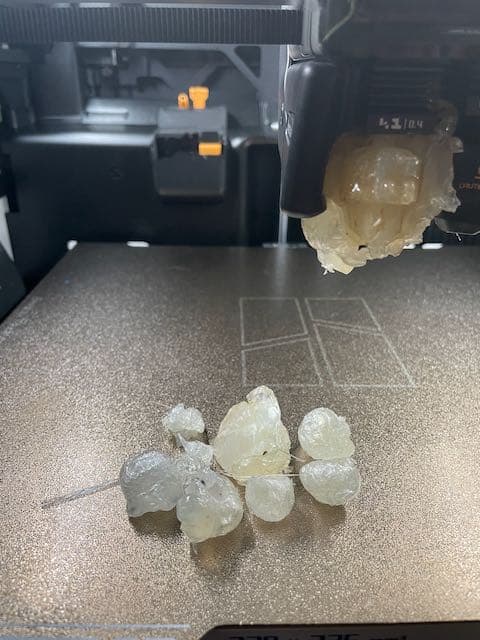

No, I succeeded in cleaning the right hotend, but the left hotend is always mainly covered by melted filament. Once more, the support doesn’t answer when I ask for removing the extruder block. I know that I can find a tutorial on the wiki. But that’s not support.
