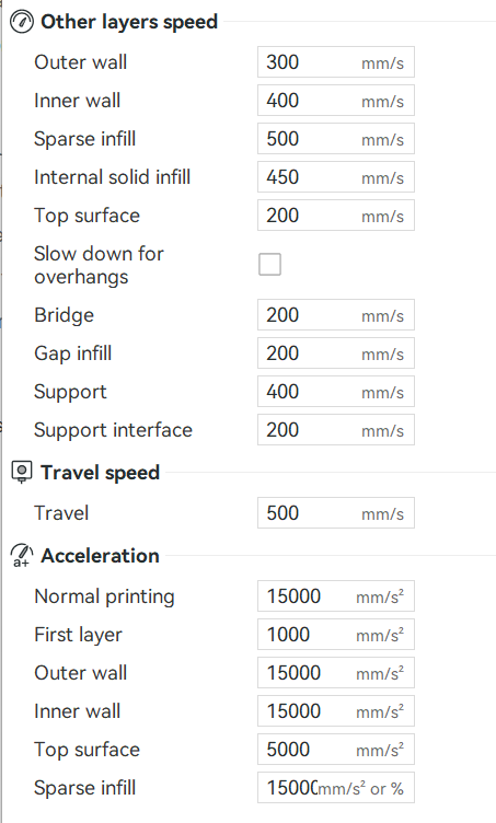

Well, 500mm/s and 20K acceleration is a bit different from the default. Just because the machine can move that fast doesn’t mean you should use it. There a reason why the “Standard” is the default.

Not 500mm/s but near, this is my default settings :
CHT 0.6 nozzle, 0.1mm layer height + Jerk X/Y set to 10
No printing issues using Esun PLA+
Ya I’ve looked around, I’ve seen that easily on layers other than the first, can’t say I’ve seen anyone else do it with the first layer though. I was curious about the K1 hehe, that would be just for a test though!
