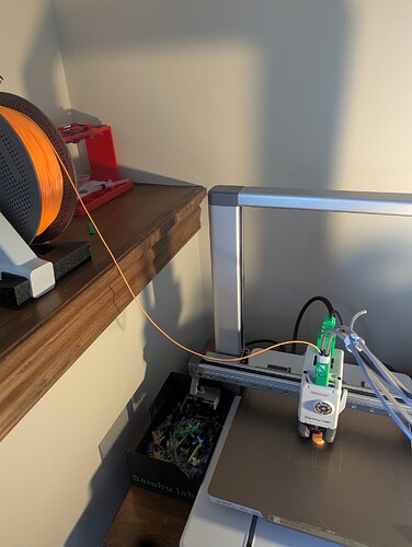

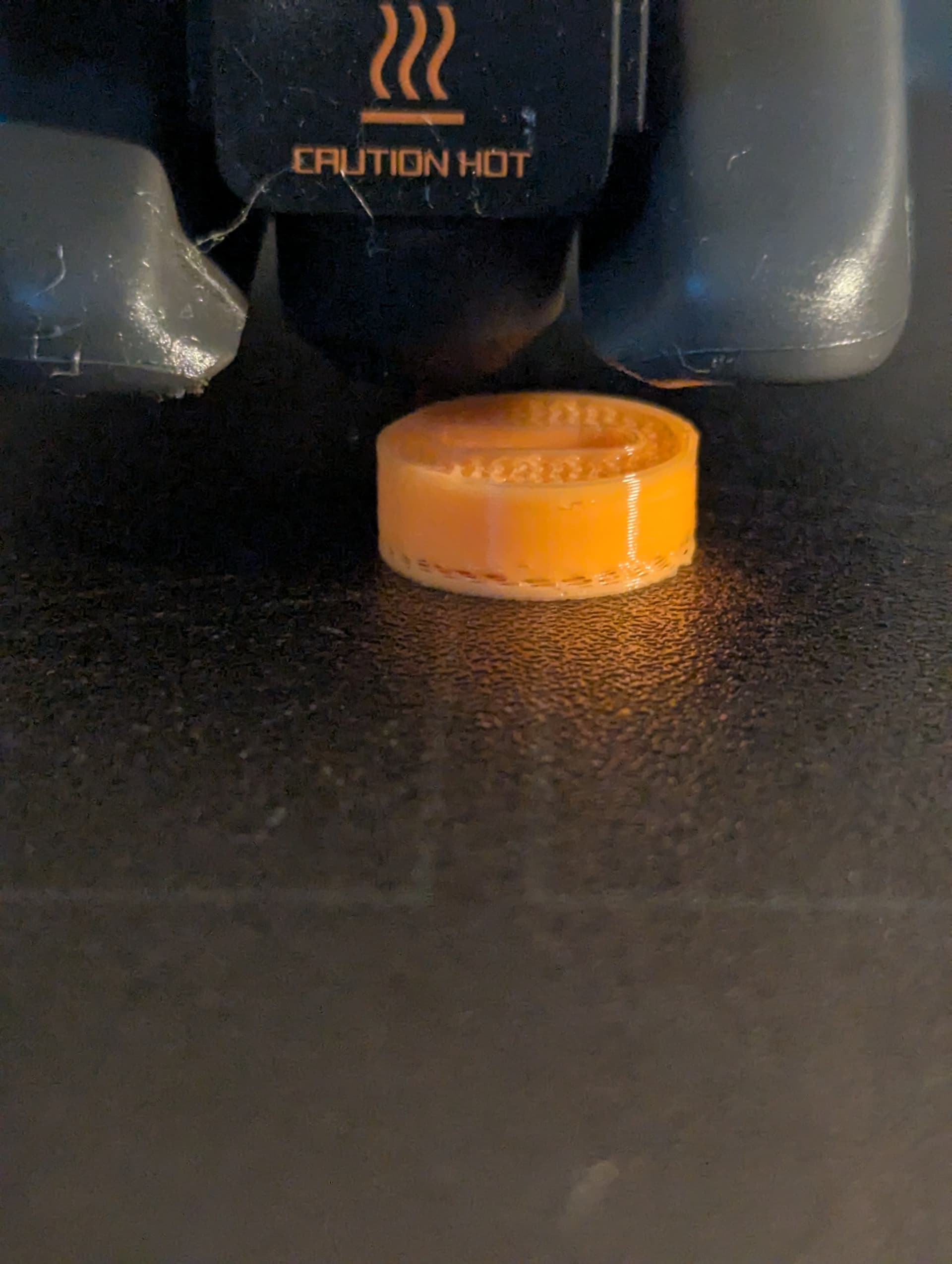

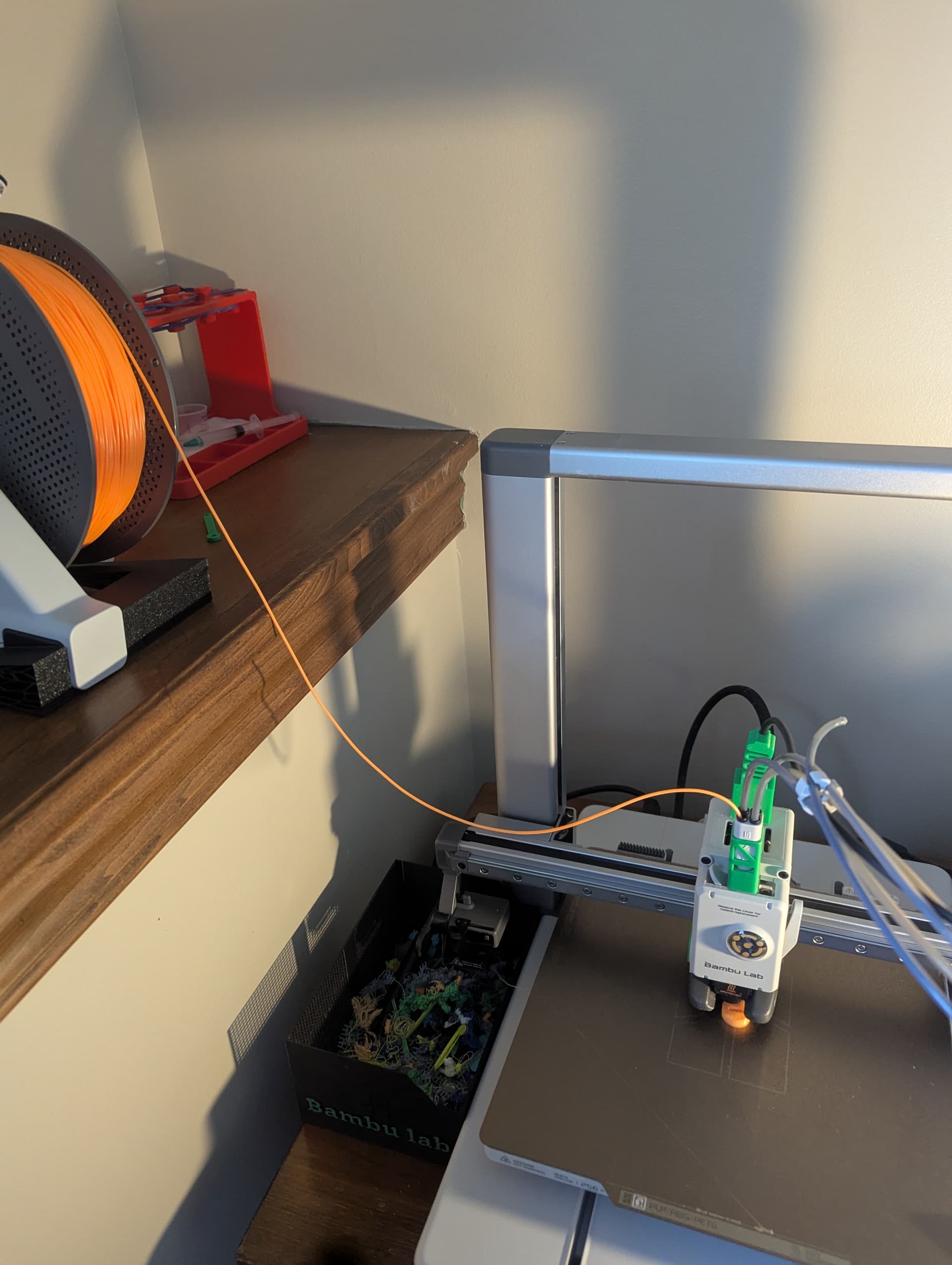

I know I’m late but I made a large discovery, all I did was remove the ptfe tube and let it hang down and changed the temp for 225c to 235c and it drastically changed the print.
Some pics included, the bad looking part on the print was run at 225c and the rest was at 235c
