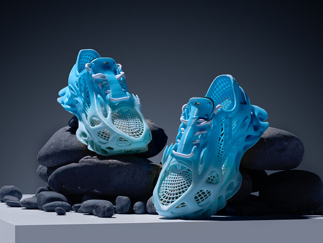

So I’m printing a pair of Whaleberries (3D printed shoes) which have a 5 day printing time on my stock 0.4 nozzles. I’ve heard people say using 0.6 nozzle is preferable with TPU. I was curious if anyone had any experience with this. Also curious if anybody has used the high flow nozzles. I just ordered a pair… (the 0.6 are sold out until June so not an option at this point)

So I sliced the model with three different nozzle sizes. This was unexpected. I guess it must relate to TPU’s slow printing speed. I guess…
Nozzle Layer Height Time
days hous minutes
0.4 0.2 4 9 6
0.4 HF 0.2 4 9 1
0.6 0.3 4 23 59
