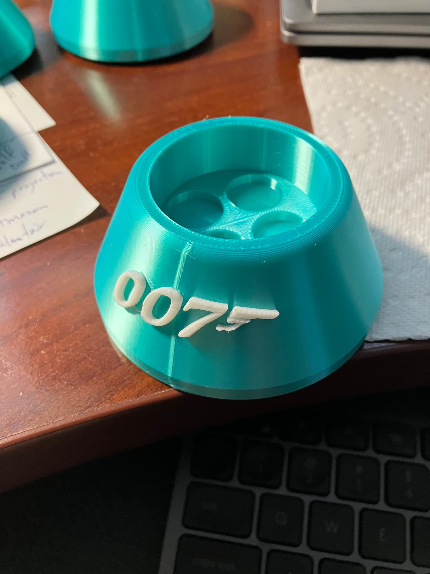

Recently I’ve noticed my prints which have a curved vertical surface now have a seam (see attached pic). Any ideas on how to prevent the seam from showing?

I never assigned or asked it to print a seam. Where do I make this change in Bambu Studio?
Ignore my previous post… I now see that I am unable to avoid the seam but now can control where it is located.
Forgot to mention, the only options I had for the location of the seam was Nearest, Aligned, Back and Random. Did not see an option for Inside.

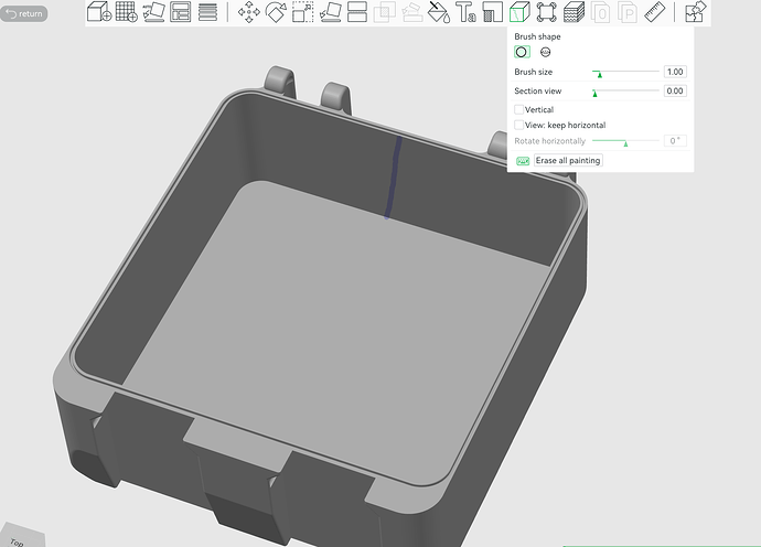

Use the seam painting feature
Ahhh ok, wasn’t aware of that, thanks!

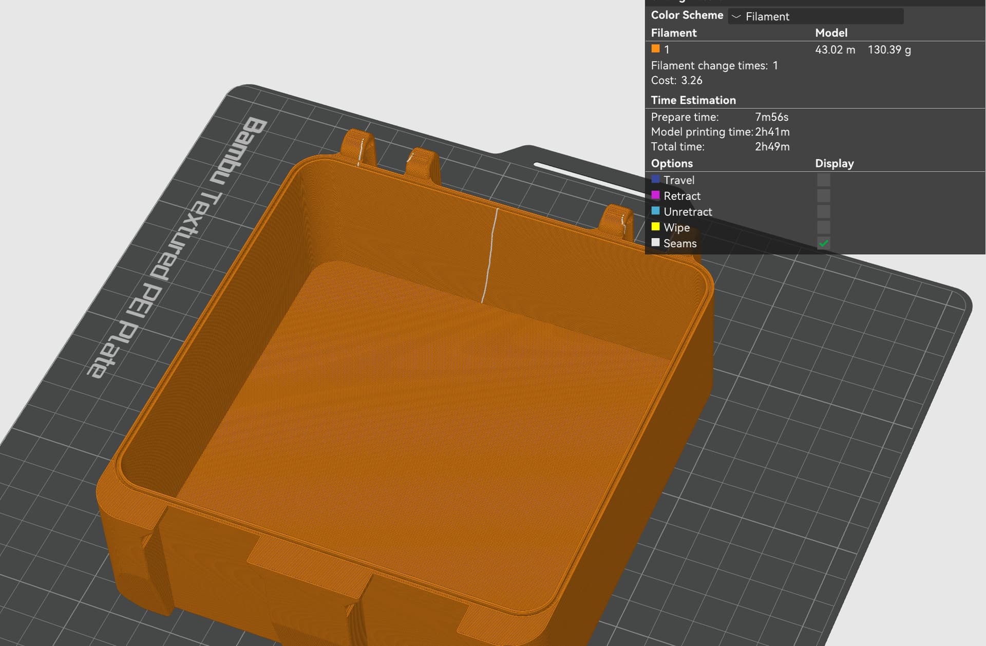

You can also play with scarf seams which have a less defined line.
You can place the seam elsewhere, but you can’t not have a seam on the outer surface: the line goes around that surface and will necessarily have to start and stop somewhere..

You told OP he should put the seam on the inside. You just can’t do that; I’m pointing it out in a normal and polite manner..
Maybe you ment the back; but you said the inside.
Understood… I plan to move the seam to the back, so it is out of sight.

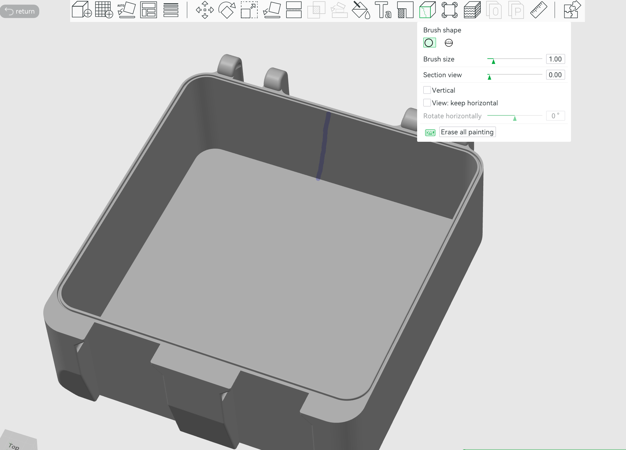

You can put the seam on the inside. Hence I added pictures from studio.

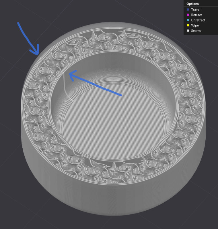

I keep trying to figure this out thinking Im missing something. your pic shows the seam on the outside. Its inside the box, but not inside the last wall, that only works with a hollow object ? you cant put the seam on the inside of the outside wall on a solid object can you?
As I’m not sure everyone is on the same page here: An object like a bowl with some thickness have an outer and an inner wall (print sequence wise). Both of these will have a seam as the print head have to start and stop somewhere..
(We’ll try to have these at the least visible place)
