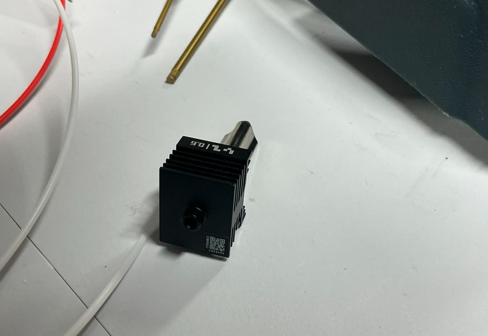

Do you’all have any pro tips to avoid CF and GF infused filaments from breaking off or clogging nozzles?
I’ve had to unclog two nozzles now, super glad I have backups but I’m running the .6 as recommended…however it seems like when I stop printing with say ABS GF, everything goes fine and then come back the next day to do a new print.
The filament will retract fine but as I print with petg or something, click click click. Extruder error, then I replace the hot end and boom everything works…then I get to heat up hex tool and focus on making sure I don’t burn myself on anything hot while pulling out a small segment of the infused filament.
It’s a barrier that can be overcome, but it’s getting old.
