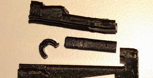

Problem to choose a filament for electrical connector

That lever is oriented in the worst possible way for strength
Rotate that 90 or 45 degrees on the plate so that the Z layers do not run up that thin stalk. Deal with any other overhangs as they come via supports, that original orientation will fail

PC FR is the best choice that you already have.
The problem is that you are treating it as if it a direct copy. You have to modify the clip design so it is more friendly to print.

Thanks, I try if tilting makes it better.
Only thing what that connector / wires do, it lits a light in dash, all systems are still go. And when the light lits, there’s still a lots of brake fluid. No problems, everybody are safe, me and others.
Propably I have to modify it a bit stiffer and do different kind of spring clip for it.

Why have you not tried plain PETG? So far you’ve chosen only overly rigid materials.
My first thought was also PETG. There might be a concern with underhood temps going beyond the PETG range for melting though. But PETG does have more give than most other filaments. Just do not use CF/GF versions.
Another option might be TPU for AMS. I think it is about 68D in hardness. It is able to flex without breaking but still has a harness to it that is closer to PETG than 95A TPU. I am not sure what the melting point is for it so check to make sure engine heat will not turn it into a pile of melted plastic.
Although it does get hot near the engine inself, automotve engine bays intentionally have considerable airflow and altough that air is quite warm, near the firewall (where master cylinders are generally located) it should be cool enough for PETG.
Thanks everyone, I’ll also try PETG.
