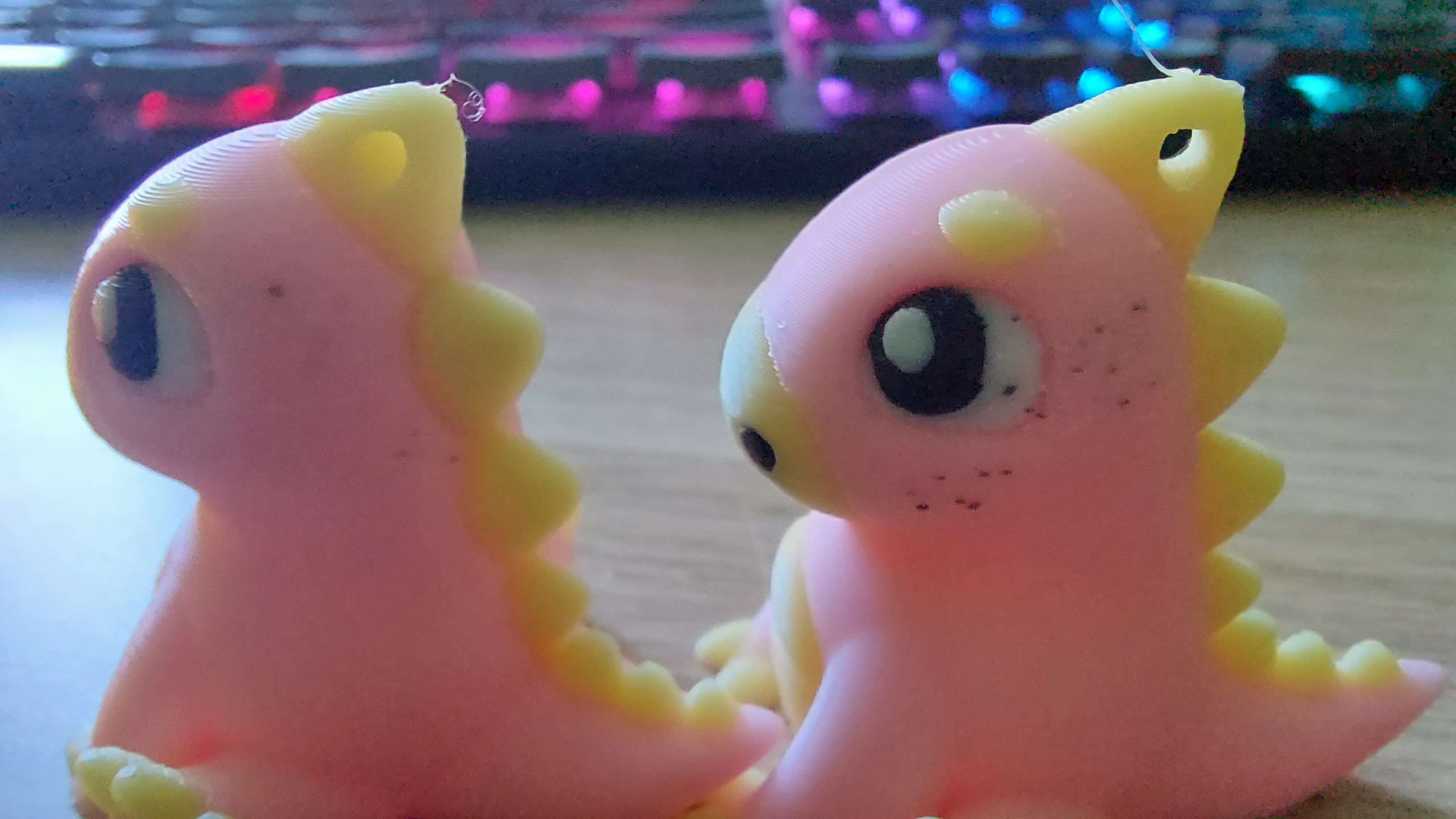

When printing full plate of multicolored prints my figruines have black dots and something that would like miscolored additional seam:
I have A1 Mini with AMS lite, I am using SUNLU PLA+ filaments
For slicer settings I use slightly modifed “0.12mm High Quality” profile
The important change that could be useful is that I have turned off Z-hop by setting Z Hop when retract to 0 (Which is related to my previous problem with quality of prints which is described in other post: Z Banding/wobble problems )
3MF file download: Dino with flush object and reduce infill retractions
One possible cause might be slight overextrusion so the hot nozzle picks up the excess material which then sticks to the print and leave those blobs.
