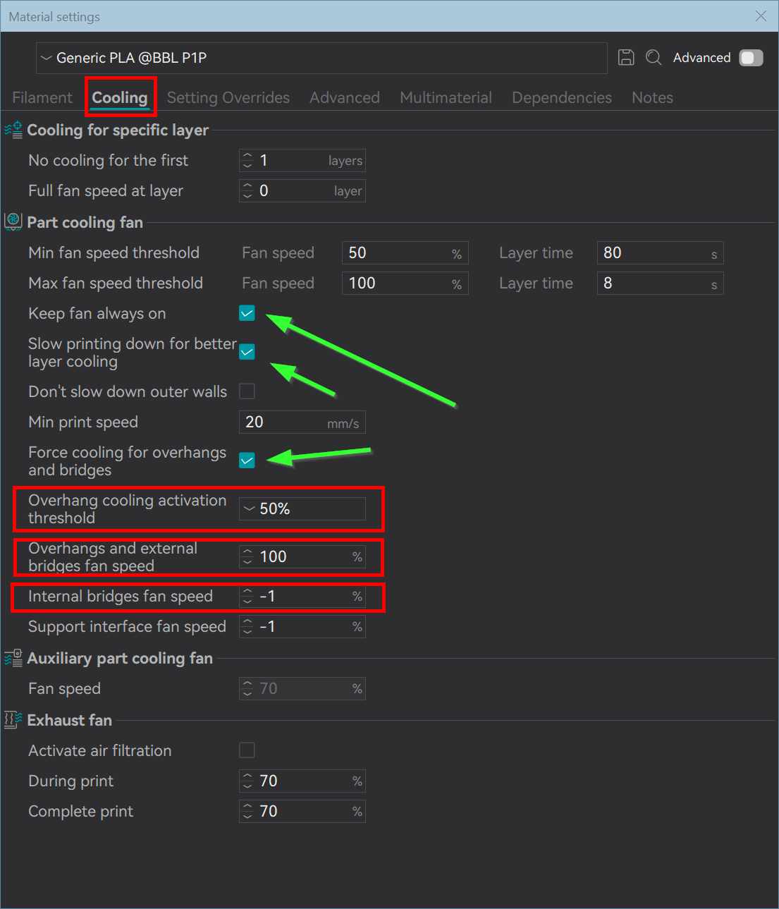

PHYSICALLY check the fan on the print head. The sensor in the P1 is not the best, and it cannot reliably detect a fan problem. I have had cases where the print head is knocked, causing the fan connector to come out, and it just doesn’t know.
What it looks like is happening in insufficient cooling to solidify the plastic on overhangs.
The fan is running. I checked for obstructions and didn’t see any. I can’t tell if it is properly changing speed though.
Olias - My global settings are identical to your as well as the cooling settings.
Without changing anything, I printed the overhang test and the problem starts at right about 50% as seen in the first picture.
The second picture is odd to me, the circled area shows that it starts printing the overhang correctly, then it droops until the next layer, starts correct then droops again. At right about 70% it completely fails on every layer.
I have an unrelated print that will be done in a few hours then I can start tweaking settings. Even if the tweaks work, I’m baffled as to why the defaults stopped working.
UPDATE - Looking at the slicer drop-down, it is showing that the fan speed is to remain constant throughout, but the Speed and Volumetric Flow both increase abruptly at 50%. See 3rd picture.
I think you’ve done a thorough job narrowing down that it’s not a software setting. Thanks for posting the TEMP screengrab—it takes a lot of guesswork out.
I didn’t see you mention whether these results are duplicated with other filaments, but assuming this happens with other filaments, it may be time to consider potential hardware problems leading to false temp readings.
You’ll want to remove the silicone sock and clear any embedded hardened filament, as that can sometimes throw off the temp readings. One experiment, if you haven’t already tried it, is to raise the nozzle temp to 280°C or higher to see if it changes the outcome. If it does, then temperature is likely the culprit again.
If temp is an issue, the easiest thing is to reseat the connectors inside the tool head just to ensure that there’s good contact. If that doesn’t work and the software settings did not work, if you have a spear Hotend lying around, try that and see if you get different results. If you don’t have one lying around, it’s probably a good idea to get one. Go for the full assembly, trust me, it’s worth the extra few buck to not have to assemble the wires and/or thermistor and ceramic heater. At least you’ll know it was assembled at the factory.
