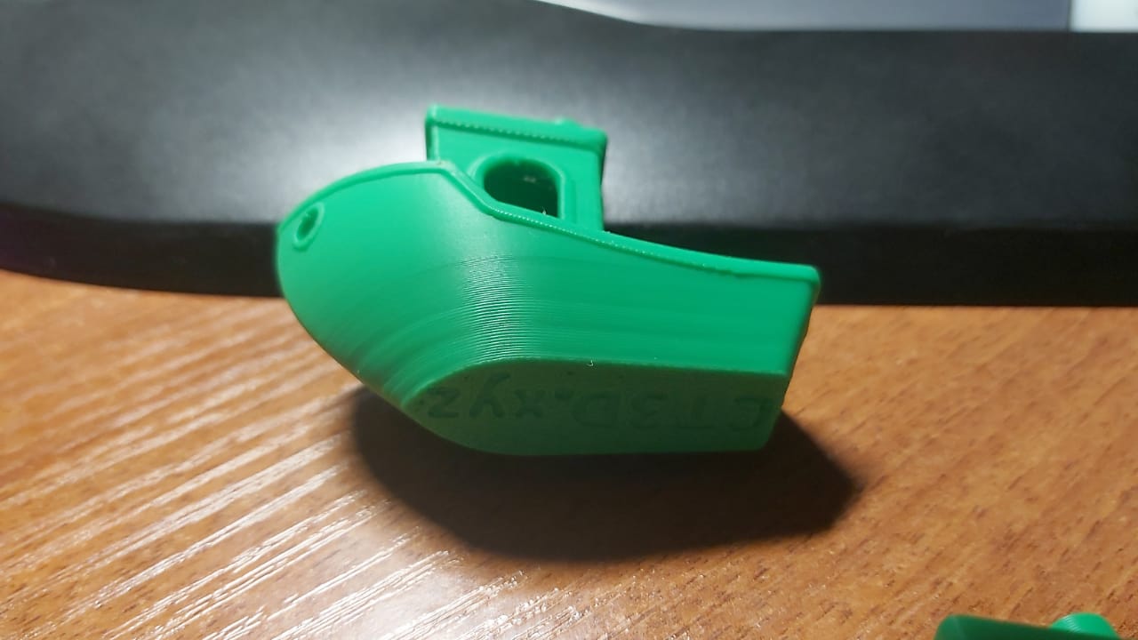

I am a newbie and recently bought a P1S. I bought several filaments of different brands. Started printing…
The P1S prints, but I encountered the first problems.

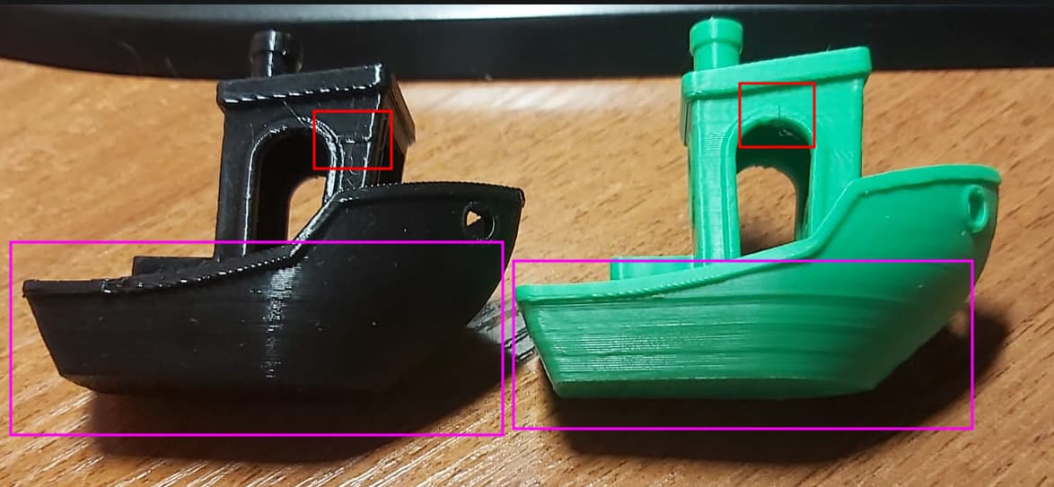

Green is Bambu PLA (out of the box). Black is PETG (not Bambu).
There are problems in both prints. PLA looks more problematic, and PETG less.
The settings are default. I just calibrated the printer (I do not use printed calibration parts by any users, only through BS->Device->Calibration).
Questions:
  1. I thought Bambu filament has settings in BS. And printing with Bambu filament should be good. But I see problems. Is it normal or not?
  2. How can I solve these problems?
  3. Is this a hardware problem or not? I hope this is not a hardware problem and I will not have to return the printer to the workshop.
TIA

I agree that the green benchy quality isn’t acceptable.
Before any other troubleshooting, please confirm that the filament is dry. If not, dry it and retake the test.
Note that minor imperfections can also be addressed, but may require further tuning of the settings and calibration. The benchy, after all, is intended to show what is still to be improved.

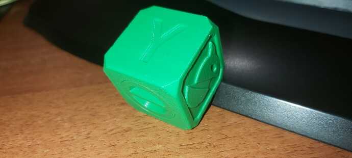

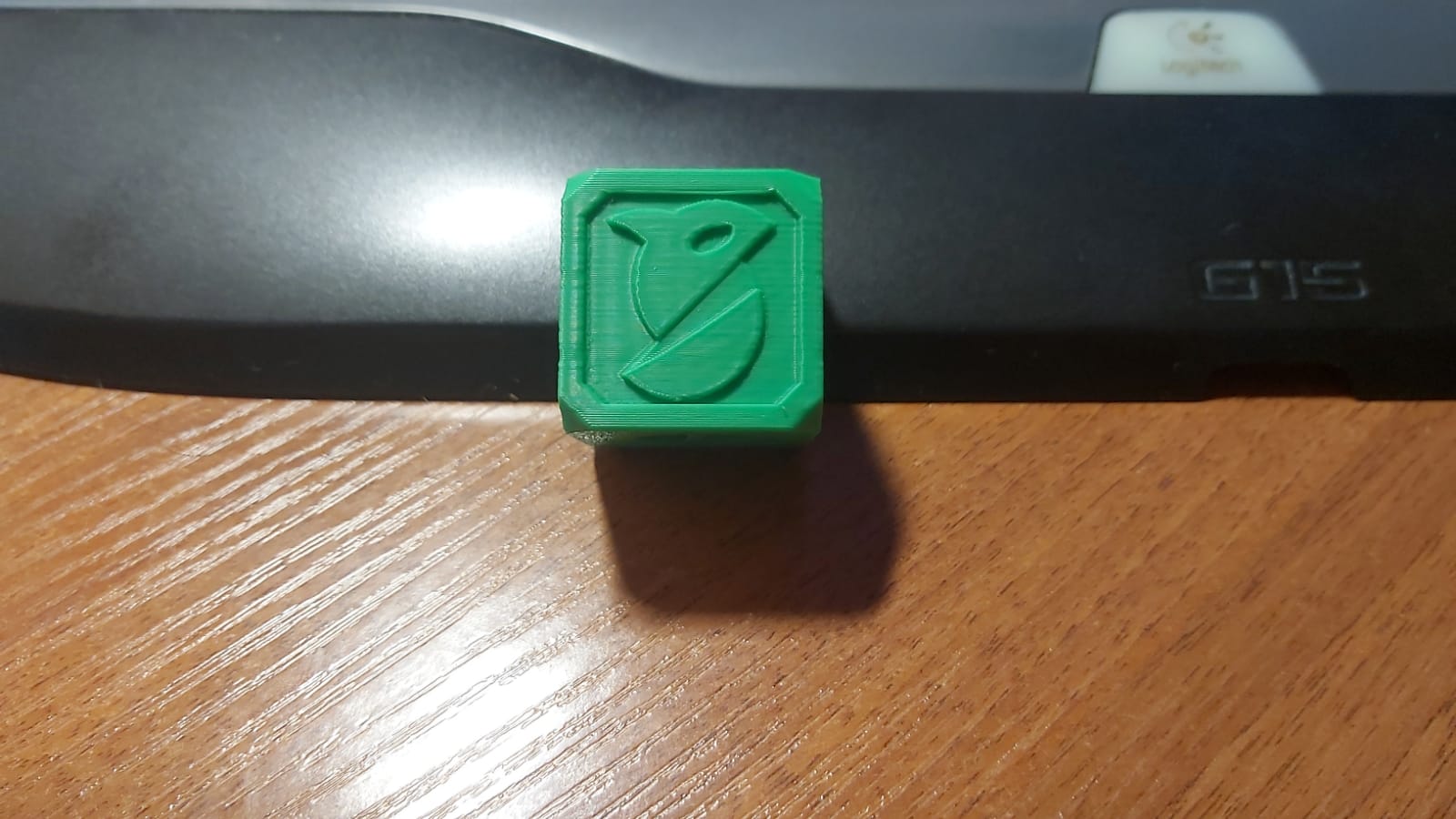

The cube is better, but not perfect.
What settings are you using, it is very important to use Bambu Studio preset settings for Bambu filament when using it and for other brands when using their filaments. Also make your settings are for the filament you are printing with, PETG and PLA have totally different properties, including melting temp, adhesion, and recommended cooling. Thus you should use the appropriate presets for your brand and type of filament.

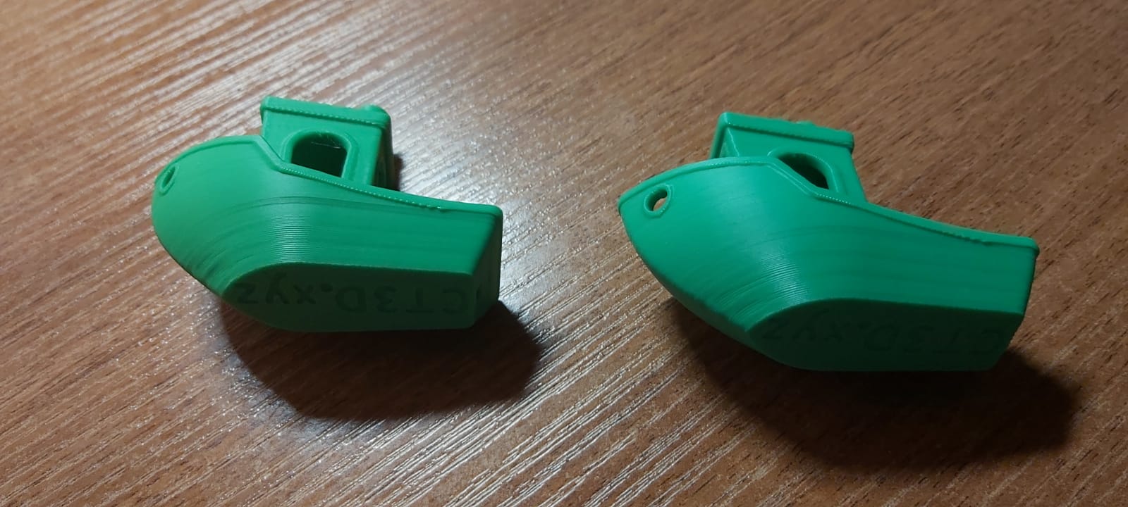

@JayZay, yesterday I dried Bambu PLA (26%RH minimum). Is more better but not perfect. Left - wet. Right - dry.
It seems I need some calibration Flow Dynamics Calibration and/or Flow Rate.

I’m worried something wrong with hardware because the same problem on both model with different filaments.
I’ve seen a couple issues with recent batches of A1’s with the nozzle mounting screws be a bit loose, in one example the nozzle dug itself into the bed. This is a different printer model but it’s a thought. Based on the warping it’s worth double checking the screws that hold the nozzle and gears , might also double check the gears for any debris. I had an intermittent issue with my second P1s when I got it. Sometimes it would just spit out bits of plastic rather than extrude properly. I’d get about 2-3 cm high of print and the print would start to look like a sponge. Pull the filament out, check it for breaks and put it back in and it would do the same thing. A weird partial filament jam. Turns out a tiny piece of filament had broken off presumably during factory testing. Took the extruder apart and there it was a little piece of orange. Mind you I didn’t even own orange filament at the time.

It’s 42% humidity in the AMS. That’s your problem. It’s so humid in the AMS that your filament is absorbing the humidity and getting wet. This is causing poor layer adhesion. I would dry your filament before every print, or I would do something to lower the humidity in the AMS
