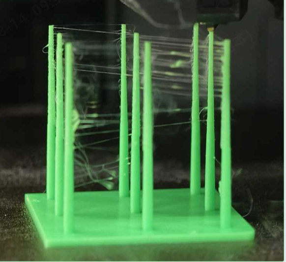

Anycubic’s support team suddenly stopped responding - they were very specific about promising 1 month of “support”… Unfortunately, it didn’t help, and even Anycubic hasn’t been able to deliver the same results as with the Bambu filament I used.
See the attached example with green filament that their product team sent me:

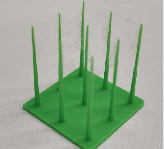

I’m now getting reasonably “ok” results with the following filament profile:

In general - I had better results with the following settings in Bambu Lab:
Avoid crossing wall: activated
Avoid crossing wall - Max detour length: 0 mm
When printing multiple objects on the print plate, I also activate the following settings in the object settings:
Special mode - Print sequence: By object

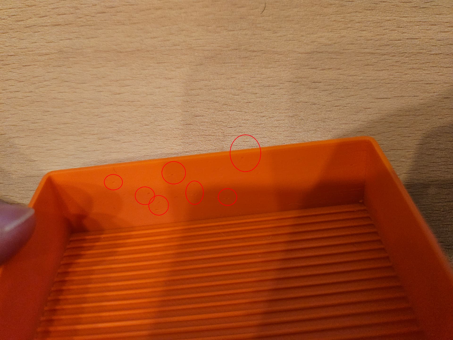

The only problem I still have are small holes, which I can’t explain yet.
I checked the slicer here, and interestingly, there is no rapid traverse, retraction, or feed at this point.
The only explanation I can think of is that the filament may be uneven in thickness, but I haven’t checked that yet.
However, it is extremely illogical that there is a hole in the middle of a printed line. (The filament was thoroughly dried.)
If anyone with more experience could give me a tip, I would be grateful.
See photo:
Best regards,
Andreas
I know its frustrating to hear but those little holes are either a z-seam set to random, or moisture. Little pockets of steam form deeper inside the nozzle as it crosses the 100C mark, expand rapidly, and escape by blowing out the side of the line currently being printed. Measure your spool to 0.1g accuracy, dry it, then weigh it again.
