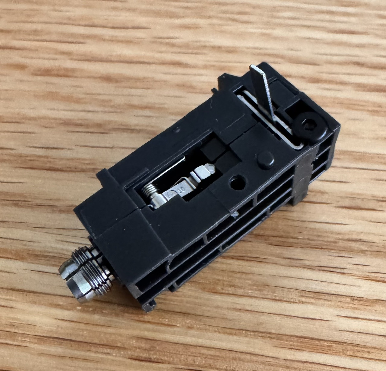

Bambu support kindly supplied a new fillament senor block and a rights nozzle heater unit. I managed to reassemble the head, (on a side note, follow the Bambu disassembly/assembly videos exactly, order of assembly is important). I now have a fully functional tool head on the X2d and all test and calibrations passed.

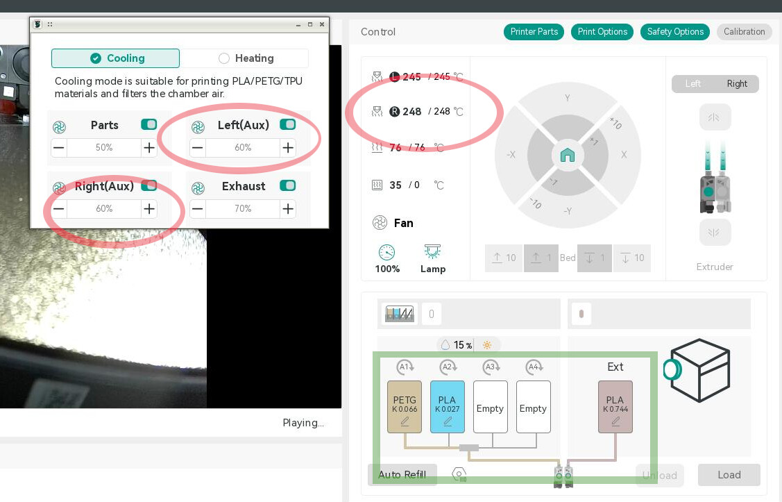

Issue 1 (See image1)
  1. When the print starts on PetG, the right nozzle temperature is set to 248 - the max printing temp of PETG, not PLA. For some reason, the right nozzle is assuming the temperature of the PETG.
  2. Auxiliary fans are on 60% and parts on 50%. As far as I configured, the Auxiliary fans should be lower or even off.
I can so no reason to keep PLA nozzle temp or a loaded nozzle at 248. Especially with a longer print, this will cook the PLA in the right nozzle for a long period of time. This situation is what i think damaged the right nozzle. This probably should be kept warm (140?) until the system runs a quick flush at the point of using it. The last sensor block was filled with burnt PLA and could not be cleaned and required replacement.

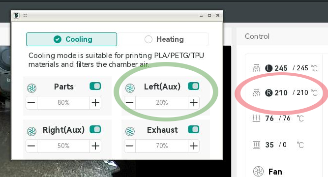

Issue 2:
This is as the point the right nozzle was printings its first layer support structure, after the wipe tower.
  1. The left auxiliary fan is the 20%, lower than the PETG print, but as I set it via the filament profile. However the right auxiliary fan is at 50%, no sure how that gets there, however it may have something to do with chamber temperature control.
  2. The PAL nozzle temperature is now at 210, not at 220 as set in the filament profile.
Issue 3:
Back to printing PETG:
The left Auxillary fan appears to be where it has been configured. The right fan, doing its own thing, again possibly for chamber temperature control.
The right nozzle temperature is now stuck at 210, why? It should be at 220 while printing. It remains at 210 for the remainder of the print, well after the interface layers have been completed. It seems the heater should be shut of at this stage.

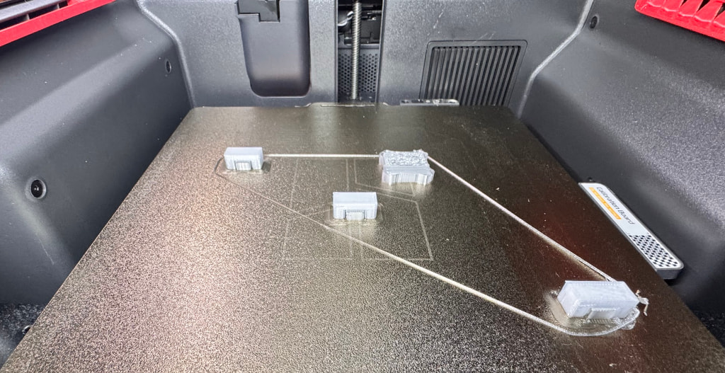

Finally, here are a series of small test blocks printed as a result of the above settings.
The bottom right is block is scrappy, possibly due to adhesion issue, as I do touch the build plate around that area. I have the air baffles in places.
I will see if they work on a large model.
