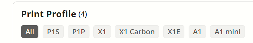

New P1S machine and bambu studio shows x1c under the process tab and I can’t see to find a way to change it.
Not really sure how important it is but tonight I was downloading and printing a makerword project. When I imported it suddenly the process changed to a A1 machine.

BBL treats X1C and P1S/P1P the same. Because they are built with the same chassis, motion system, liear bearing and all.
When you download from MW, the printer profile, filament profile in that 3mf project was set by the designer. You have to change back to your printer profile, filament profile before you slice and print. That is just how stupid it is for Windows PC users.
It sounds like what you are experiencing is a incorrect installation or too many printers selected when you first installed Bambu Studio. It’s a common error.
Here’s what you should check.
  1. In the drop down menu, click on “select/remove printers”
  2. Scroll through all the choices and make sure only the P1 is selected and that the X1 is NOT Selected. Clicking on this can take a few seconds for the list to build because it has a large database to load. Be patient.
Now the other thing that can be tricky is if you are downloading models from Makerworld. Make sure you are selecting the correct printer profile. If one does not exist(rare) for you printer, after downloading the model, manually change it.

appreciate the reply and the level of detail you provided with photos etc.
Unfortunately I went into the printer selection as you have shown and nothing is selected.
Not sure if I have to remove the printer and re add the printer but I have a feeling I even tried that previously.
