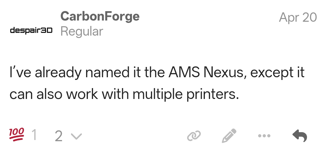

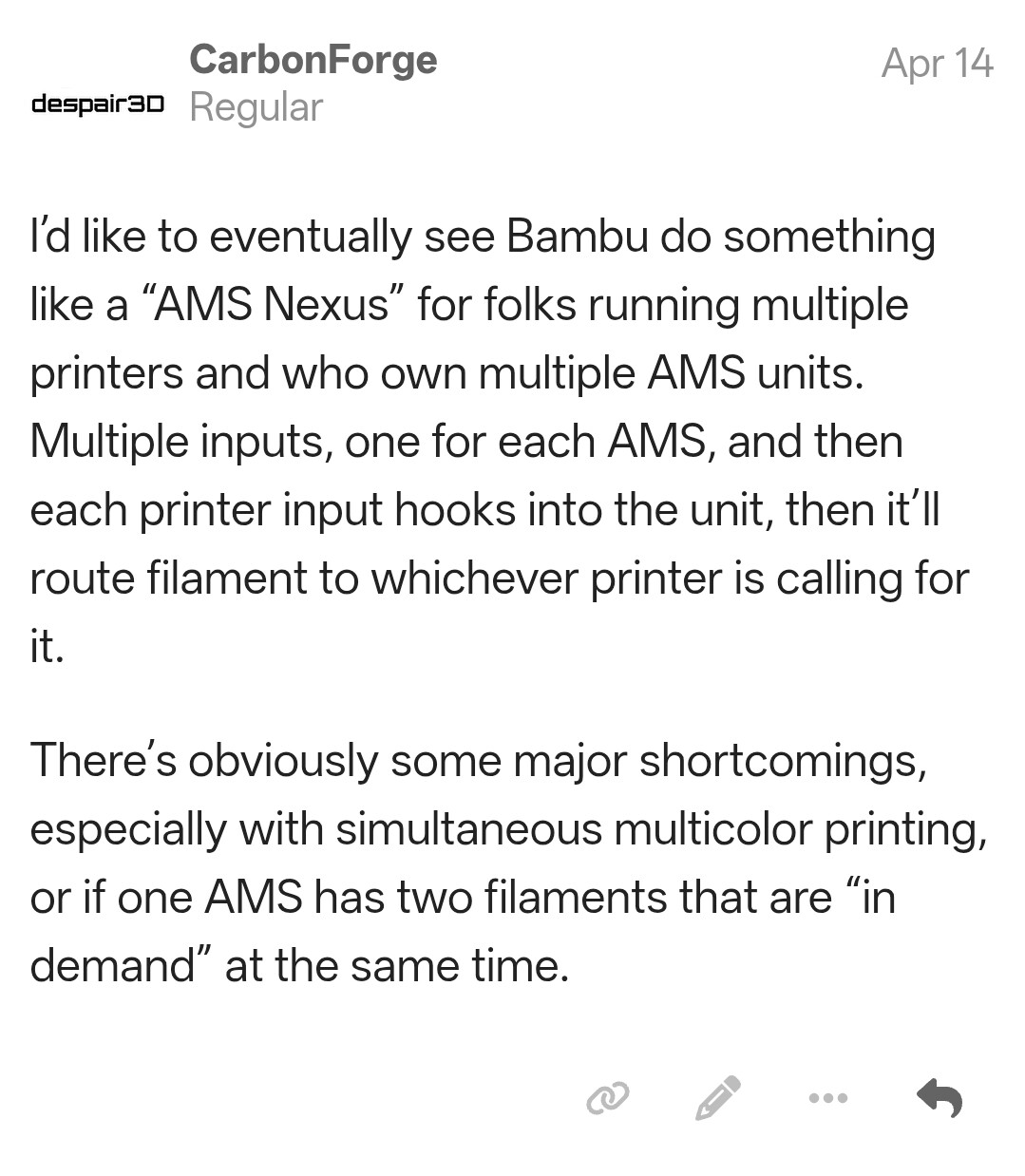

I think something like an β€œAMS Smart Hub” or β€œAMS Nexus” designed around filament parking, parallel AMS operation and predictive preloading would be a very useful addition to the Bambu ecosystem.
Now where have I heard that name before?
Well, it seemed like a fitting name for a device like this
