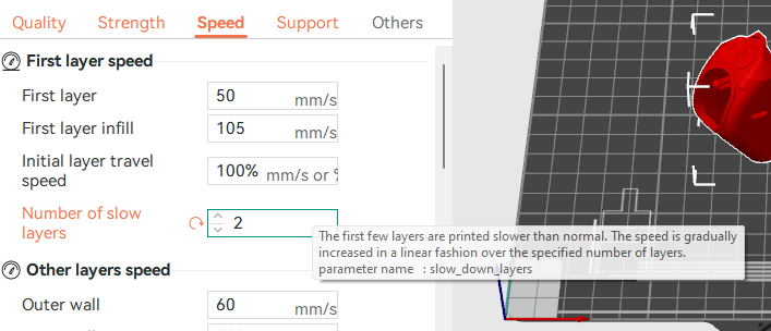

Progressive speed increase after the first layer
Greetings to all and thanks in advance to whoever can help me: is there a way to progressively increase the printing speed (and/or acceleration) after the first layer?
Now if I set the first layer at 75 mm/s and the others at 150, the maximum speed is already used starting from the second layer. I would like the maximum speed to be reached for example on the third layer, progressively increasing from 75 to 150. When I used Cura this option was present, but I don’t see it in Bambu Studio…
In Orca:
