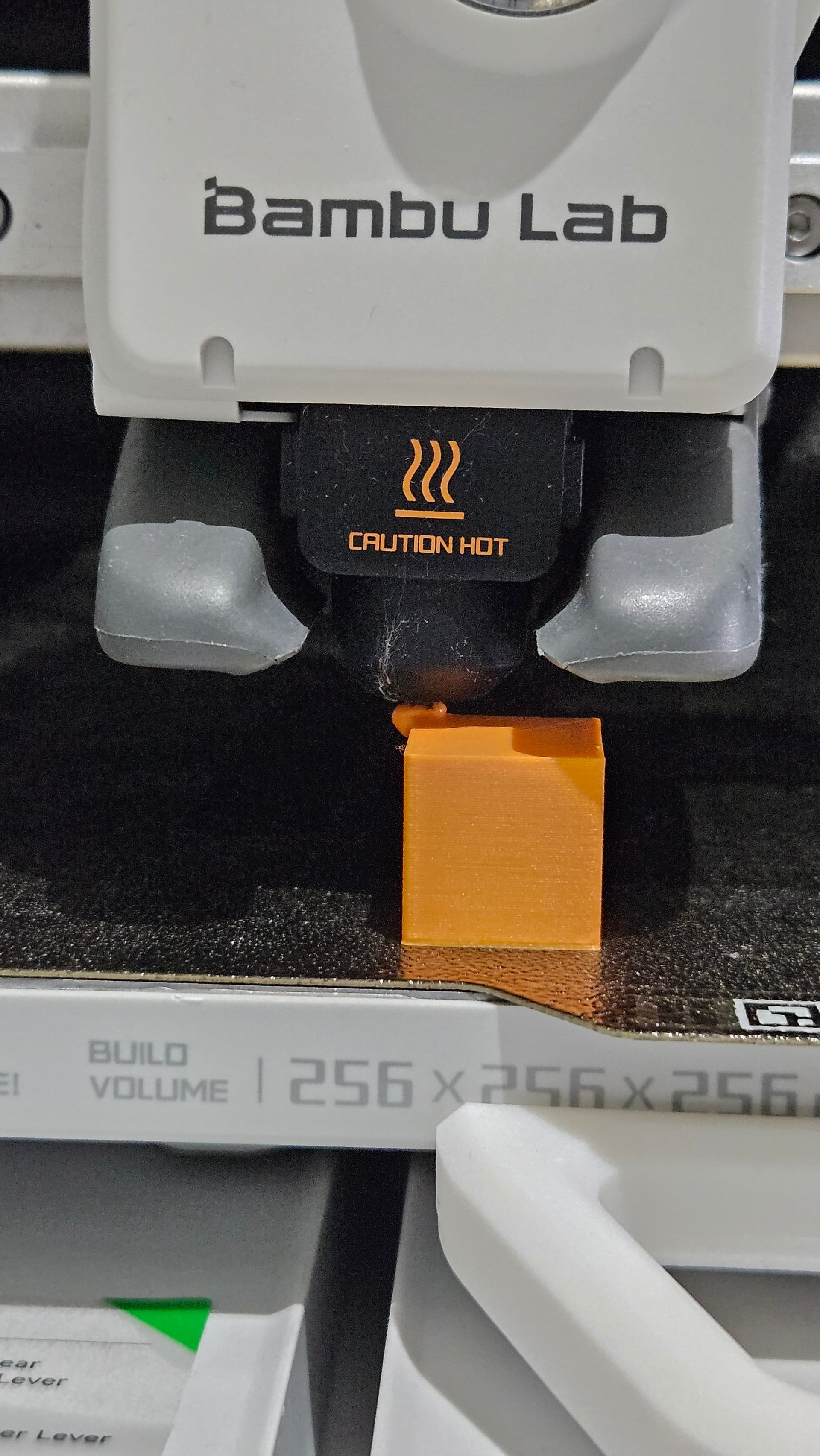

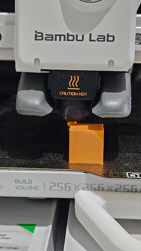

Thanks a lot for your amazing works! All the plates were printed and ejected parts successfully. I have a question that Is there any way we can change the hotends postion when it finished printing objects (back to the poop chute)?
As the picture shown below, the plate finished and the hotend stopped on top of the objects which had melting filament coming out from the hotend.
I saw a video on YouTube where a man edited the gcode to wait for the part to cool down then used the hot end to push it off of the plate
Not sure why your printer stays in this position after finishing. This is not a normal behavior. In regular case extruder moves up and to the left.
Please explain in detail your setup and step by step what have you done to achieve this result.

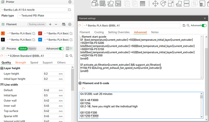

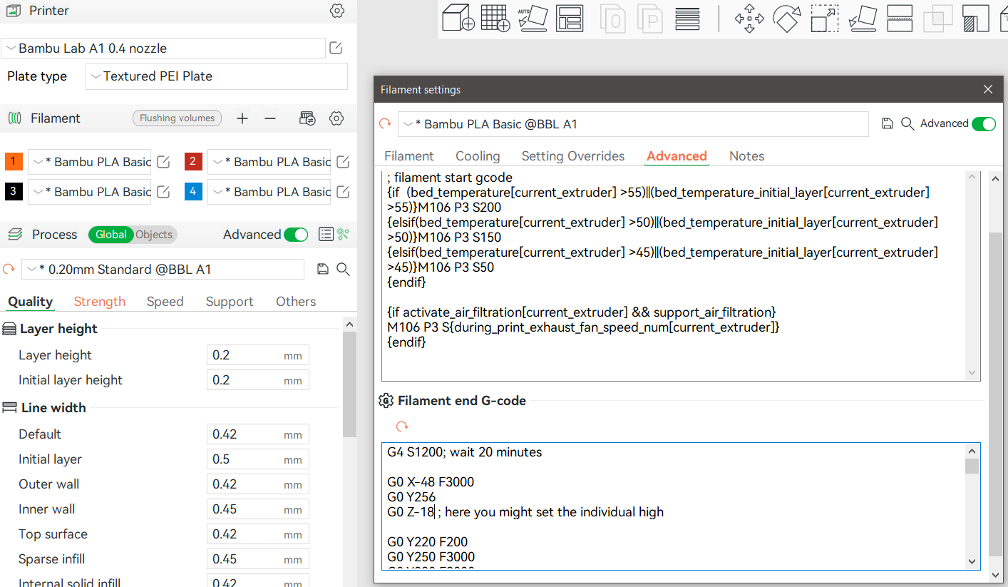

Firstly, I set up the filament end Gcode and then sliced all the plates to get the G-code file. After that, I used your mixer app to get a 3MF file with the same slicer I initially set up and followed your steps to get the final 3MF file.
I printed 2 plates and the parts were ejected successfully, but both of them had the same issue as the picture shown above.
Regarding the Filament end G-code, I copied and pasted the code you provided to the Filament settings.
This is probably the issue. The ejection gcode should be added into the END-GCODE section (AFTER the original gcode which is already there )
If you add it to the FILAMENT-end-GCODE it results in a long cooling interruption prior extruder’s final movement.
Thank you so much. I got it finally. It should be in the End-Gcode printer section. Everything came out nicely! Again, thanks a lot :smiley:
