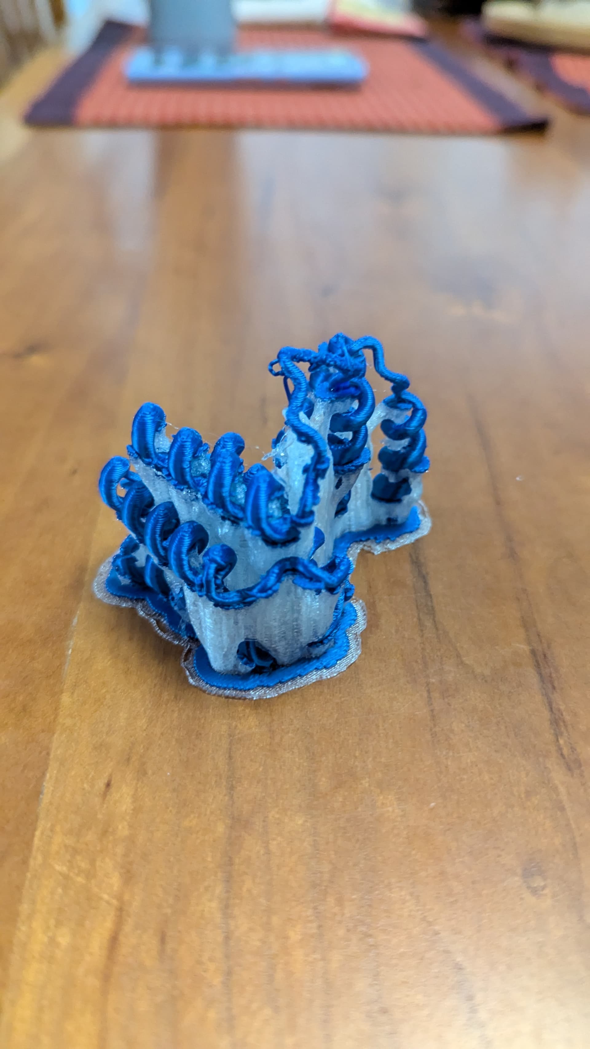

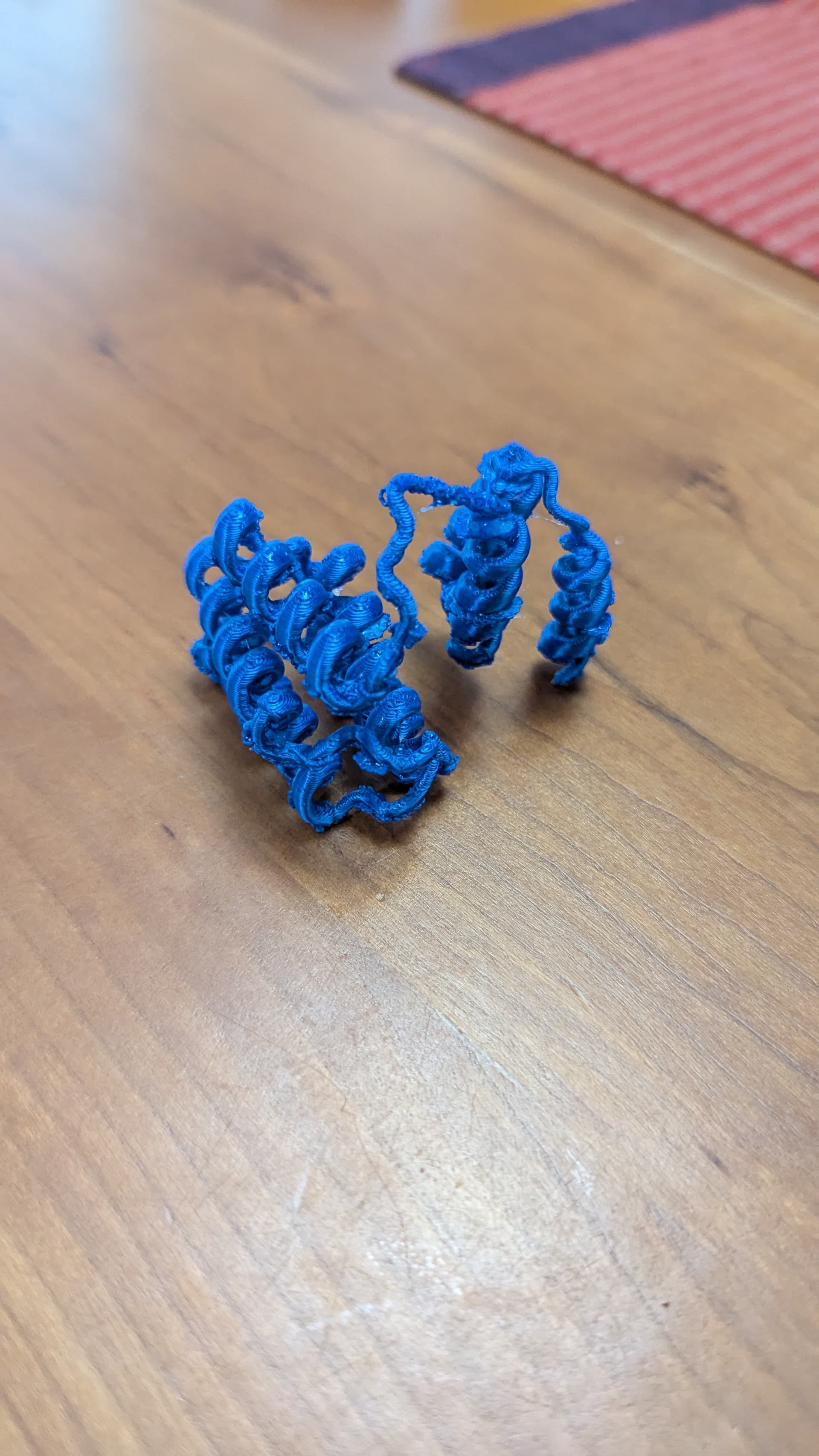

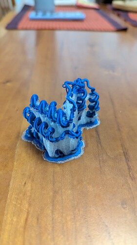

Hi, has anyone experience printing protein structure models or other intricate models requiring internal supports? I’ve had some partial success using PVA as support for PLA silk+ and my AMS, the challenges being getting The PVA and PLA to adhere well but then also the final model being sufficiently stiff or strong to not break easily. While the curls (called alpha helices) are sturdy, protein structures also have these loops.
What material other than PLA would you recommend in combination with PVA that also looks pretty afterwards?
Thanks for any suggestions and links to other posts that might be helpful.
