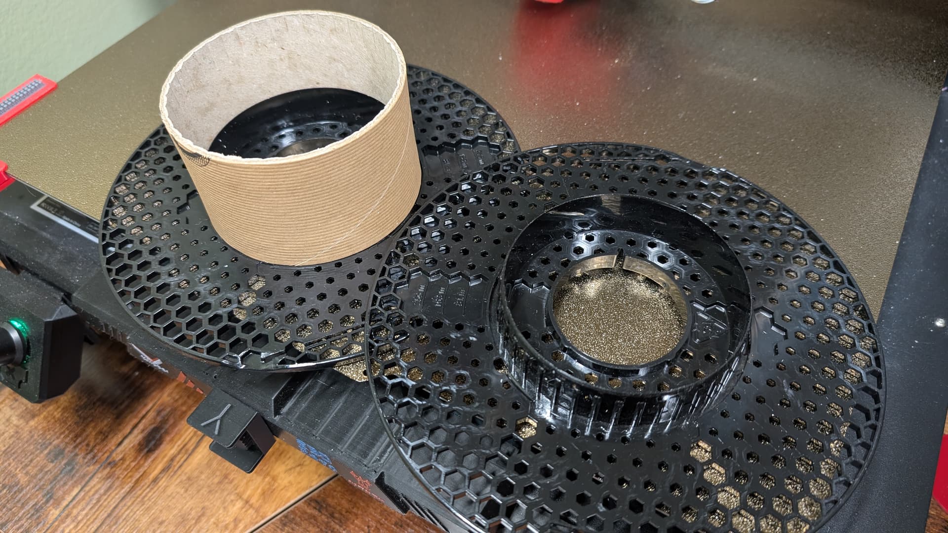

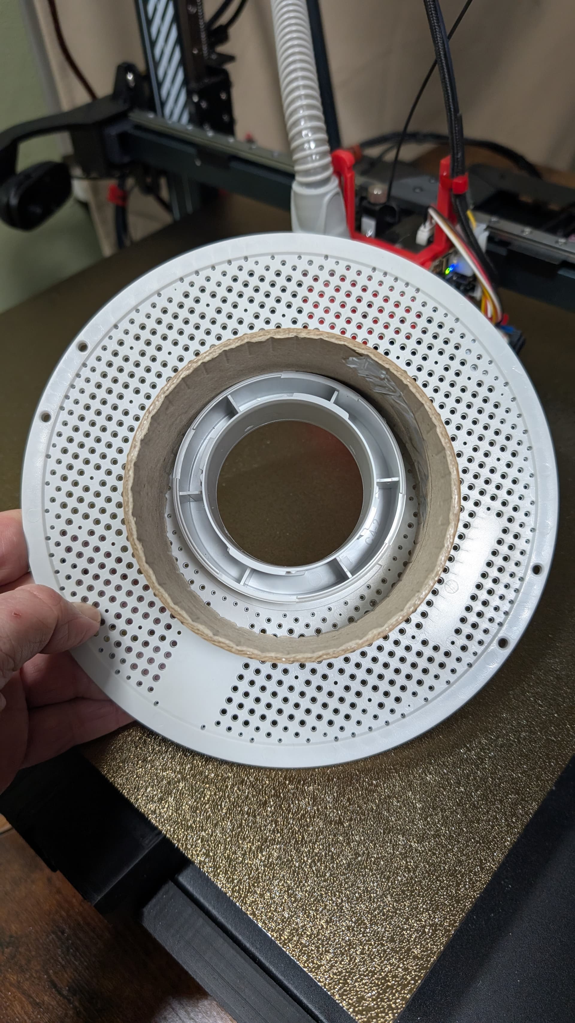

I’ll try to answer all your questions:
  1. The Prusament spools seem to be inconsistent due to the way they are made. They are two plastic sides pressed on to a cardboard center. When I read your post I tried two different spools, both 1KG Prusament PETG. One fit the AMS perfectly, the other was slightly wider and was too tight to turn when the AMS tried to pull in the filament. So if you ordered the PETG V0 it would be the luck of the draw if it would fit.

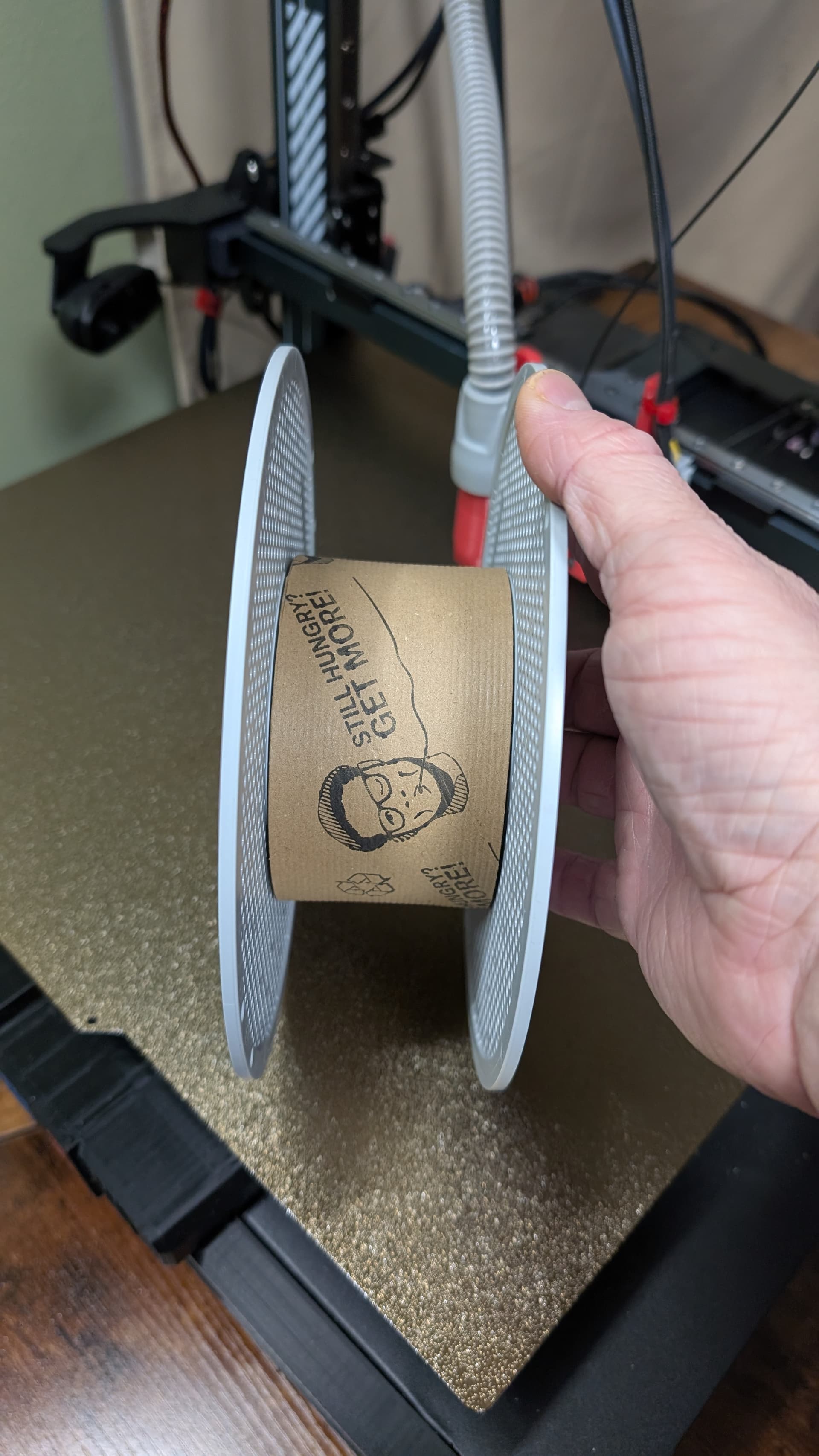

  2. The Prusa spool CAN be seperated. If you work your way around one side pulling slighly, eventually the plastic will come loose from the cardboard center. The width fits perfectly on a Bambu reusable spool. The circumfance is much larger than a Bambu refill.

re: Circumference - I make cardboard spacers for the Duramic, (corrugated cardboard works well), just needs to be approximately centered and balanced, so htat the cardboard does not rotate around the plastic.

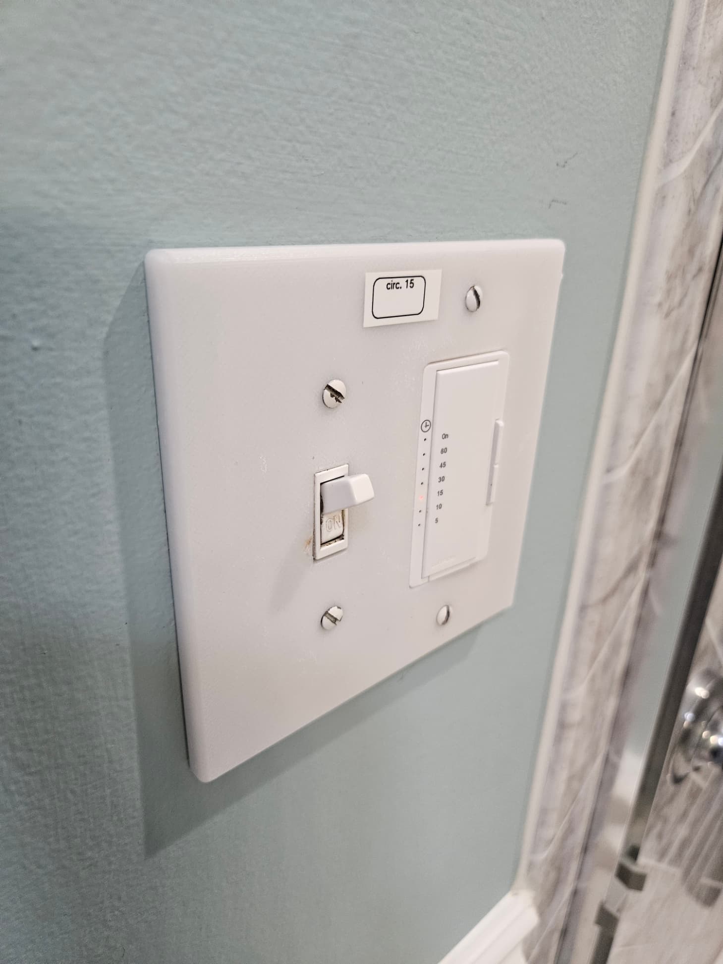

OK, got the PETG V0, Prusa. Printed out 5 electrical plates. AMAZING ! I found some settings in PRUSA for what to set the filament as. I made a custom filament setting, it is inside this bambu custom setting that i used to do the plate. other than s small defect in teh first layer, this did very well printing,and is very sturdy as a final print. TEXTURED PEI plate, as this stuff sticks to the Plate. But overall very satisfied with its print.
NOTE, this filament is slightly transparent for light; a cool white color, not a solid white. I can live with it as is, looks good.
